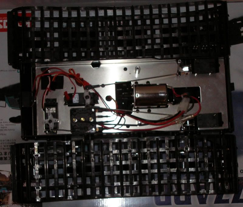

Thank you Andy. Yea it helps, guess I am going for a Lathe solution in the end, but I am going to test it with the original silver can first. The chassis came pre asembled, I picked it up yesterday. I will post some pic's when I have buildet it. My first impression is that the box looks nice. It also has some scale reference pic's to the real thing with a big blade mounted. Also is a web address there to the manufactor of the real DF-300. The chassis looks the same exept from the black wheels. First impression is very good, it looks like Kyosho is taking their job as recreational RC car builders serious again:-)

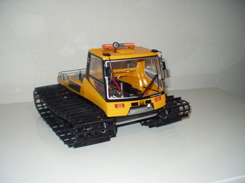

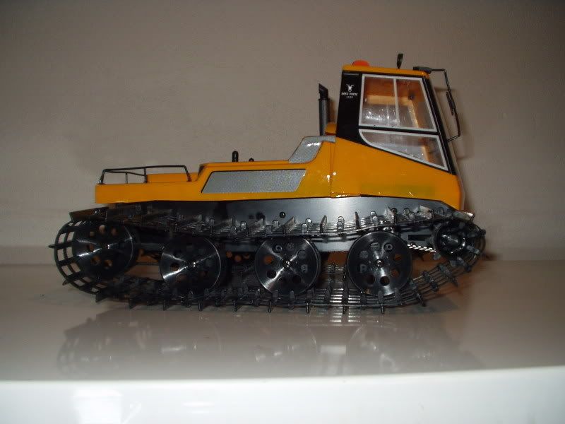

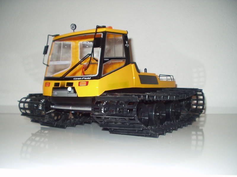

Here it is[<:o)]! Camel yellow turned out good I think, what do you think? Here are some dark pic's after a long and funny day of cutting, painting, decaling and some testing! I have been over at my buddy Cato's place witch has a very good basment workshop. He have built a TLT while I have done the body work on this[:D]
Guest joelvardy
mint focus can't wait to see it in action. *hint, hint*
thanks for the updates
Thank you joelvardy. It is not at all mint, but I am happy with the result. As you can see I have some small symentric faults on the front light decals. And also the decaling of the rear part of it became a little bubbely. There is also a lot of cutting involved in building this, and that also did not turn out mint. I will try to fix it a little thoe. As for action pic's I am waiting for the snow[:D]
Guest joelvardy
your making me cry now they few shells I have painted are hmmmmmmmmmmm.............. (look at one of the wrecks on the shelf................... No way as good as yours.[:'(]
