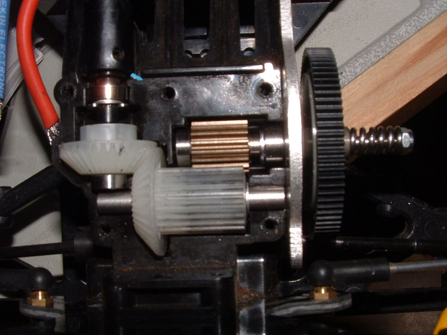

25/78 on 48dp using the rwracing layshaft ad B4 slipper.  But that was a tight track and it needed to go up a tooth or two, but heat was my enemy.

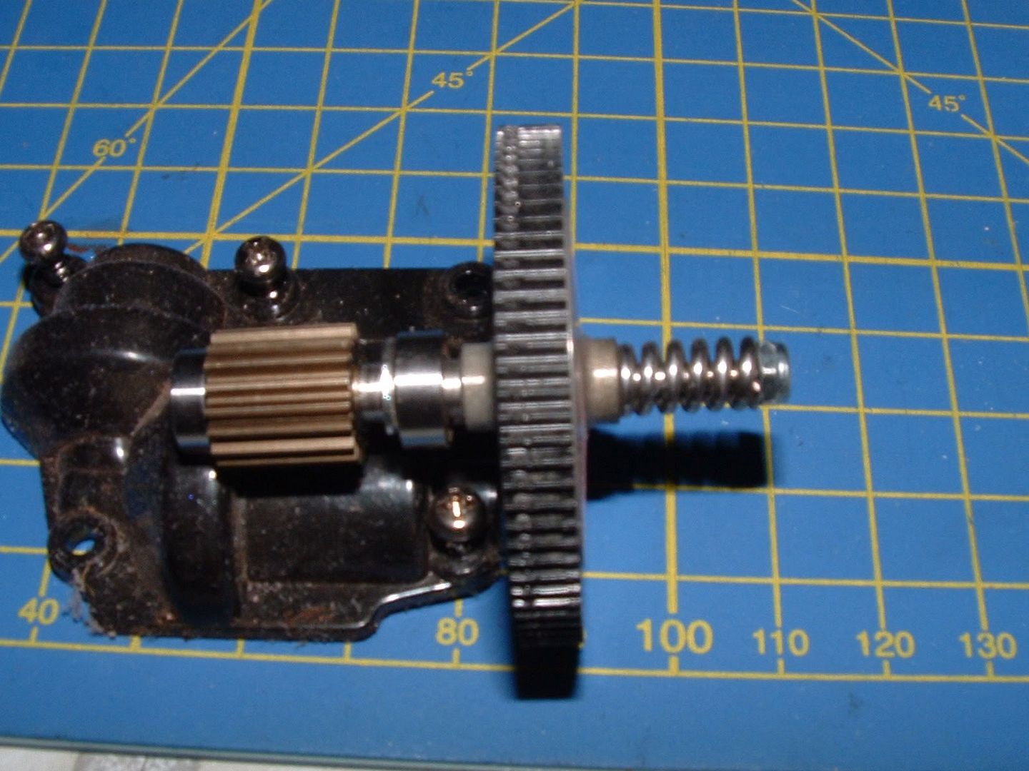

Hi DCM71 I ordered the slipper unit $37.00 US $ expensive in deed!
Just wanted to know does the stock gear cover unit fit still?
Also i hear guys saying you can buy the tamiya one for alot less and just drill out the center of the B4 spure gear just a little and it should work with the tamiya slipper unit.
Shen
the reason it is expensive is that the currency conversion puts the price up, thats about as cheap as he can make them in the UK and sell them.
The problem with the Tamiya one is that if they are made from the same material as the kit spur, the material is junk.  But you could use the Tamiya one and ream it out, but you would have to be careful to keep the hole central.
DCM, I ordered one of these shafts, what are the Associated parts # needed for this to complete the assembly?
You will need to source some Asscoiated parts
9651 - 81tooth spur gear
9603 - slipper pad (x2)
9604 - slipper hub (x2)
They also do a 78tooth spur gear to.
I have spoke to Neil about making smaller spurs to, he will look into it but he can't do it for a couple of weeks though, and can't promise due to the fact he would have to machine the retainer for the slipper pad into both faces of the spur gear.

My B4 slipper unit arived today my bearings would not fit on the shaft i had to put it in my dremel tool and use sandpaper and sand a little off where the bearing went on to get it to work properly... I think mine was just a bad one as where the shaft was ground to size it looked like it had chips out of it like as if the bit they used to cut it was dull....
Hopefully they all are not like mine!
Shen
Complete ASC parts list:
9603 slipper pad
9604 slipper hub
9605 slipper spring
9651 spur gear 81t
I was able to purchase them all for a combined $14 USD.
