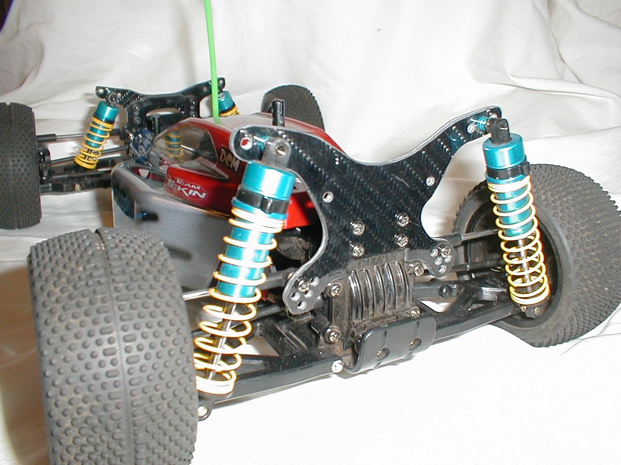

Thought I would lighten the conversation up with some pictures!
Dark Impact + 13x2 EPIC Motor + Novak GTS ESC + Trinity 4200 mAH Matched Battery =
One "SUPER FAST" mother!
