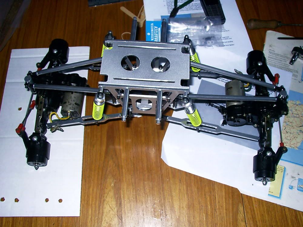

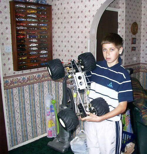

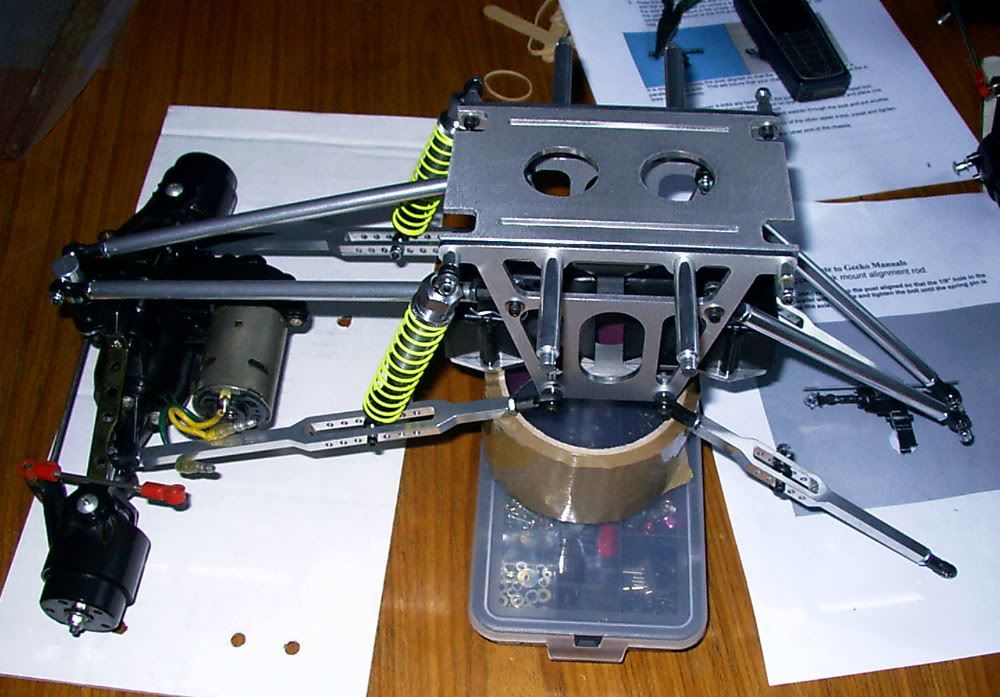

I have just recieved my brand new Gecko 60/40 chassis.
Chuffed to bits with the look of it.

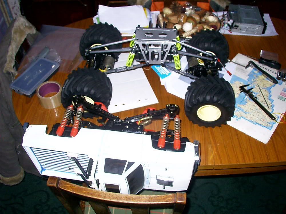

Pulled the axels off my clod, and am wondering which way other people run there 60/40 chassis, is it best to 60 front or 60 rear does it make any difference ?
Also can the stock shell be used or will it limit the articulation, i'd like to know this before i go n drill new mounting holes in the shell, mind im not 100% poss that i am going to use the clod shell because i have another idea floating about in my tiny little brain.
  Cheers in advance to anyone who bothers to answer.

All the ones i've seen the 60 goes at the rear for stabillity reasons.
I'd test fit the clod shell 1st if not happy then no prob at least it'll still be in one piece.
Steve
Cheers for that Steve,
I had thought of 60 rear for stability and i will try and place the clod shell on without any drilling first just to be on the safe side.
Do you know which size shells are usually used on the crawlers or is it almost any with mods made ?
 Brucie

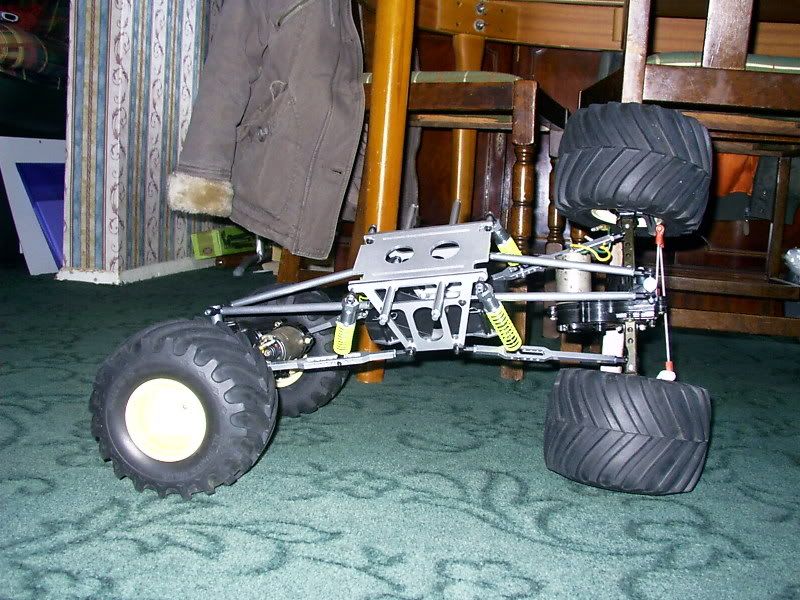

To see articulation on a Gecko II (50:50) chassis with the original clod body, check out Hillman666's photo's of my Gecko at Kidderminster this year:
http://www.tamiyaclub.com/showroom_model.a...82&sid=3623
Hope that helps.
I do put a lexan one on if I need real articulation, but this works fine for crawling over rocks and fair size boulders at my local beach!
Or for a real laugh, take a peek at the bodyshell I use for max articulation (and ran at Kidder 2005!):
http://www.tamiyaclub.com/showroom_model.a...52&sid=9788
Steve
p.s.  Forgot to say, the Clod bodyshell is much heavier, and make the car more prone to topple over on angles!
I see what you mean about the clod body being top heavy, i think its going to be a lexan shell then.
Ohh yea and i love the pics of ya max articulation body, thats realy mad.
  LEE
Steve
Well said Steve.
Having the 60% at the back aims the chassis weight towards the front for a bit more grip etc.

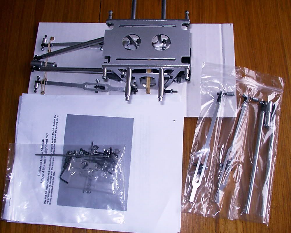

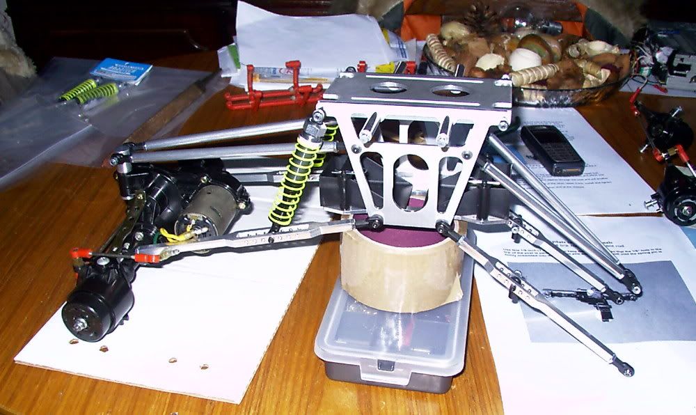

There you go i have added some links to the pics i have just added to photobucket for you lot to see.
Sorry i haven't put then in here but i am unsure of how to do that.
http://i8.photobucket.com/albums/a4/LeeFor...2060%2040/1.jpg
http://i8.photobucket.com/albums/a4/LeeFor...2060%2040/2.jpg
http://i8.photobucket.com/albums/a4/LeeFor...2060%2040/3.jpg
http://i8.photobucket.com/albums/a4/LeeFor...2060%2040/4.jpg
http://i8.photobucket.com/albums/a4/LeeFor...2060%2040/5.jpg
http://i8.photobucket.com/albums/a4/LeeFor...2060%2040/6.jpg
http://i8.photobucket.com/albums/a4/LeeFor...40/IMAG0002.jpg
http://i8.photobucket.com/albums/a4/LeeFor...40/IMAG0005.jpg
http://i8.photobucket.com/albums/a4/LeeFor...Lukengecko1.jpg
http://i8.photobucket.com/albums/a4/LeeFor...Lukengecko2.jpg
As you can see im a long long way off finishing and to be honest it may be a while before i can do much more to it.

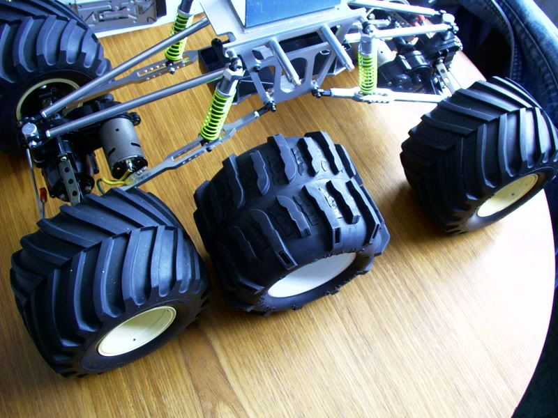

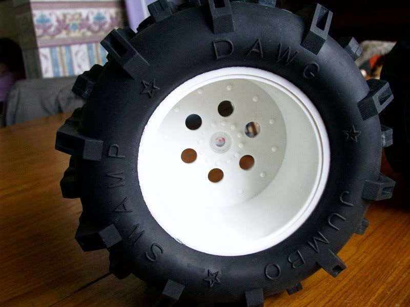

I have a set of wheels with Jumbo Swamp Dawgs (cut down a bit) which i would like to use, they have a 14mm hex fitting so i need to find some adapters preferably ones that widen the track slightly-:
http://i8.photobucket.com/albums/a4/LeeFor.../Wheelfront.jpg
http://i8.photobucket.com/albums/a4/LeeFor...0/Wheelrear.jpg
http://i8.photobucket.com/albums/a4/LeeFor...40/IMAG0010.jpg
If you have any adapters going spare please feel free to let me know.
