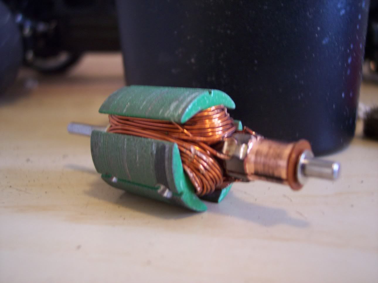

Took my TL-01B out for a spin but did not get far. My motor (Trinity Gem Amber) completely jammed due to a rock between the poleshoe and magnet. My motor was filled with dust from the magents and even a small piece of magnet was broken of.

It seems that in our company we have a winding department with a enormous selection of copper winding. They can even wind these litlle rotors!!
