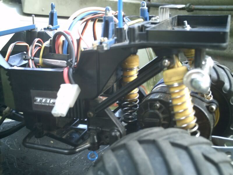

another "basher" mod done by many people is stiffening the rear of the chassis tub.
the lunchbox chassis is basicly a modified tamiya pajero tub, and still has the rear "table", where the pajeros hump battery was fixed.
the pajero has its rear shocks mounted in a very nice place on the chassis tub, you can still see their mounting positions on the lunchbox chassis.
but when tamiya turned the pajero into the lunchbox, they placed the rear shock mounts further to the rear of the chassis, in the middle of the "table".
this causes the rear of the chassis to flex. to much flexing, or a big impact will break the rear of the chassis tub!
plating up the rear of the tub was one way to fix the rear chassis flex, but i came up with this method:
you can see my plastic brace going from the rear shock mount down to the axel mounting part. i've added one on both sides. now the rear table is rock solid! i dont know what the plastic brace part was from, they came in a bag of spares from ebay - but the same can be achived using metal rods and rod ends (like steering links).

AMAZING!  I just did a short test drive today and it's totally
different. The brace for the front struts and the braces for the rear
struts (to reinforce the rear of the chassis tub) make a HUGE
difference. Compared to before the whole thing is just so much
stiffer!  And you're right the rear of the chassis deck felt like
it was about to snap.  Now it's just solid.
