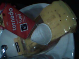

Brushing on nitro did nothing!!   After 10mins heavy brushing with a nitro saturated brush nothing happened.
So I uncomfortably let petrol sit in the shell for further 10 mins, but still nothing. Is the paint unusually strong or...  ?
I expected the paint would just dissolve off under the brush... suggestions?
 The goods
 10mins of this
 10mins letting it sit
No change!?? !
Try 24 hours.

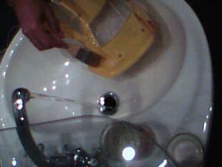

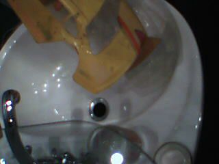

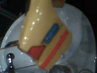

I didn't have the courage to post this before but here's what happend with ovencleaner:
I DON'T RECOMMEND THIS THOUGH!!!
The roof is also  sanded but it shows it becomes matt...
I'm kinda lost here...[^o)]
Maybe it has to do something with the paint...I really don't know anymore.
It works but I guess only for some brand of paint.
Still, the little marks won't come off but in general...well...see for yourself.
Grtz Dee.
