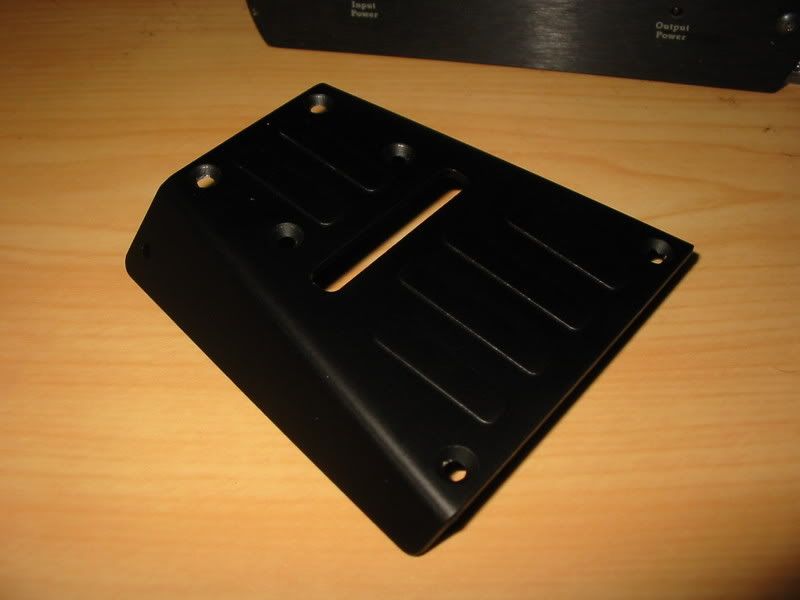

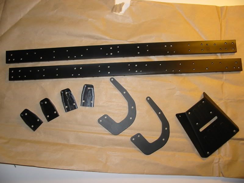

I had all of my silver aluminum parts from my F350 hard anodized black:
(The frame and shock towers are custom machined and not the steel bits that came with the kit.)
They are actually HARD anodized, which not only gives you a tougher coating of black, but also increases the hardness of the metal itself.
I'll admit it's not a cheap process to have done, but the upside is that the price is the same if you're doing one piece or 50 [Y]

From the Yellow Pages I discovered that most industrial anodisers only accept large items, such as 18m long beams for buildings. I challenged them that my TXT-1 was pretty big, but err... I kept searching. I found one place in Melbourne that would accommodate me. Equivalent to US$35 for regular anodising and US$50 for hard anodising. According to the Wiki the hardness is close to that of ruby, the hardest known substance known to man. Cool, so soon I'll be able to bash my TXT-1 through the local ruby mine, knowing it will come out unmarked. Haha.
I noticed the customer defined finish can vary - one can choose from Flat to Matt to Satin to Semi gloss to Gloss. I guess a satin or matt finish would be best for R/C - depends on the prototype.

Assembled chassis back from the anodisers... Very happy with job in 'hard black' [:P]. I was disappointed with Tamiy'a QC on this kit. The susp links were packaged with other abrasive steel components that scratched up the clear coat anodising on the links. It is these basic attention to detail concepts the Japanese should be prowess at.
I think it looks like a Patrick chassis (if you're into MTs you'll know what I mean)... Next step is to execute some servo mounts , body and electrics... and those big Jugg shocks - reanodised of course. What a whopper the TXT-1 is to build. Thoroughly recommended to those who enjoy building as much or more than running.
[Y]
Now that is sharp ! I belive this build is going into my "watch" list [Y].  Great work so far . . . . .you mind if some of "us" (me) steal that black anodized chassis look ? I think a perfect topper would be a complete set of Stainless Steel Hex Screws.
