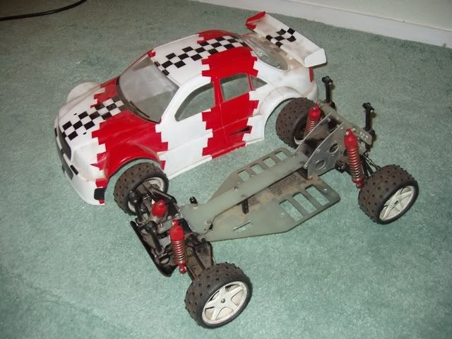

To brighten up the post, here is a picture of one of the chassis (although the other one is is a much nicer red one![H])

4. Shouldn't be any need to soak in hot water at all. The picture above looks like the wheels are later 2.2 inch ones. If your wheels are 2 inch diameter you will need to look on Schumacher's website for their 'originals' range. If the wheels are 2.2 inch diameter then any modern tyre will do. You will find they are much softer than old style tyres so you will need to fit the foam inserts that come with the tyres and the tyres will need supergluing to the wheels to keep them on.
