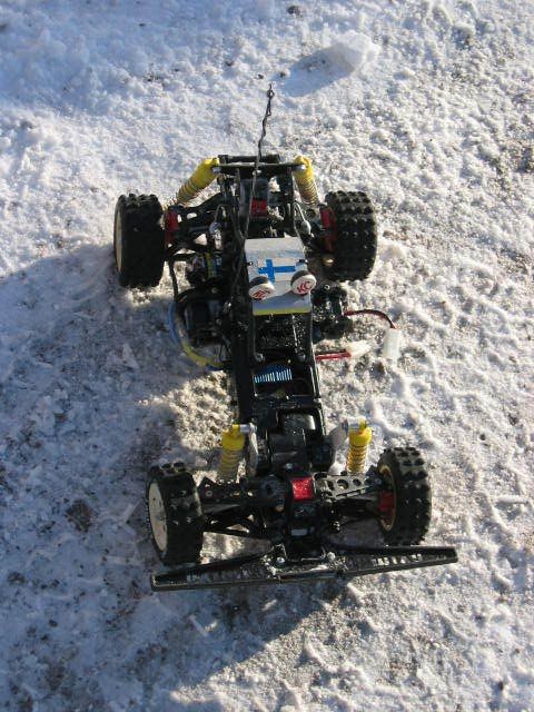

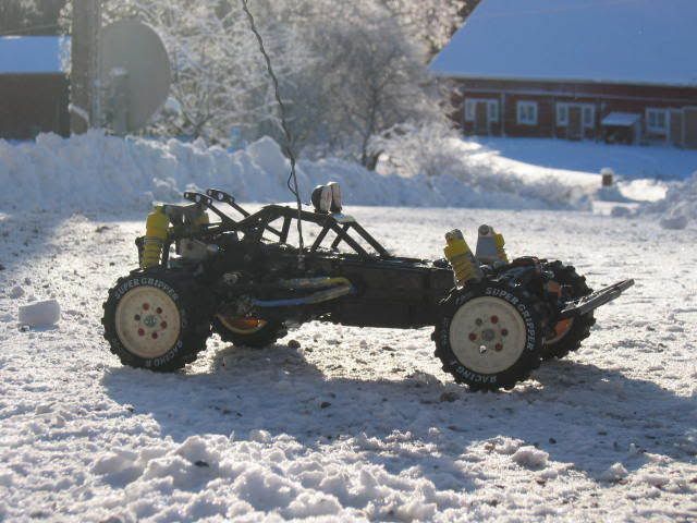

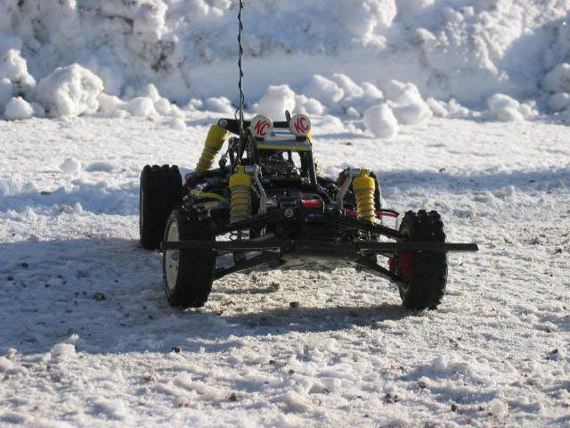

Well I got it all assembled after a time of getting parts from hobby-shops and over eBay. Thank you guys for all help you gave me, especially Jeff, your hints really made sense....!
It takes a while to get in to the "business" again after beeing out of it for 20 some years.....!
Got the propeller joints and shaft from the Boomerang and they fit perfectly, also had problems with selftapping screwholes in the gearboxes but those I just drilled through (where possible) and used bolt-flangenut. Got a new chassis and controlbox from HS2 and they are almost identical with the ones for mine HotShot. Also had a cracked oil seal at one of the shocks, that I glued with Locktite and some silicone. Anyone knows if it is possible to get new oil seals like these ones? Maybe some newer models uses same size?
Also had to put in a new 17t motor in from GM-racing, a Hi-tech ESC and a new batterypack.
Yes it ate a bit of money but it was all worth it after the first testrun. It got so mutch power it is almost impossible to go full throttle on the snow. It was flying......!
Got most of the Tamiya parts from Modelbuild in the UK, great outfit with good service! I always got the orders after 3 workdays.
Still working on that front A-arm bracket. I´ll maybe get it machined out of aluminium from a friend of mine. Cant find any on eBay right now since I would prefer one from CRP (they say it is stronger than the one from Parma.....?)
Rear A-arms are also in bad shape (glued) and Im thinking of getting those machined out also since I work in the "metal business".
So now I will continue with my other project, the WildWilly restoration and then I have a Kyosho nitro Truggy waiting for me but thats an other story......!
Thanks again, Mag
