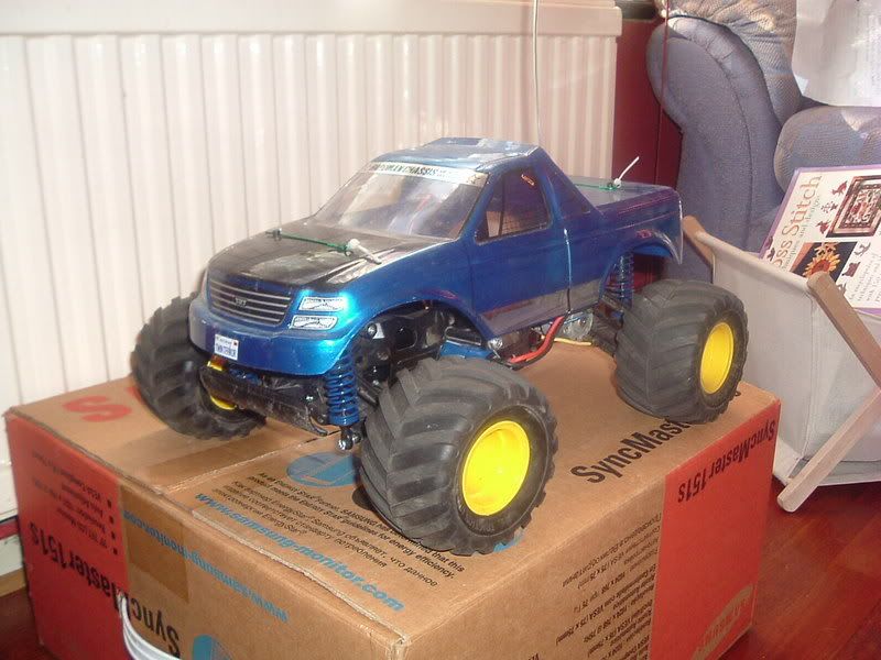

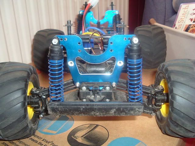

The question is, what kind of vehicle do you want? A mini-monster-truck, then IMO go for a TL01 chassis, ie Stadium Raider.
Order:
 0005688 x2 (Wild Dadder C-parts)
 either 9805563 (Mad Bull rear wheels/tyres) or 0440024 & 50374 (Wild Dagger wheels/tyres) 2 sets of each, or you could look in the CML catalogue.
 9805585 x2 (threaded shaft)
50596 x4 (ball connector cup)
9805551 x4 (Wild Dagger dogbone)
9805825 x2 (ball connector)
50592 x2 (ball connector)
a set of cva oil dampers are a cheap option for suspesion, or you could fit a set of Maxx shocks (ebay or lhs) along with eiter a home made shock tower, or some off ebay (just tap in "wild dagger"). For the later you'll need; 9400455 (F350 High-Lift E-parts bag, it'll contain all that's needed to fit the shocks to the truck.
Motor/esc upgrade are up to you.
All of these upgrades gets you one of these; rcpics007-1.jpg?t=116806866
rcpics004-1.jpg?t=116806866
This is my lad's basher.
Hope this helps.
