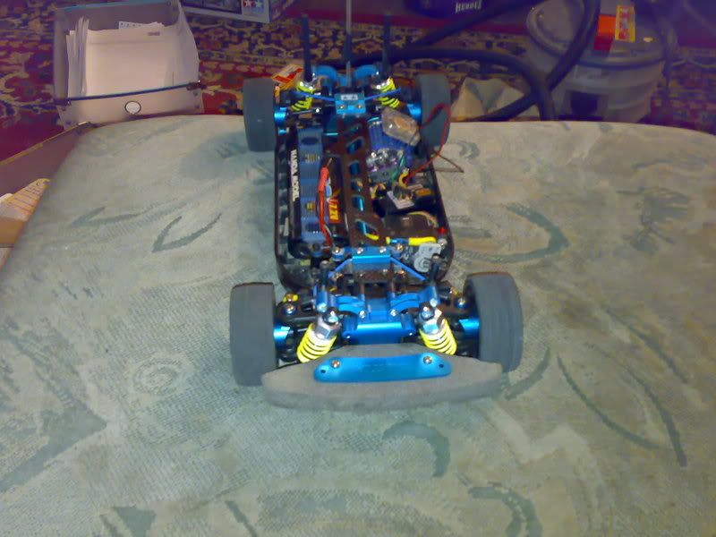

Mr Snake, thats one fine lookig TT-01 you have there, I'm interedsted in the steering setup, I've noticed there is an unhealthy amount of play in the plasticx units so i will be looking to replace.....any advice?
yea best thing i evey did is GPM Alloy complete Tie Rod Set found on ebay at 130046062641 (thou buy two sets as i have broke one, so now have a spaer set as well) and also fit  GPM Alloy Steering Assembly  found again on ebay at 330031368372! the tie rod set tamiya do one as well! but £4 posted from hong kong or were ever for the gpm one cant be bad!
i also run slight toe in on the front, and 2deg camper rear, 1 deg front, duno if this helps, cheers martyn
My two cents on GPM (are we wandering off-topic here?): I've bought lots of alloy parts from them (never shocks) and they were all great. The only time I ever had an issue was once I had to file an alloy c-hub a tiny bit to fit an alloy arm. Otherwise, I am impressed with their quality. They typically include plenty of hardware with their parts. My alloy arm set even included a full set of hingepins+clips and two sets of replaceable bushings for the pins to ride in! Not to mention their c-hubs come with both bearings and bushings for the kingpins, and all their parts come with lots of shims to fix any slop.

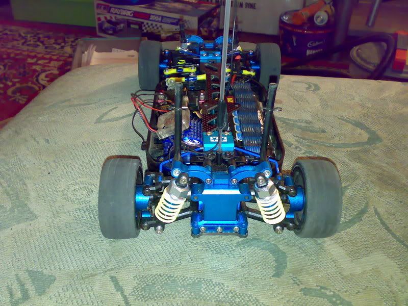

Well, slight update.......I've started to tidy up the wiring by soldering the ESC directly to the motor and curling the servo wires......I still need to sort the Deans connectors and shorten the steering servo cable though......
Looks a lot better don't you think......
