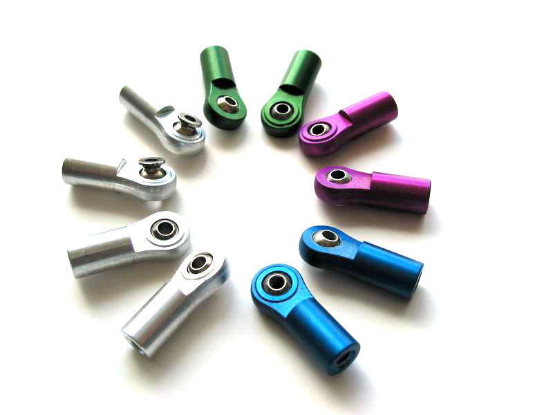

I wouldn't recommend using aluminum rod ends on a crawler, not even our own higher quality rod ends. Most that buy our alloy rod ends use them on show trucks or racers. Alloy rod ends:
(1) Do not give you the freedom of travel on the ball like heavy duty plastic ones do. That's bad news for a crawler.
(2) If the ball pops out the rod end is no good anymore - the balls will pop out all the easier after that, even on our alloy rod ends that can handle a lot of force (unlinke those cast ones) they would still need to be replaced since the ring holding the ball would most likely be damaged. I don't see a pressed ring on the cast ends BTMR shows so those are just trouble waiting to happen.
If you're going to upgrade the rod ends on a TXT used as a crawler, go with the Kyosho 6.8mm plastic rod ends. They have been the standard replacements to the stock ends.
-Alex
