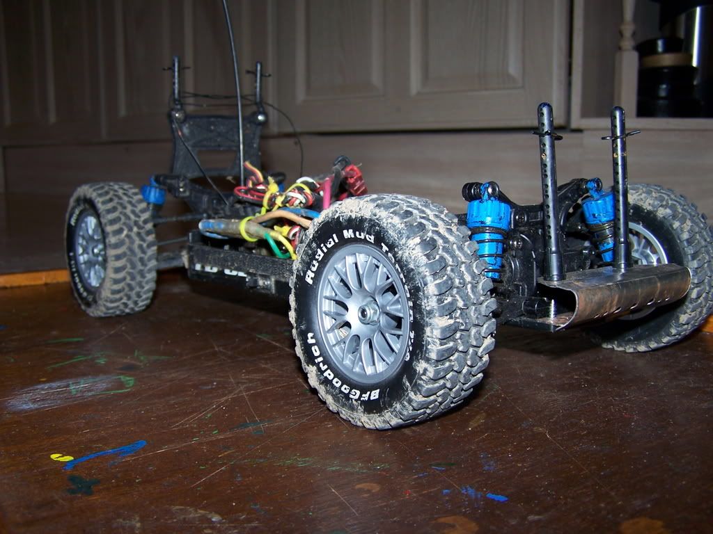

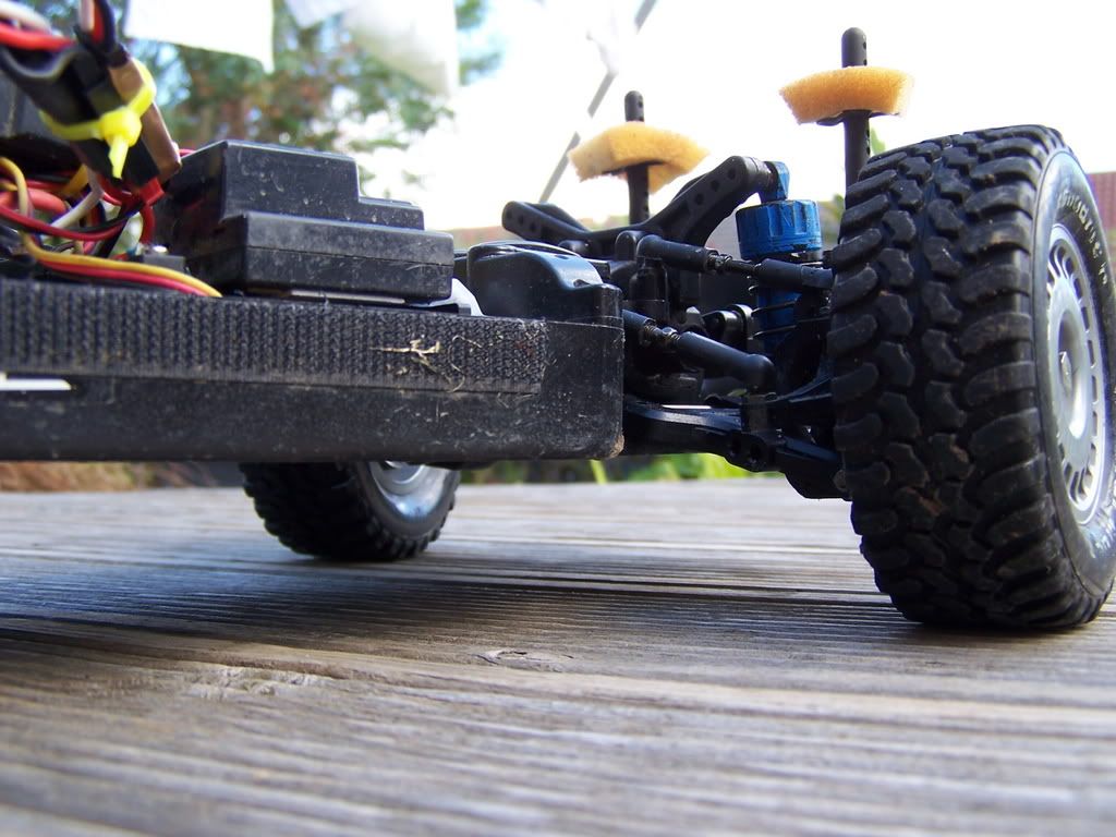

So with a TB02 as the donar car it was time to look at getting more ride height out of it.
Rear End
Firstly the removal of the anti-droop screws allowed for full lowering of the rear suspension - This was then supported by some old TB01 shocks (painted blue for some reason - they came in a trade so dnt ask me why) The adujustment was made the cambre settings and also to the upper arm mount points to allow for the Rear bodymounts of a TB01 focus as the touareg shell has a high rear end. Also sorted at the rear end is the wheel wideners from my Exisiting CC-01 based touareg, these effectively lower the centre of gravity as well as filling out the wheel arches in a more realistic manner.
Rear end set up.
With the Shell added.

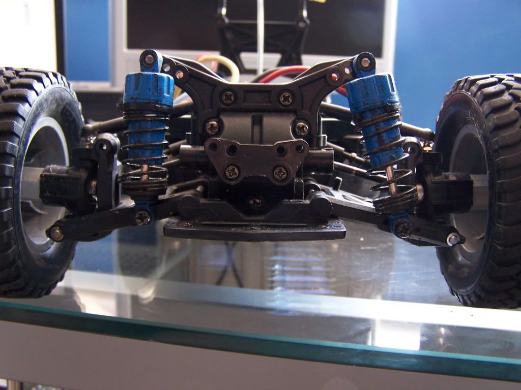

Front End

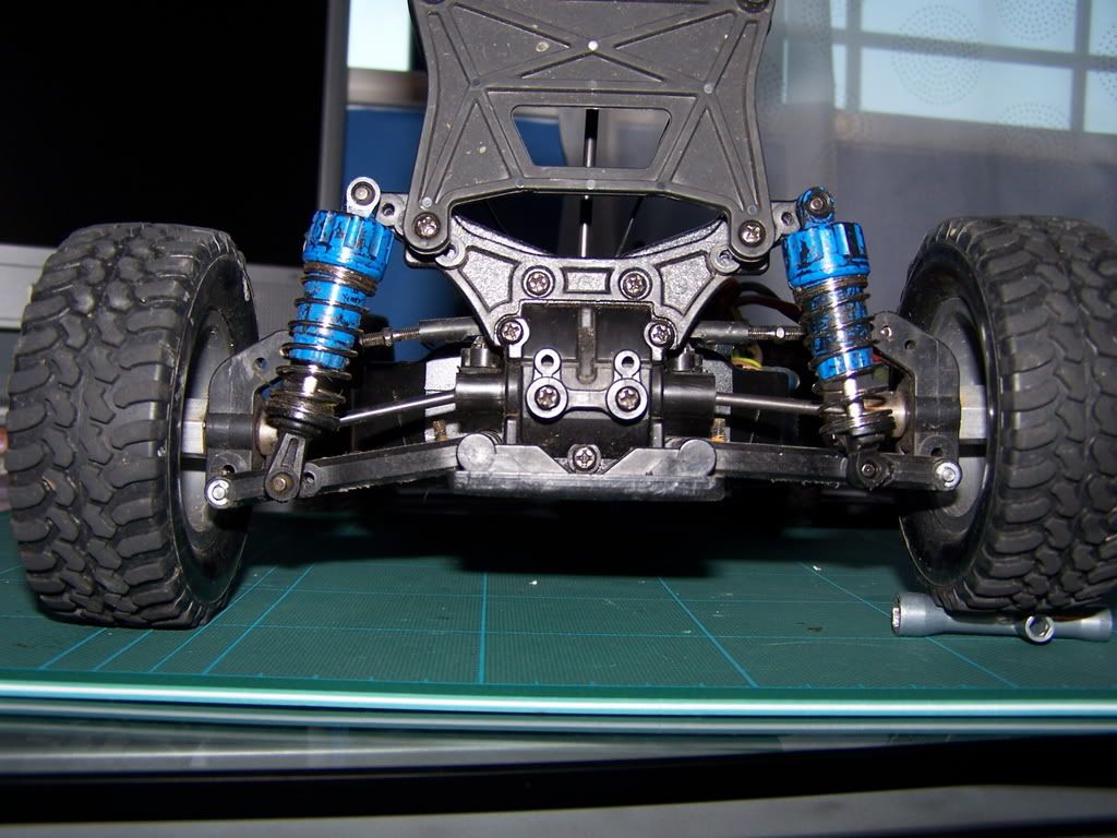

Now as you will know getting ride height out of the rear is always much easier than the front end. And the Tb02 is no exception with the overly wide TRF C hubs and the lower arms. So in came the lower arms and C hubs of the TB01 LA suspension set- proven on my rally car these are tough and reliable. The stock TB02 hubs remain with the 5mm stock axles. The front also gets the lovely 'blue' shocks and the wheel wideners to fill out the arches and add stability. However the mounting point is a little vertical for my liking and is actually the point for the stabilizer set when used on the TB01. Does anyone have any hints/tips on drilling into the lower arm further out from the centre of the car and adding a mounting point there to make the shock more lateral.
Front Hybrid Suspension.
With the shell added.
In the Tub
The central tub sees a 16 tooth pinion to 61 spur for max accel and torque along with some old electrics, a sport tuned and a TEU esc. there is also a Tb01 inner shell and some plastic strips to cover up the base - More needs to be done here in order to ensure that its waterproof as I nearly drowned it in shakedown last weekend (20-22 july was a little damp here in pershore).

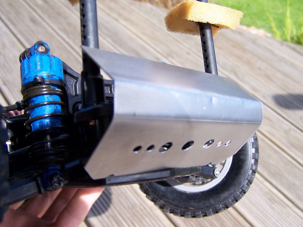

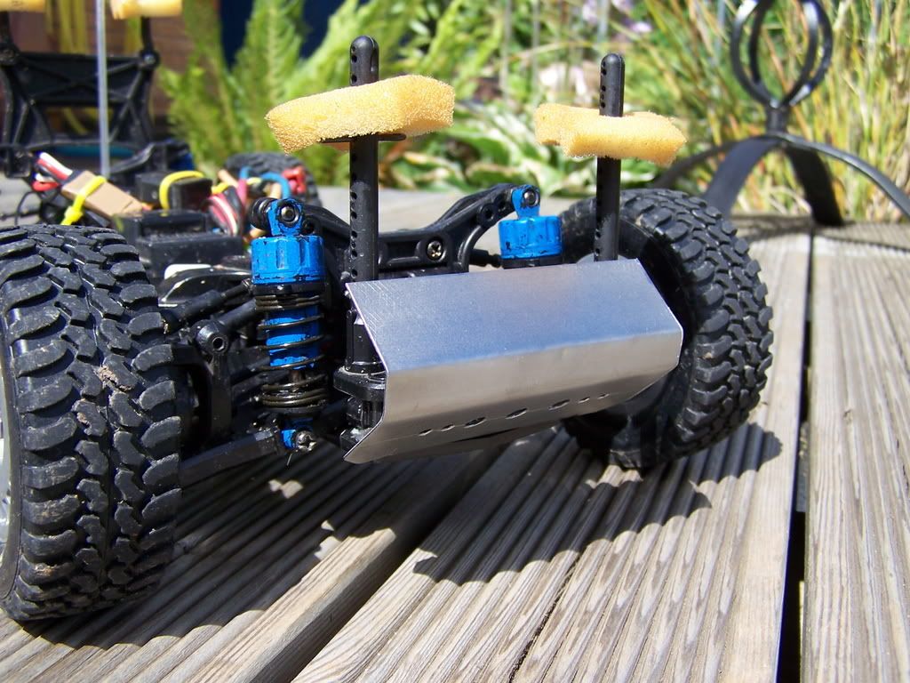

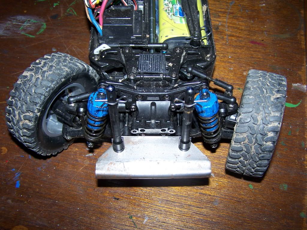

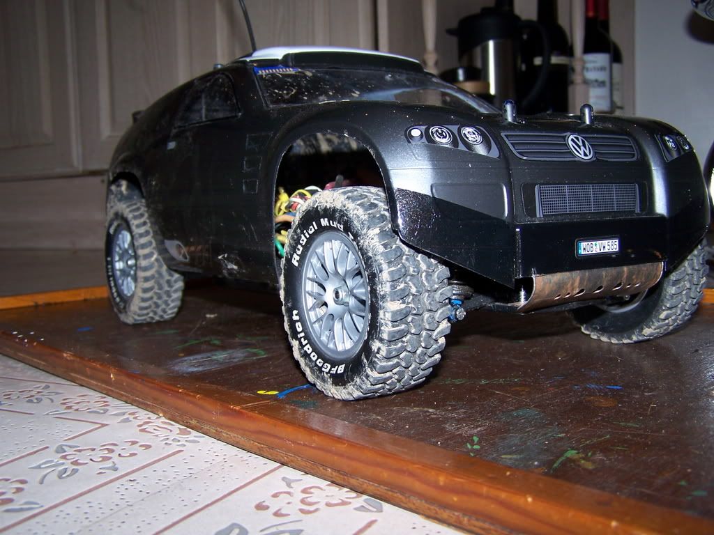

Have had a steel front sump gaurd made today. dad made it whilst I did the decals on his M3 around the windows and lights.
It is made from 0.5 mm sheet steel that was brought from B&Q at 4.50 for a 250mm by 500mm sheet.
The Sump has replaced the exisiting lower part of the bumper holder on the TB02 - And gives a better approach angle and impact protection to the rest of the car.
It has been made by first cutting out the plate from a template which was done using the very thin tin found on the whisky tins :rolleyes: - Next the crease lines where added in a vice and the holes drilled at the front and for the mounting screws where the original TB02 lower bumper part was installed. The design allows for a spring like action when an impact occurs and In the future I will be able to mount the front of the shell on with Velcro allowing my to transfer the upper part of the sump down and to mount it onto the top of the upper TB02 bumper section for more rigidity.
Appearance -
Close up - Note shape and holes added to lose weight and add to visuals.
Tho need to file down the chassis edge to make it smooth enough to not snag when off road.

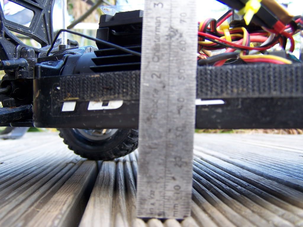

Also shown below is the total ground clearance with the machine fully loaded with battery and radio gear - 30mm at the front and the same at the rear should be ample for the off road tracks :)
I hope now to sort out some new inner protection for the electrics - Anyone any ideas on the best way to seal the plastic covers into the base of the chassis and also add some rear mud flaps.

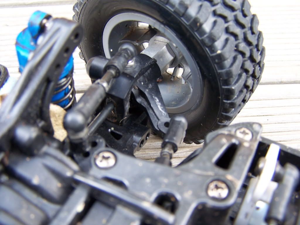

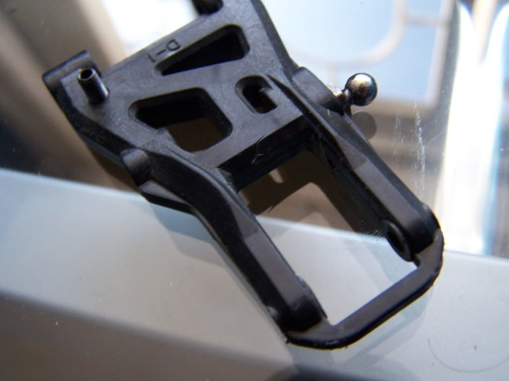

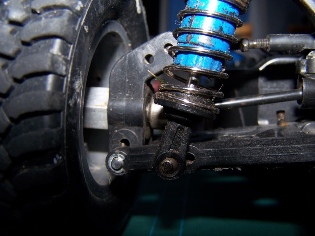

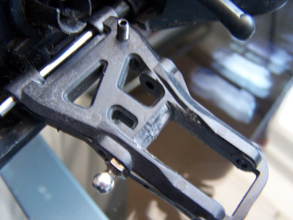

Now to the updates today I replaced the TB01 LA lower arms with a modified version of the original TB02 trf lower arms which have better shock mounts in the middle of the arm not the inside.
The reason for these arms not being used first was that they didnt allow for the downtravel required. As thus they needed to be modified with the enlarging to allow the C hubs which are from the TB01 LA set due to there better profile.
See the stock arm (1st pic) and modified arm (2nd pic) which will allow the required down travel.
The modified arm was then put into the suspension as a like for like replacement for the TB01 LA lower arm. I chose to keep the strong non ball stud lower mounts with a smooth screw which is stronger under impact than the ballstud ends.
In the picture below is the comparison of the last gen suspension on the left and the new gen suspension on the right hand side, which shows the better angles of the shocks that should give a more compliant and stable front end as well as using the whole stroke of the shock.

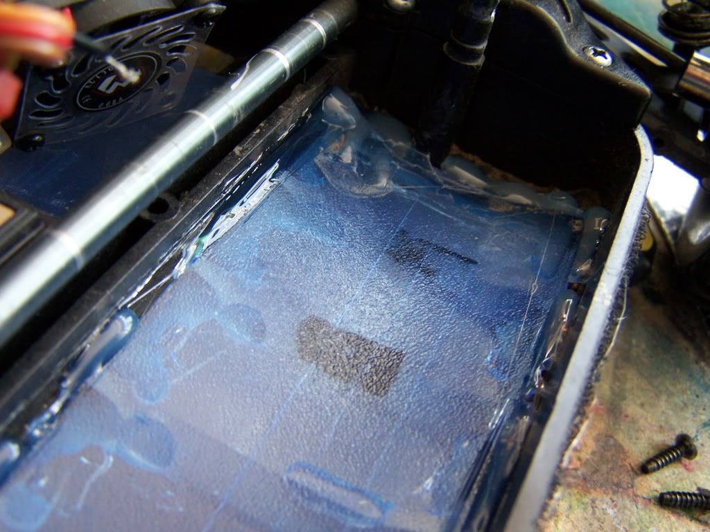

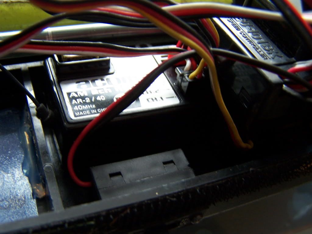

After doing the suspension I sorted out some plastic coverings for the holes in the base of the chassis using soft plastic and held in with hotglue from the hotglue gun. Should keep most of the dust and grit out even if its nt 100% waterproof. shot4-plasticsgluedintobase.jpg

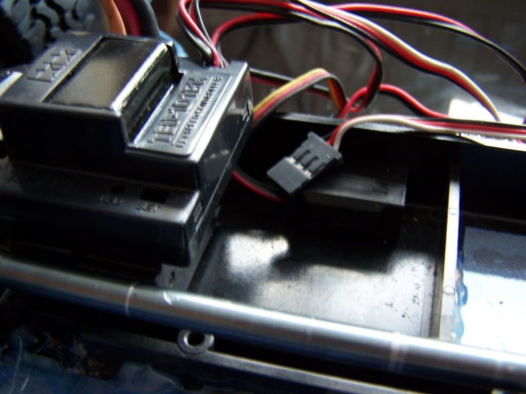

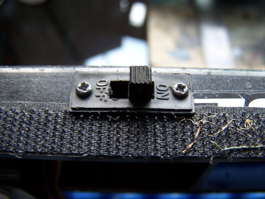

Next to sort out was the problem of the TB02 tub having no switch mounting point. so out with the drills and files to make one in the side of the chassis. Admitedly the swtich head is exposed which is why I have orientated it around to make the on direction be at full backwards so the car wont suddenly cut off due to a stone hitting the switch off.
Next came the fitting of the electrics a TEU-101Bk as it has a full reverse unlike Mtronicks esc that was previously used. Also replaced was the kyosho reciver for a 40mhz acoms one mounted low down behind the esc.

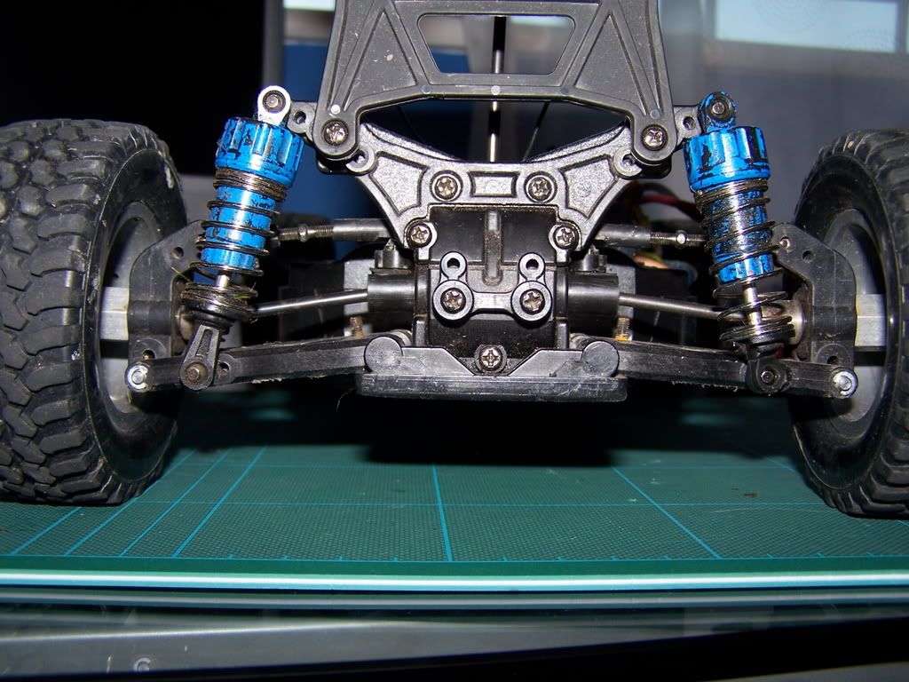

Done some more work today on the Touareg.
First change was to properly sort out the rear diff which is now locked with a big screw through the middle and two smaller screws either side - Was there ever a spool function for the TB02 that could replace this in time and be lighter in the process?
the next update has been to the rear suspension in order to get more travel and hopefully a supple car I have noticed that the rear shocks are not using all there stroke with the long shock ends, As thus I have replace the long ends with short ones and moved the mount point in to mean that full possible downtravel from the suspension before it binds is the same as the full stroke of the shock. This really starts to show its benfits in the fact that the car now has a whole 7mm more uptravel and that the front and rear travel range is now the same making the car much more balanced espically over bumps and undulations.
the old set up with the long ends to the shocks that failed to give the maximum suspension travel.
new ends to the shocks and moving them in has allowed me to get the same downtravel but more uptravel by 7mm :D
Finally a comparision of the travel both have the shock shaft in the same position but as u can see the new system is higher up already so when an impact arrives it will av more stroke and be more supple over the bumps and crests of a dakar rally.

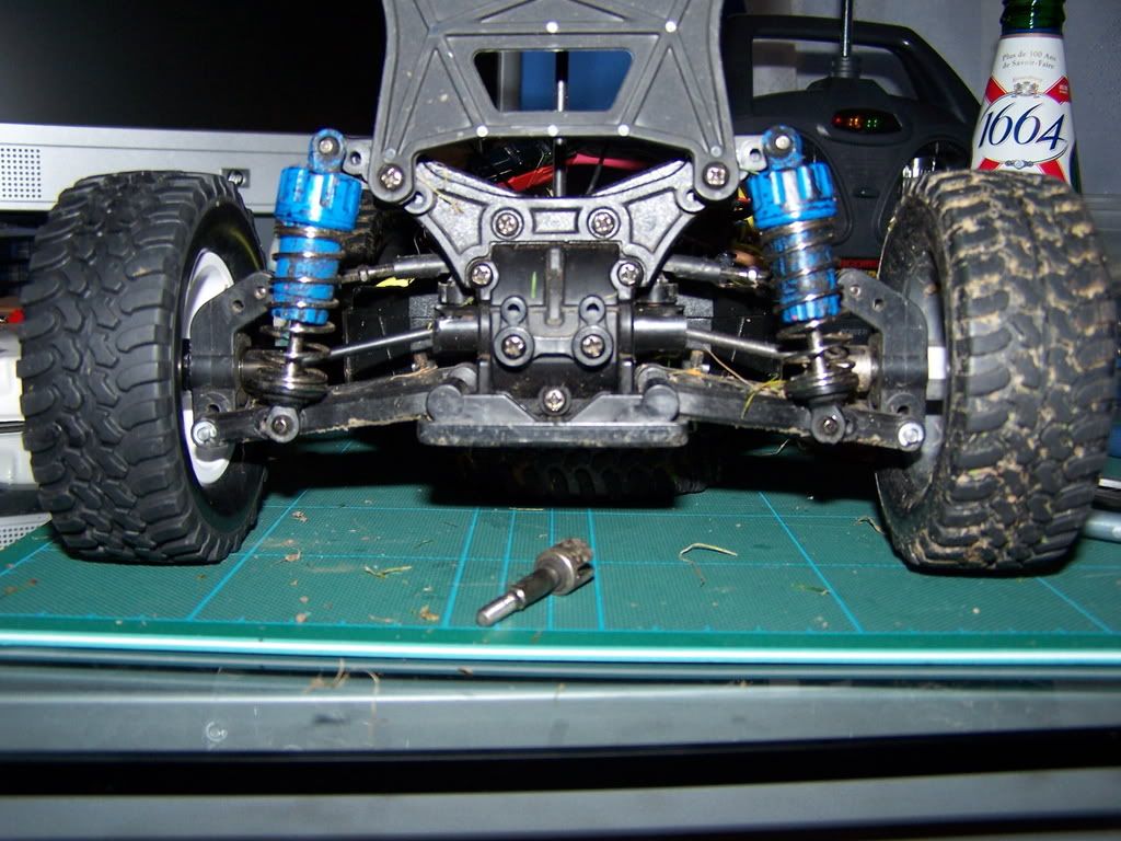

Unfortinately my test only lasted about 5 minutes as the car twice threw out the rear left driveshaft leaving it 3wd :( which on the slippery grass left it struggling and spinning a little bit, But was definately very impressive with the suspension leaving the car very flat and stable in need of more than the stock motors power I think.
Two questions that Ive got are that I still need a little more front end grip and was wondering if using the optional alloy suspension mounts in order to angle the front arms in would be of any help? I havent had any experiance with this hotup so am keen to see what you think? alloy ones are on my hotups list but if I can get ones which help the front end be more positive now that I have locked the rear diff would be great.

the switch on the side was GENIUS! if i get a TB02 i want to have that......

Cheers about the switch - took a while to remove the material but I think its a a very elegent solution to what could be a major problem and has been in the past with the nocks of on road rallying breaking the switch of its double sided servo tape.

also needing to be sorted is the front driveshaft on one side that nearly pops out on a tight corner and binds the wheel up. I might look at spacing the shaft into the centre more or by restricting the overall front turn to not allow it to pop out.

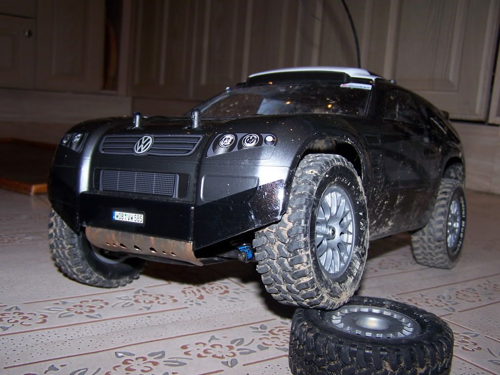

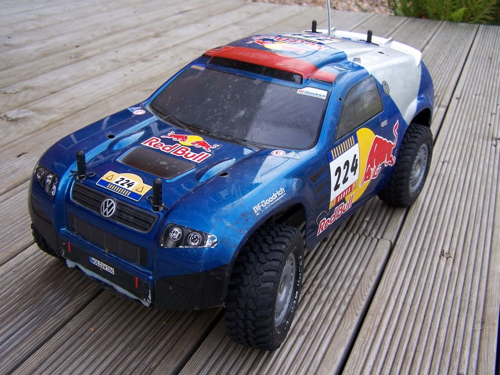

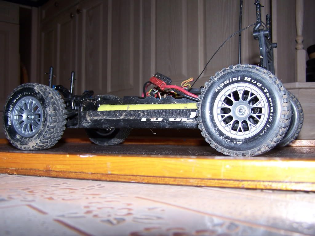

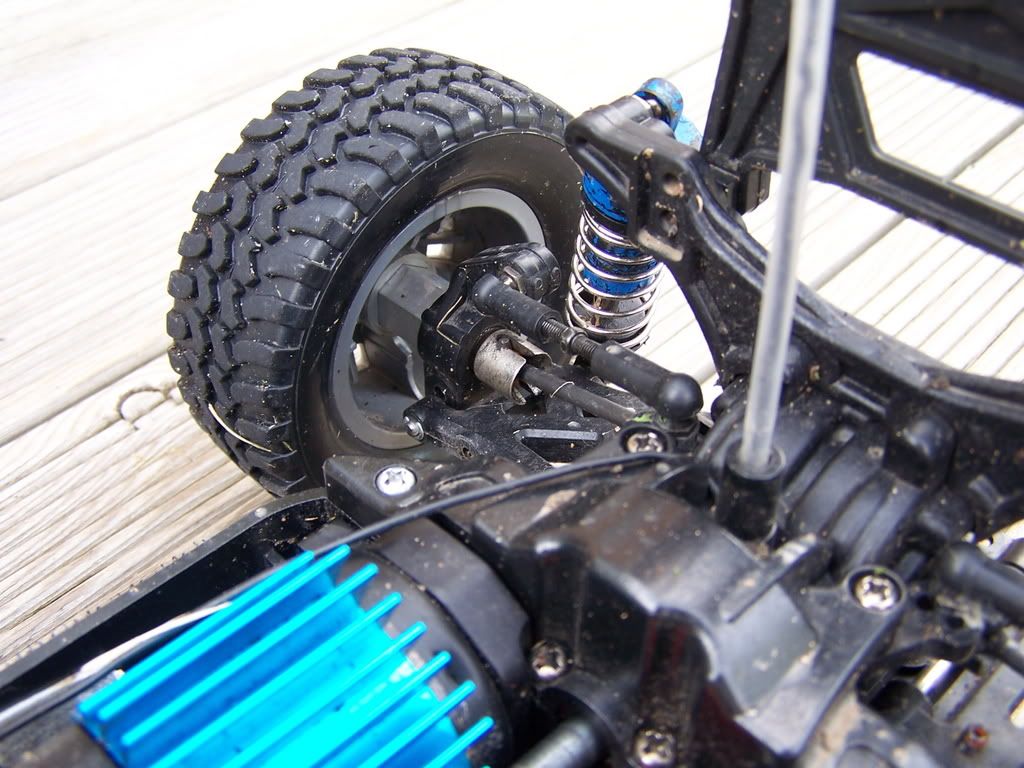

right now finally for some pictures - apologises for the low quality but light here is a preminum its so dull due to all the rain the lights are on in the middle of the day to stop it feeling to grim :L
To start with just some pictures of the chassis as it did its test run, New tyres and wheels and using only 1 little spacer between the wheels and the hubs in order to make it so the nuts go on fully and arent a little thread short so to speak.

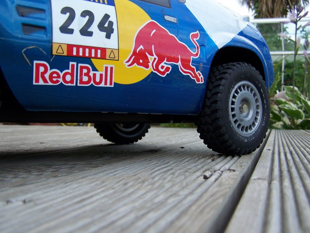

As im sure you can see the car is pretty high up with 30mm of ground clearance front and rear and is now running the same springs all around in order to make sure that the ride height isnt slopy at the rear and hopefully get the chassis more balanced like my Tb01.

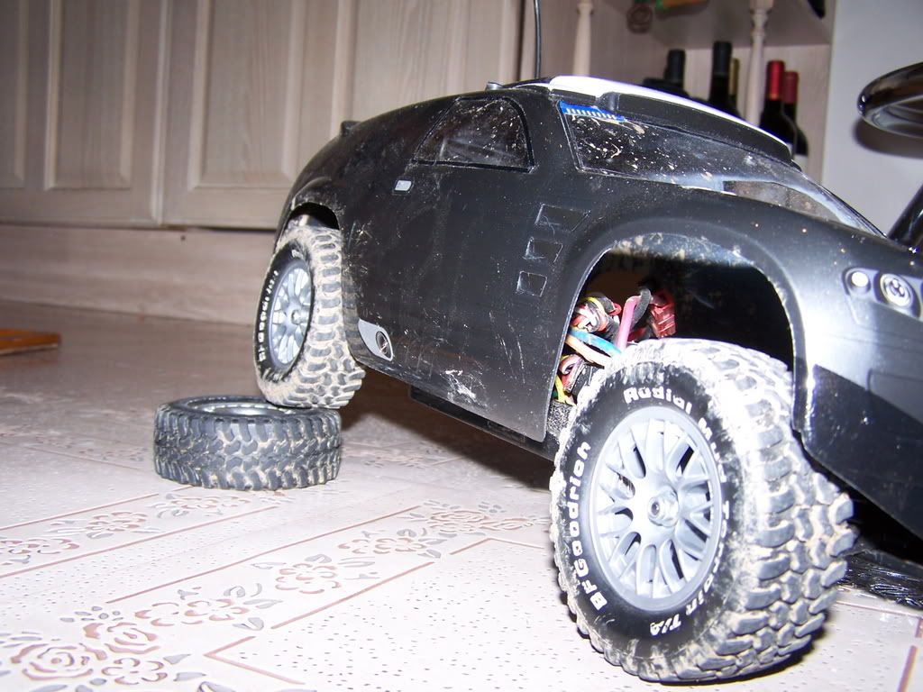

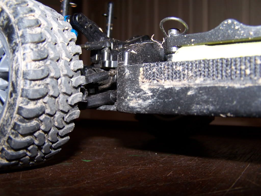

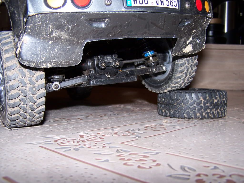

There is however a couple of problems the main one being shown in the picture below when you turn on full lock the inside wheel turns way more than the outside one pushing the limits of the driveshaft stayin in the cup joint, does anyone have any idea of a solution for this?

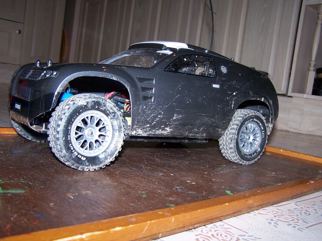

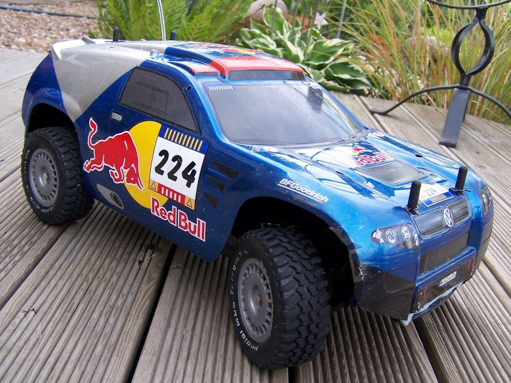

Next I fitted the newly painted development shell that is like the real touareg development shell in late 06 for the 2007 (last years) dakar.
the main problem at the moment is with the front body mounts the stock style ones that I were using before are too weak having been broken in the last test run so I have used the front sump gaurd as a temporary solution with the bodyposts for the test run tho I will be looking to do a more permenant solution before the next run.
Finally some shots to show you the current articulation that I am very pleased about and the car is feeling very supple which I think is why it was very stable in the last test run.

is there any binding of the upper arms when the suspension drops to it's lowest setting?
also.....since you own a TB02......is it possible to get a 257 mm wheelbase?
i see that a TB02 has a 259 mm wheelbase by default.
but i also see that there are spacers used on the shafts between the arm and the the steering block.
i also see that there are mounts on both the front and rear leading edges of the front lower arms. is this true?
if you need me to move these questions to the other thread....let me know......
The super - Yes the shell did come out very well I just need to add the final white decals to it to finish it off - and maybe get some bigger front cuts to be more like the real touareg once I have beefed up and sorted out the front end to be able to take all the knocks that it will no doubt take whilst on a run.
I dont quite get exactly what u mean with the TA03 steering is there any chance of some pics to make sure that what i think you are thinking is what Im thinking (sounds like an old conservative election line :L)
there is no binding in the arms at all something that I am really pleased with - there is still a little clicking from the inside driveshaft which is on the limit of its cup joint tho this will no doubt improve with Uj's and also sorting out the steering with the problems outlined above.
i think it is possible to get a 257mm wheelbase as my TB02 came with an Impreza 03 shell and that fitted superbly so I think that its more than possible - are you thinking about a TB02 for your next rally car project?
The lower arms are spaced out forward and backwards on the metal shaft and using spacers this is how I managed to get the wheelbase of just shy of 280mm for a touareg shell.
yes you can reverse the arms to get the mount on the otherside that is a compromise of the two on the main side -
Cheers Ryck
Wrc action....so on a TA03....the ball cups are connected with a tie rod. and the cup meets the steering arm (not the knucle but the arm).
on an 03 the arm....at the limit of the steering range bottoms on the side of the gear box.
so on the 03, if you want to limit steering, you unthread the ball cups some (and compensate this by using a ball cup and tie rod connector instead of the carbon steering plate) and rather than add toe in, you will effectively limit the steering range.
i'm not well versed enough in the TB02...but if this is an option....the TB02 seems to have the ability to adjust more things......you could effectively limit the steering.
so here is a shot with a position with the wheel pointing straight ahead.....
and here is one at the limit.....
as for the wheelbase....i was hoping that since tamiya states that the wheelbase for the TB02 is 259 and not 257 (like most other touring cars) that the shell would fit like this.....with the wheels not centered in the wells....
it made me wonder if the TB02 shell was some special shell for 259 mm wheelbases......but i figured that tamiya wouldn't make it that complicated....then again......

Wrc action....you could also drill two holes thought the cover that's over the left steering arm and set two screws as limiters? you'd have the back the screws with a nut on the inside but that could be an option.

one thing on the chassis tossing the drive shafts.....are you still using the urethane spacers that center the drive shaft between the axle and the outdrive? also, it's possible that the use of the TB01 rear uprights sets the axle too far from the outdrive?
could you also please post a pic of the under side of the tub so i can see how much material to remove. knowing me i'd go at it with the dremel and end up with no place to mount the gear box. although the idea of still being able to use the "stroke" screws (as tamiya calls them) is a nice idea to prevent the driveshafts from binding.
