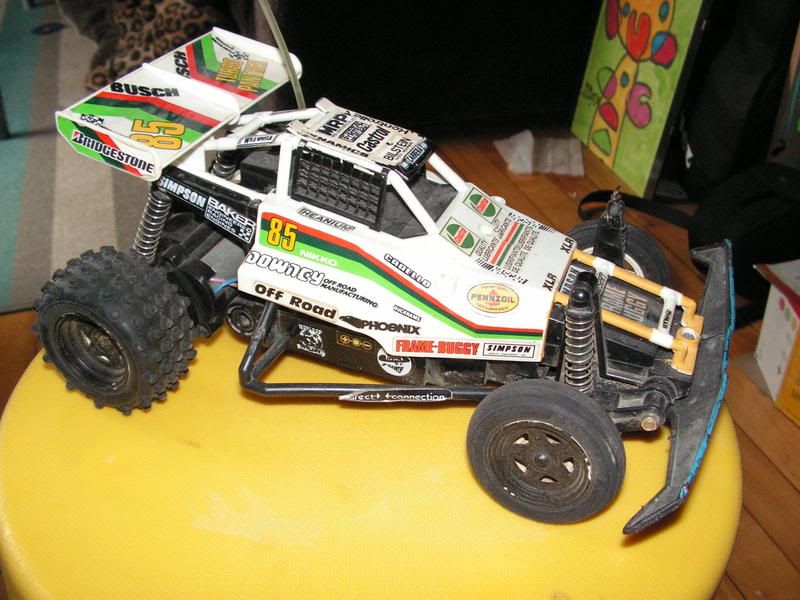

heres my old one...
got a mint black one as well

heres my old one...
This picture brings back memory's. :)
