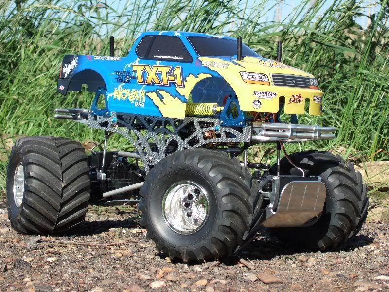

The only other mod I would recommend as a longer term project after you've driven your truck and got used to it is extending the wheelbase out and widening the axles. It makes a huge difference to the TXT stability (its got a habit of spending a lot of time on its roof) and also changes it from a monster truck into a MONSTER truck lol

Extending the wheelbase out is pretty easy. Firstly you'll need axle wideners which you can get from loads of different people, check the link to New Era above. Try and get three quarter inch or one inch wideners. You can go even wider but I think the TXT starts to look a bit silly with ridiculously wide axles. Next you'll need to extend the chassis links which you can either do yourself with bits bought from B+Q or you can buy them pre-made from people like RC4WD.com. Making them yourself is great its quite easy and rewarding. Twinset has an excellent method which I followed to the letter and they came out great and are really strong. Here's his guide http://www.tamiyaclub.com/forum/index.php?...l=links+twinset
Next you will need longer front and rear universal drive shafts. I used RC4WD.com ones http://rc4wdstore.com/product_info.php?products_id=640 They had some problems with an earlier design that I bought but they replaced them free of charge with these new ones and I haven't had any problems since, they're very heavy duty compared to the stock ones. Because you've pulled the axles further forward the truck will now sit lower down so to compensate you can put in longer cantilever links which pushes the axles back to the desired position. You can either make them yourself or buy in. Rc4wd make them http://rc4wdstore.com/product_info.php?cPa...products_id=211
Its a great conversion to do and like I said does make a big difference to the trucks handling (and size!)
Here's mine with all the above mods plus InetRC.com alloy body mounts
