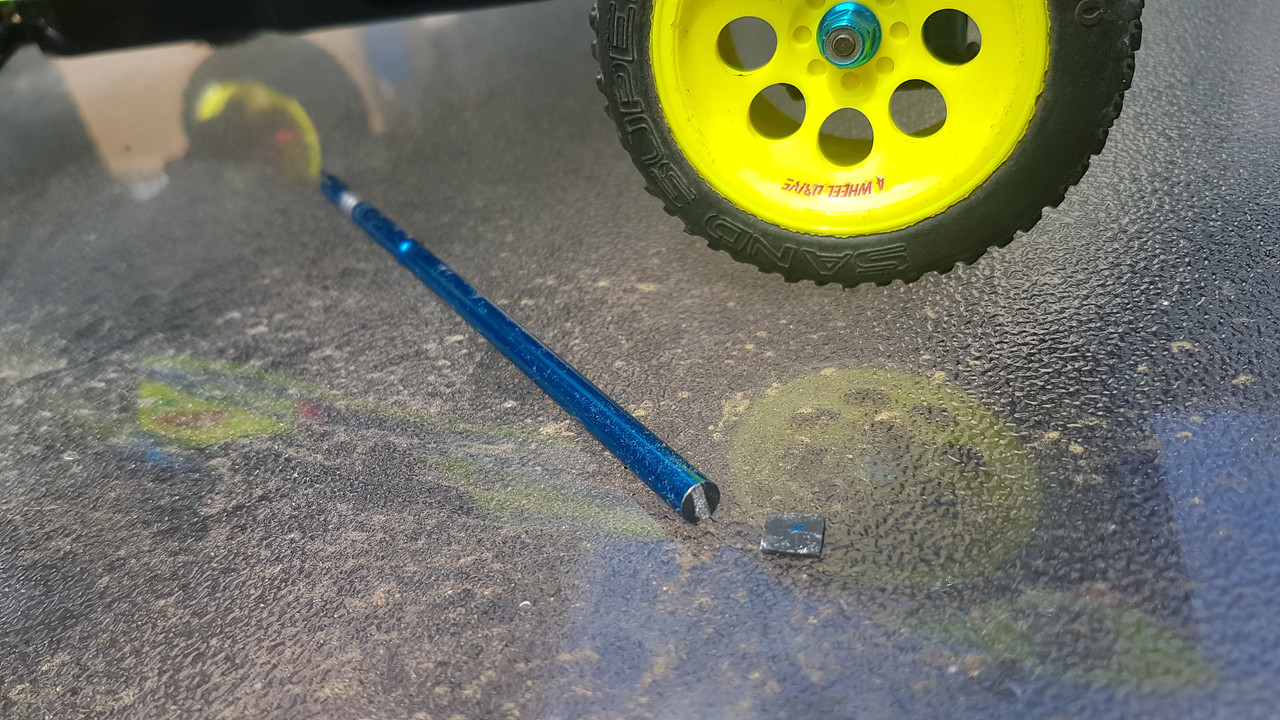

I've re assembled the Manta Ray, that was partly stripped down (mostly the electronics) after yesterday's accidental swim in the ditch.
Much to my surprise, everything worked perfectly. Great! The car definitely stayed at least 20 long seconds under two feet of water, so I'm quite amazed and very happy that I had no damage at all. This is the second time in two weeks (last week was the Hornet, less time underwater but a little longer to recover). At This point I feel like saying that, even thought they can't walk on the water like a Traxxxas or Jesus Christ, Tamiyas can definitely take some accidental scubadiving! :P
But... you know there's always something coming... I was enjoying a celebratory run, all happy for the zero trouble had, when this happened:
I am quite baffled :huh: Like, really??
The prop shaft snapped just like that, out of the blue while the car was pacing on flat tarmac. I've checked everything and found absolutely nothing loose or suspicious. Only thing I can think of, it might have eventually snapped due to all the gravel and pebbles occasionally getting stuck around it, so it finally gave up now and this is unrelated to the dip in the water.
I'd value your opinion on the matter. Should I worry and investigate further, or should I just go ahead and get a new prop shaft and call it a day? Did that ever happen to you?
At a closer look, the extremity of the shaft that snapped doesn't look that tough anyway, so it probably doesn't last "forever" unlike what I though.
I'm sorry that had happened to your awesome looking Manta.  Sadly, that is the reason why I don't prefer aluminum parts.
Hobby grade aluminum is much weaker than steel wire.  6000-7000 grade zinc-aluminum alloy would be strong. But that kind of aluminum would be too expensive.
Shaft breaking would happen on tarmac.  Because the front axle always turns more than the rear.  If you have noticed tire-prints on the ground, they never make 2 lines.  It's always 3-4 lines.  The farthest circle from the theoretical pivoting point, is the front right wheel in below picture.
The rotation rate of the front axle is always greater than the rear axle.  Front right would make 2.1 turn, front left would make 1.9 turn, right rear would make 1.6 turn, left rear would make 1.2 turn.  If you average that, front 2 wheels would make about 2 turns, while the rear 2 would make 1.4 turns.
But drive shaft turns at the same rate.  99.9% of Tamiya 4WDs are 4WDs.  Not All-Wheel-Drives.  Either front or rear would be forced to lose traction (or break the center shaft).
I like the stock wire center shaft in DF01 and TA01 because it twists.  It kinda allows tiny bit of center differential action.  Of course, it will spring back and create a bit of a problem when the turning is done.  It's a pseudo-center differential of a sort.  At least, it won't break.
One other way is to use One Way bearings on the front.  That allows the front 2 wheels to rotate more than the rear 2 wheels.  When you are reversing, it will turn into 2WD. (I didn't quite like that, because when the car dove into a ditch, that's when it needs 4WD the most)
So... I prefer to use wire shaft.  If you like to use aluminum shaft, you have to stay on loose surface, or use one-way bearings.
I am extremely thankful for such timely and detailed explanation. And now I finally seem to grasp the difference between 4WD and AWD :lol:
It was worth snapping the prop shaft as it lead to your post! I am also happy to know that there's nothing wrong witg the car itself.
To be honest, I've never even tried the "coat hanger" stock shaft as in all the threads I've researched before I even got the Manta Ray, I read that literally everybody was bashing it so hard that I ordered an alloy one right away with the motor mount. It's always better to test out things for yourself...
Anyway, your explanation makes so much sense that you've sold me the coat hanger in one post!
I will definitely try it on the car before I consider buying another alloy shaft, and if I like how it runs I'll just keep it that way. 👍 just too bad I don't have it with me at the moment, but I'll be able to go get it soon.
Thanks again @Juggular!
Well, a post isn't worth a part, but thank you for your kind words.
Coat hangers are not perfect either.  It gives you the wishy-washy feel to the 4WD.  The rear will kick in first, followed by the front.  Some people would definitely prefer the one-way bearing option.  And one way bearing will protect the aluminum shaft. (but Tamiya sells steel shaft, which would be much stronger)
I have no idea if this would fit Manta Ray.  If I remember correctly, TA01's one-way bearing was quite similar (if not the same).
@Juggular's argument against the alloy shaft makes a lot of sense, but the widespread dislike of the coathanger shaft is also not without good reason. In addition to the "wishy washy" feeling, it also tends to deform at higher RPM, whacking against the equipment deck and making a horrible racket while also increasing drivetrain drag.
So far the best solution I have found is Tamiya's own hop-up propshaft, made of hardened steel rather than soft alloy. I run this on my Manta Ray and have had no issues, even on very high-grip tracks.
I was going to edit to add this photo, but Turnip beat me to it!
Turnip is right. In this case, Tamiya's clunky-looking steel shaft option (#47373) is a lot stronger than anodized aluminum shafts.

@TurnipJF and @Juggular Thanks guys for your prompt help, really. It is much appreciated.
After reading your comments, Tamiya's clunky steel shaft definity seems to me the way to go. I'm going to place an order for one as soon as shipping costs allow it. And in the meantime, why not test the coathanger and see how noisy it gets!
