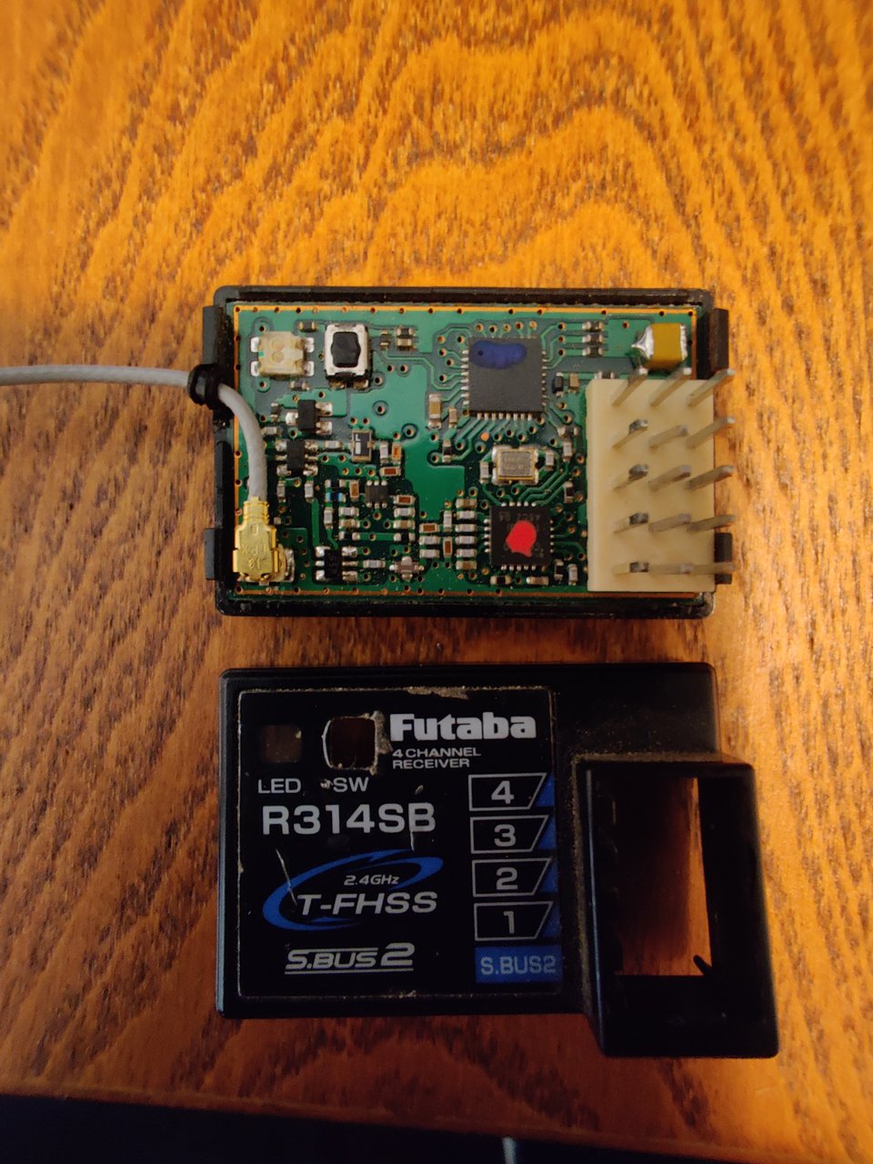

While I was modding and reinstalling my TT02B steering assembly, I had to pull out the receiver which was sticky-taped to the top of the steering servo, which naturally involved carefully pulling out the antenna from its post by unscrewing the post and sliding it out. Well, while putting everything back together, I carefully threaded the receiver antenna through the post and went around the back of the buggy to screw it in. I put the screw in the wrong hole (the one with the antenna in it) and quite effectively sliced the antenna clean off the receiver, with only about 3cm left on the receiver.
Placed an order for 2 antenna-less receivers this morning lol.
What sort of receiver?  Pop open the case and see if the aerial has a little plug.  If it does, they are standard plugs and aerials, a few dollars and a new one will be on its way from Banggood.  I know this because my son's car was playing up racing one day, I naturally thought he had done something to it.  It wasn't his fault, the aerial had wrapped itself around the driveshaft and ripped off.  The new aerial just plugged in and it was fine.
Also, have done the same thing as you but on my transponder (stupid little insanely expensive things that you have to have) when screwing the lid back on the case.  Straight through the wires.  Luckily that got saved, it just has a much shorter, and more manageable, cable now.
Oh really? The receiver in question is a needlessly expensive Futaba 4 channel FHSS type I bought about 3 months ago. There don't seem to be any screws holding it together. Does it just snap apart? It would be awesome if I could just replace the aerial!
Posted (edited)
This was the 314 model which are one of the expensive ones too.  You just unclip it at the sides, you'll see little tabs.  Or, stick it to a chassis that it shouldn't be in with double sided tape and try to remove it and no doubt the top case will come off leaving the rx stuck.
This is the aerial I bought that fixed it, bought 5 more after it worked which means I'll never need them.  Until I lose them.  I believe its a standard plug and will work on most rx's
https://www.banggood.com/3DBI-Brass-2_4G-Receiver-Antenna-Omnidirectional-IPEX-Port-Compatible-Futaba-JR-WFLY-p-1032401.html?rmmds=myorder&cur_warehouse=CN
Worth a punt at the price.  Even if it takes 2 months you've saved a US80 rx, and if it doesn't work its a small price to try it.
I just ordered one of these to try which may interest you.  Compatible Futaba rx for less than half the price of real ones.  No doubt will take months to get here, but worth a punt.  In my experience the compatible rx's work fine, although I wouldn't risk them in a nitro buggy or speed run car, they are perfect for backyard bashers where a run away doesn't matter.
https://www.banggood.com/AGFRC-RFS04C-2_4G-4CHSBUS-Compatible-Futaba-S-FHSS-Receiver-for-RC-Car-Rock-Crawler-p-1421734.html?rmmds=myorder&cur_warehouse=CN

I took apart the receiver with the wire I carelessly sliced with a screwdriver, and after confirming that it uses a standard wire fitting, ordered 5 more from aliexpress.com (USD 2.76 for 4, and USD 6 for shipping lol):

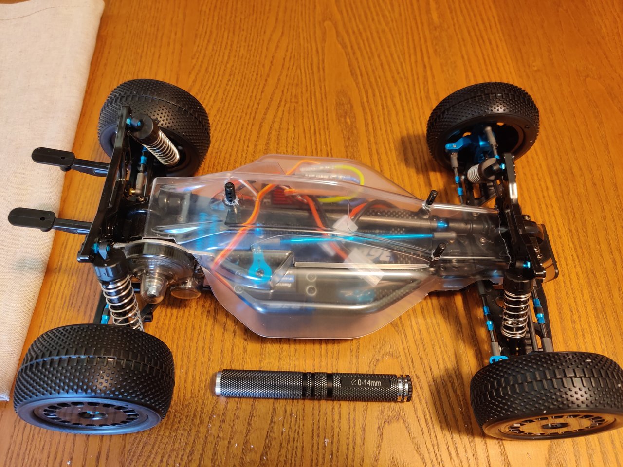

I also finally reamed the holes for my Deep Impact body and did a test fitting. I need to find a way to make it sit a little lower. There's not much space is there... :

Just now, Fruitfly01 said:
I like the clear gearbox cover.  Where did you get that?
Snatched it off eBay. It came as a clear parts tree with spoiler stands (not shown) and front/rear bumpers. It was around 15 USD shipped if I recall.
I thought it was a lexan after matket part from a third party.  It looks neat.  I'll be keeping a look out for one.

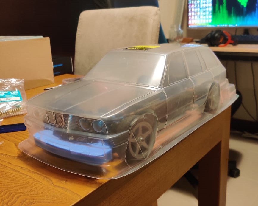

There will be a ready-made precut Lambo body for bashing, but THIS will be the final display body:
Whats-App-Image-2020-07-11-at-02-44-36a.
An homage to the bmw e30 touring I once had and modded the crap out of. I sold it in 2005, and I still miss it.

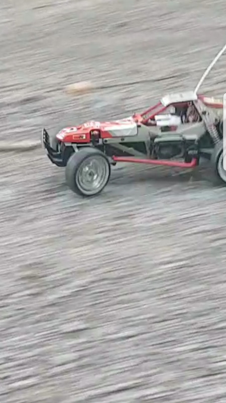

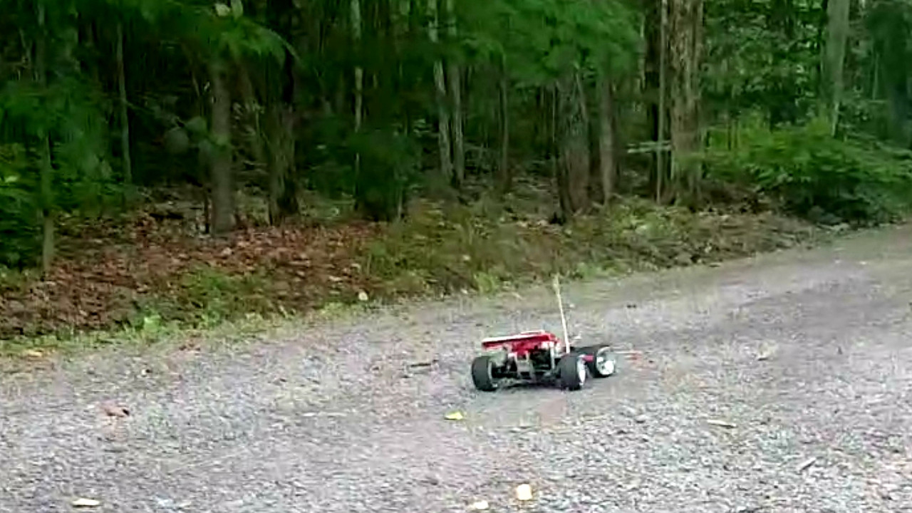

Today I eventually ran my only full time shelfer left. I took it easy on it as it's delicate and vintage to the last screw, it felt a bit like walking on ice but it was good to finally scratch the itch! Hear the chain driven 4wd, see it in action. Like all Marui buggies, I find the Samurai truly gorgeous. It sweats '80s from every pore
Fortunately, no damage done.
That does look good
