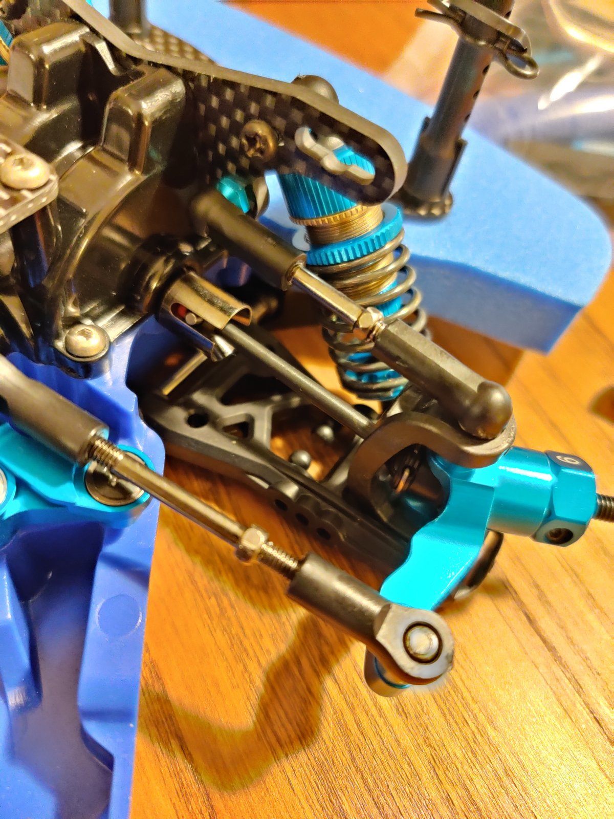

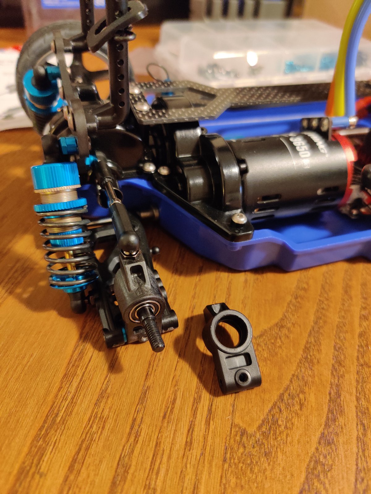

Finally swapped out the plastic rear upper wishbones replaced with the 'hop Up' Turnbuckle set...much cleaner look plus whilst I was in their swapped out the GPM racing Alloy dogbone drive shafts really didn't like them 😬 probably end up with 'ball diff' set up in the future 😳 oh dogbones are now on eBay

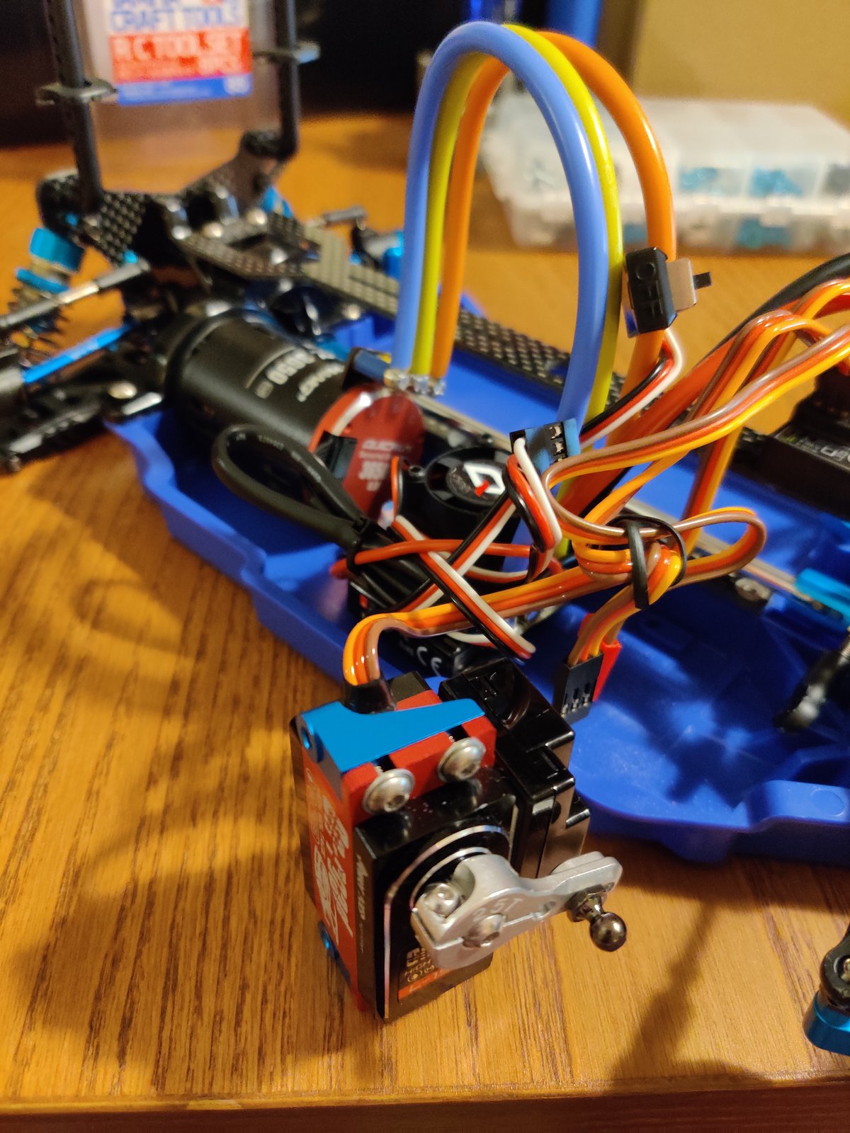

Converted the TBLE-02S ESC to LiPo cut-off voltage. Changed the 33kOhm to 47kOhm. So i got a cut-off voltage of 6.4 Volts.
Needs some good equipment, but is much nicer than putting in an additional resistor.
