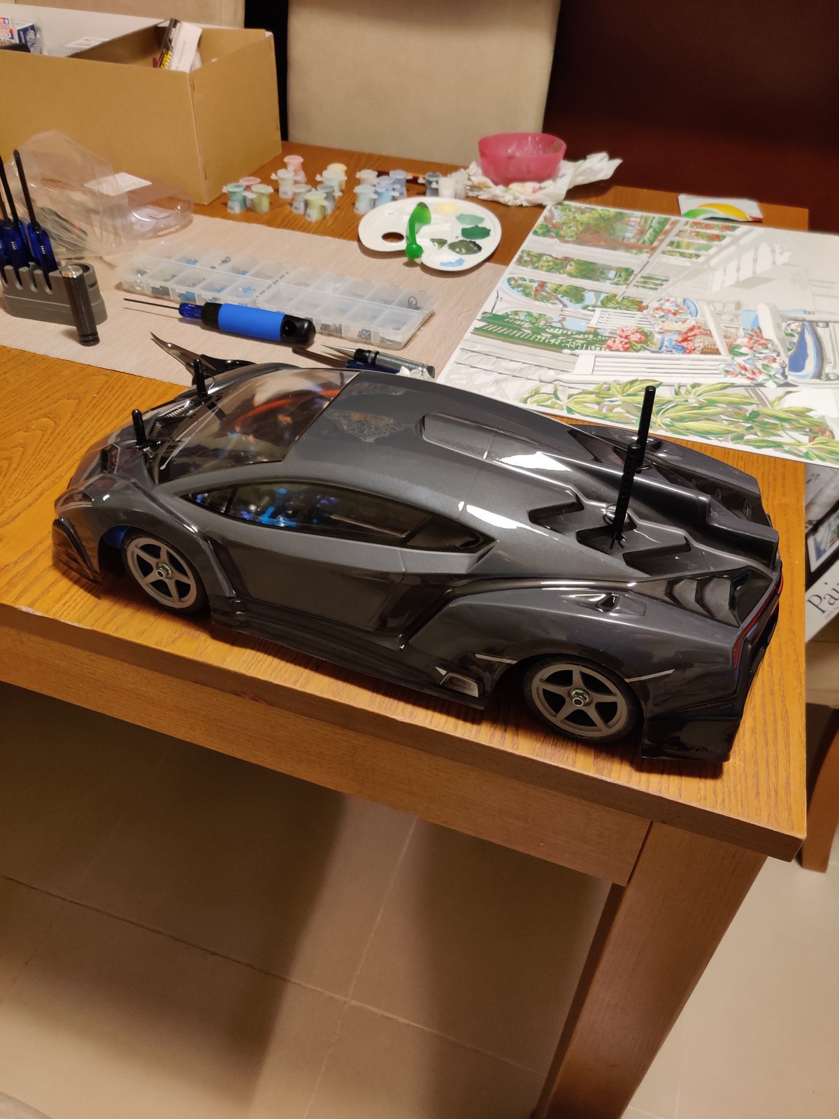

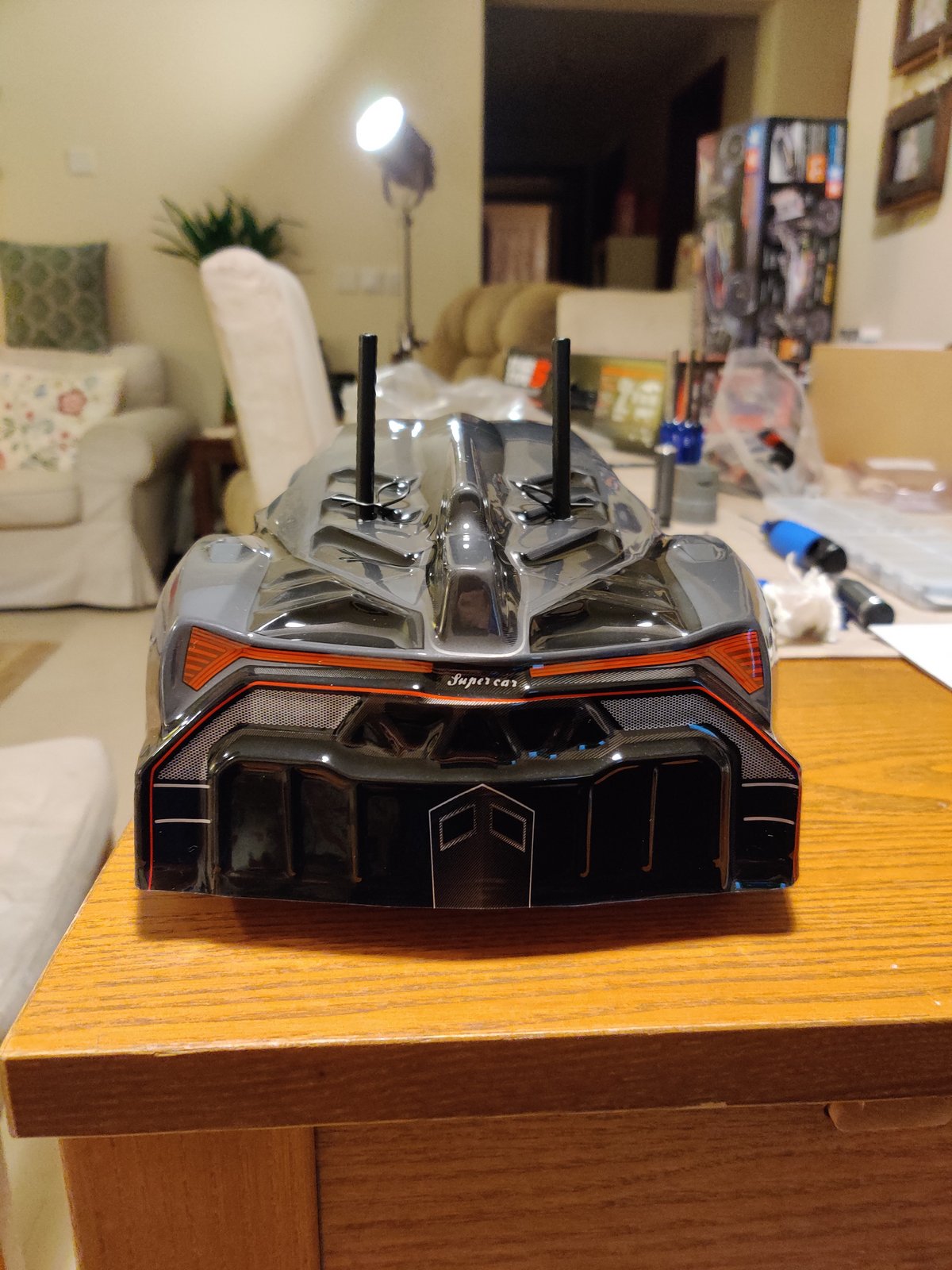

I botched the bodypost holes on my 'practice' prepainted chinese shell for the TT02S. I'd feel bad if the body wasn't so hopelessly UGLY :lol::lol:
BEHOLD:
I got to run the TT02S finally and test the handling as well as the gyro. I went to a deserted (but unfortunately somewhat dusty) road and put it through its paces. The car handles GREAT. Holds a solid straight line and can be kicked into controlled power oversteer thanks to the gyro doing its thing. 15 minutes into the run, the transmission started barking like a rabid dog, so I lifted it and found out that the driveline had binded. I later pulled it apart to find the pinion gear grub screw had worked itself loose and chewed up a little of the pinion (nothing major) as well as a tiny bit of the chassis inside the transmission housing (also no biggie).  Had my spur not been steel, I'd need a new spur right now lol.
Note to self: THREADLOCK THE PINION GRUB SCREW on your other builds before driving them!
I need to find a better way to properly locate bodypost holes on bodies, this is the second one I mess up. I used the "paint on the ends of the posts" method to make an imprint on the underside of the body, but since the rear posts are very long, the whole body ended up shifted 2-3mm forwards of the chassis when I was done :angry:

I take it that's supposed to be a lambo of some description?
Did it look better in the pics? :ph34r:
I had a similar issue with the posts on an M08 as they where long enough for a Double Decker bus body.
So with the body sitting on the uncut posts I measured from the top of the wheel to the top of the wheel arch and then minus about 10mm off that measurement.
I then cut the calculated measurement of the posts so it would be sitting closer to where it needed to be, marked the posts with a sharpie (unpainted body) drilled the holes and it was about right. I’ll probably trim a tad more off the posts yet to tidy them up.

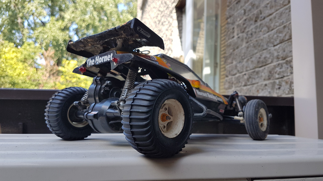

The Hornet's got new shoes on, it's all freshened up and ready to go on the road trip! I'm excited to try these Padlatrak tires on the beach (if I find one) as it's the first time I have them on.
It feels good to bring a loyal RC car with us on vacation:lol:

More scoops than an ice cream parlour! :ph34r:
