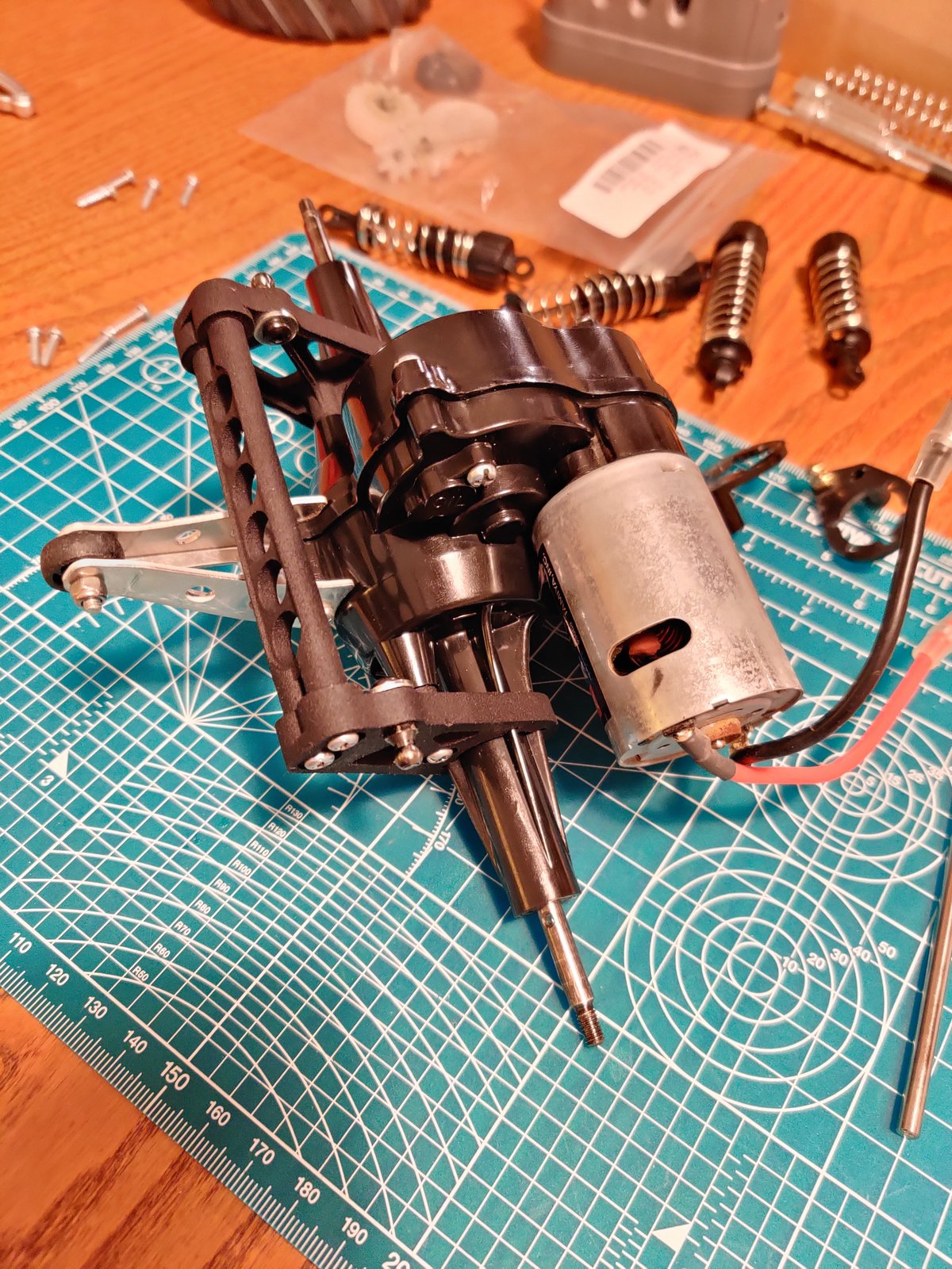

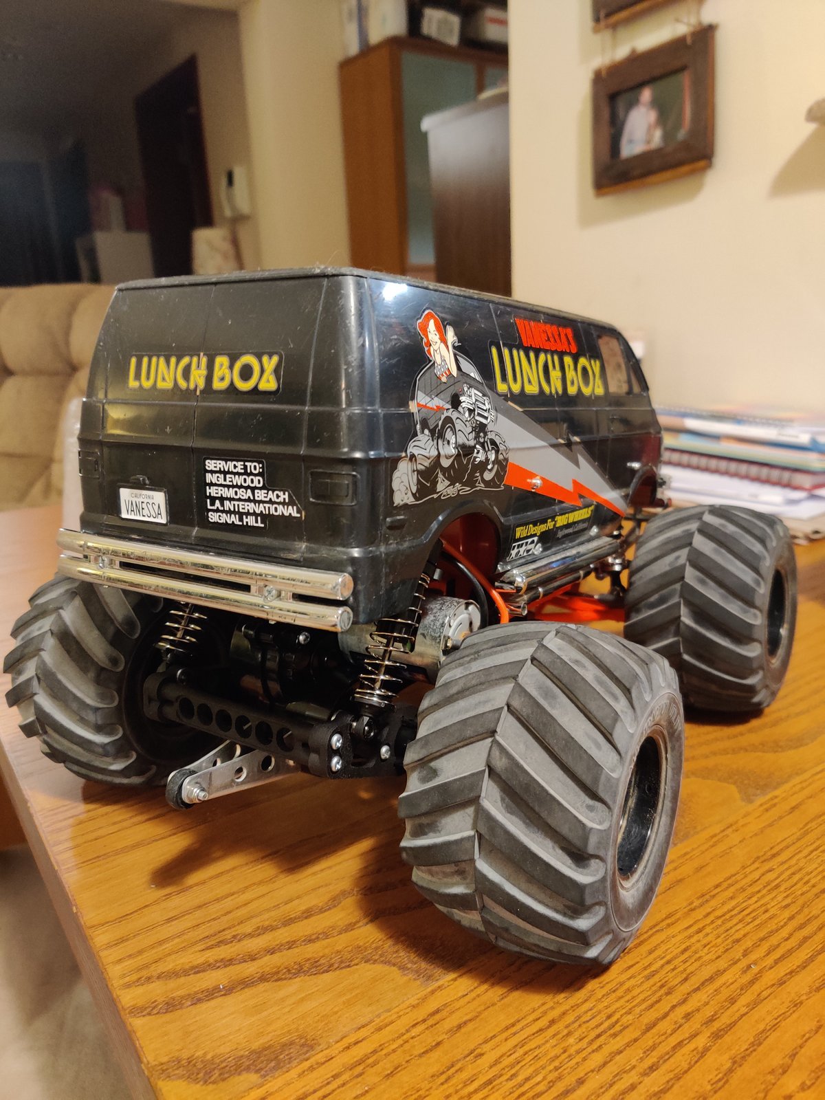

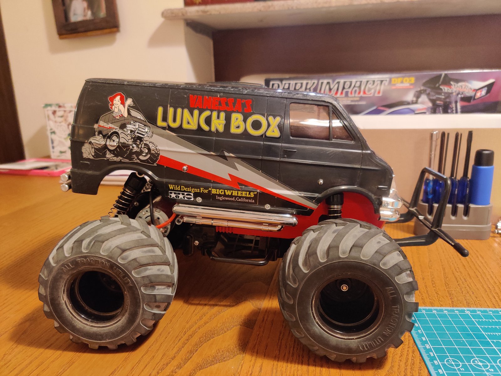

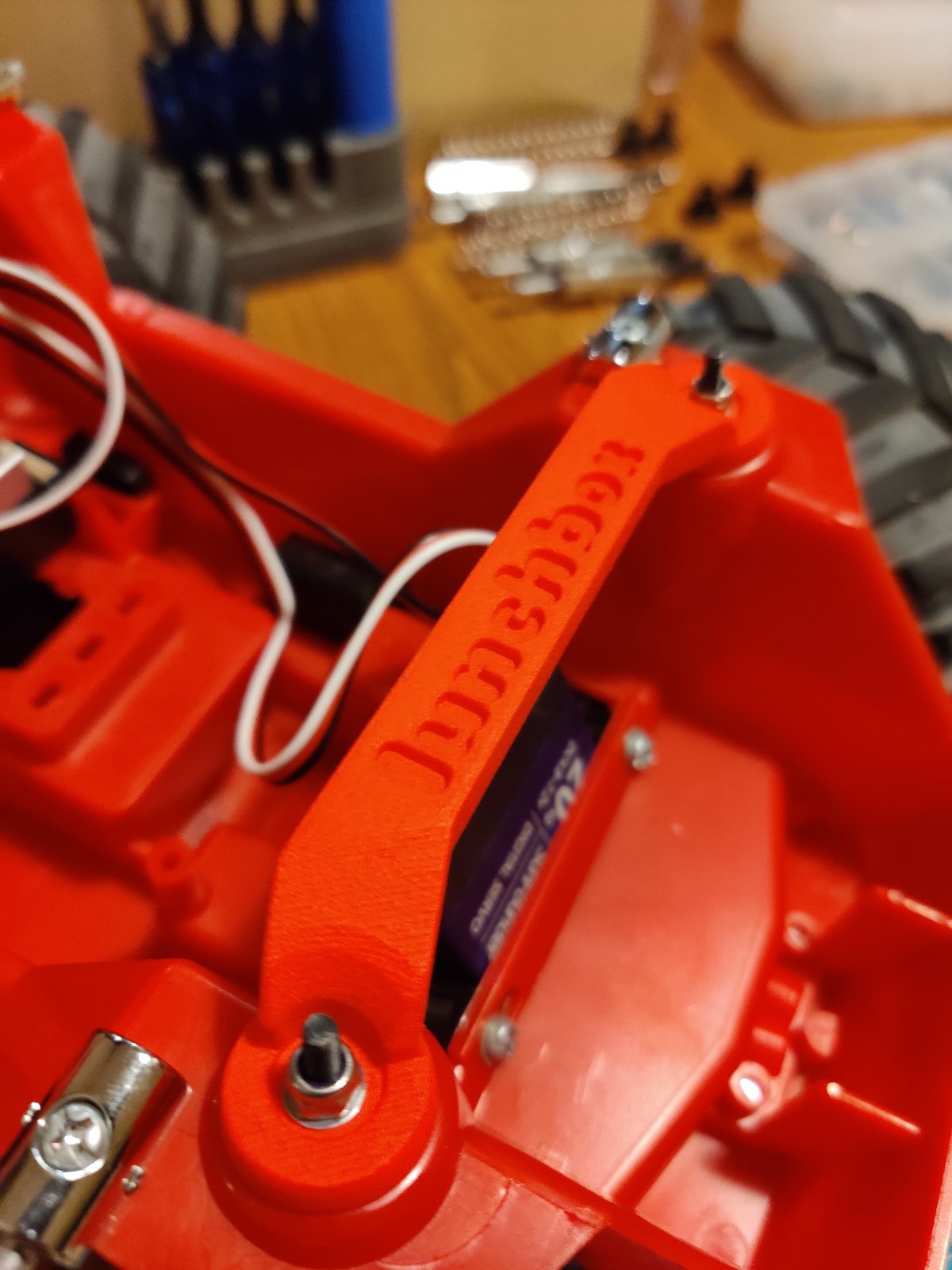

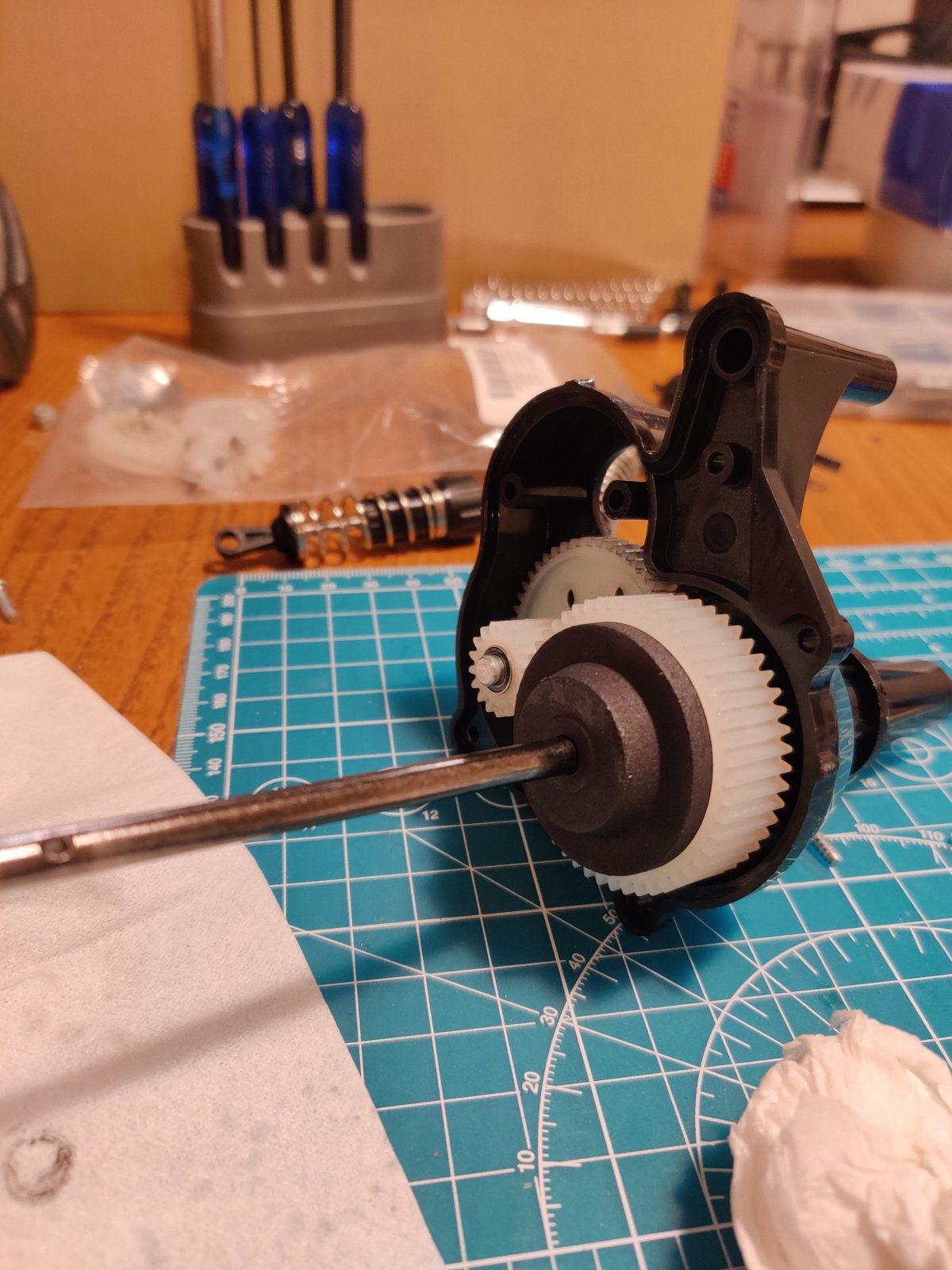

Today was Lunchbox day for me. I previously installed the wide-track double wishbone front suspension on it, as well as the little brace for the rear gearbox brackets to prevent suspension slap upon acceleration. Today I put in the Ampro diff locker, the Ampro rear suspension mount that puts some distance between the motor and the dampers, a 3d-printed front suspension brace, and (FINALLY) oil-filled shocks! The fronts are from the DF03 and rears are the proper size shocks for the Lunchbox, so it ended up tilted forwards a noticeable amount. I will later swap the fronts for standard 80mm ones like the rear, but here it is for now:
Diff locker:
Rear suspension mount:
Front brace:
Final result:

Looks great. I do love driving my Lunchbox. However, I really would have thought someone would have come up with a sealed diff for it by now. (unless I've missed one)

I agree looks great, I’ll be interested to know how you get on with the mods.
I have an LB to build, keep and run sometime soon hopefully.
I genuinely don’t think there is a better.value, more versatile model than the LB. Lots of strong contenders but for me if I had to sell all my Tamiya the LB would the one to stay,

I love my LB, but I wouldn't bother doing too much to the front end - its front wheels are always pointing to the sky! I highly recommend the GPM Racing wheelie bar (a quality bit of kit).
I'm going to investigate (again) the 5th shock mod though, those tiny bits of wire have started to give up...
I'm actually hoping that the forward-pointing stance mine now has will help alleviate its propensity to hop onto 2 wheels, we will see when I try it out.
The GPM wheelie bar has already been ordered a while ago and it's on the way. In red of course :lol:
I chose the Ampro gearbox brace instead of the 5th shock or fishing line mod; it's probably the most elegant solution given that it's practically invisible. It's given me no trouble at all so far.

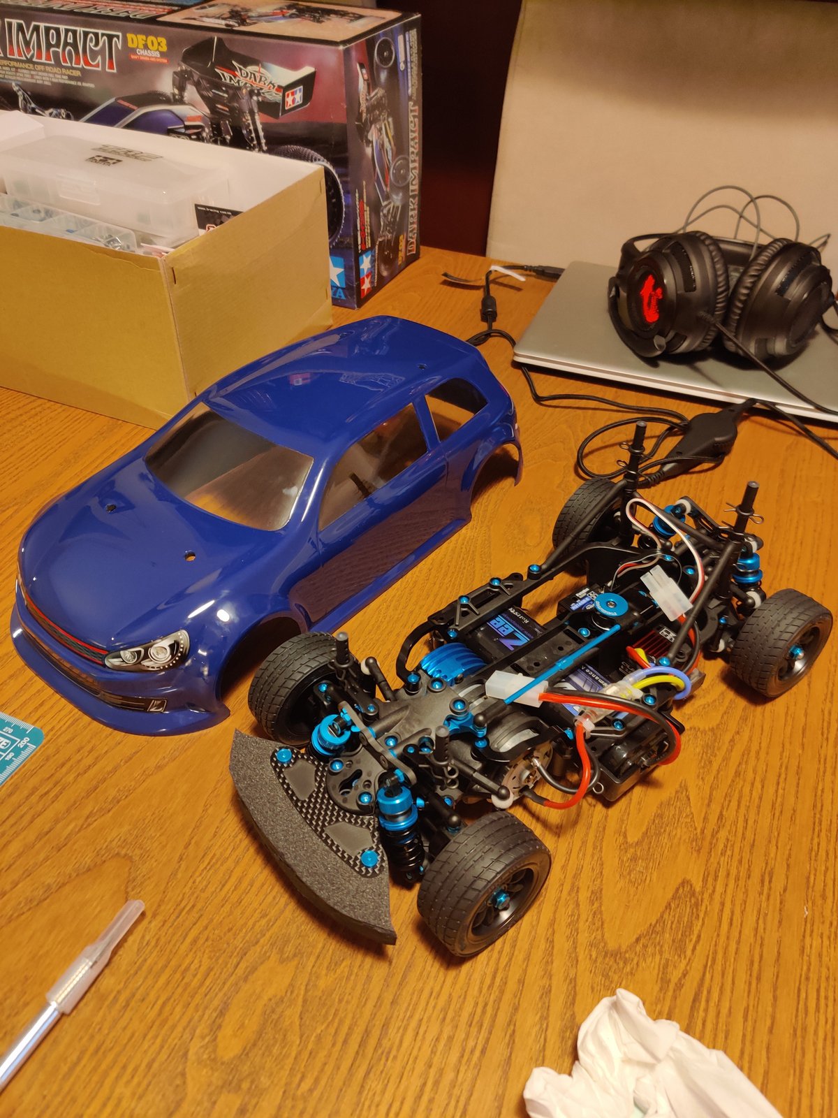

Just finished getting the M07 ready for the postal challenge. All it needed were a few light stickers and now it's done. Time to put the first battle scars on this baby :(
Yeah... I'm not a fan of plastering "GTI" and "Titan Racing" all over the body, so I'm keeping it simple.
