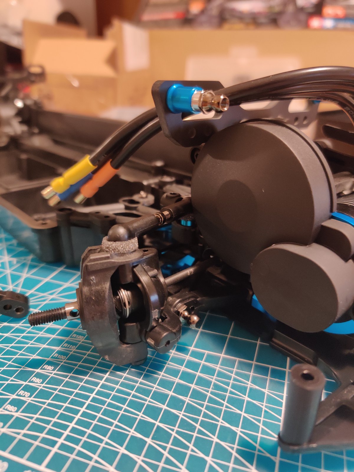

I got a few parts for the XV01LDS today, so I went straight to work installing them.
Started with the carbon reinforced front/rear hubs, and the extra pair of double-cardan shafts I had lying around (... no, don't ask lol). Since DCJs allow for a better steering angle, I removed the two screws on the castor blocks that limit steering travel:

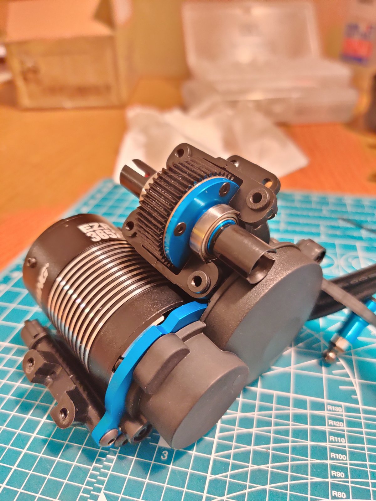

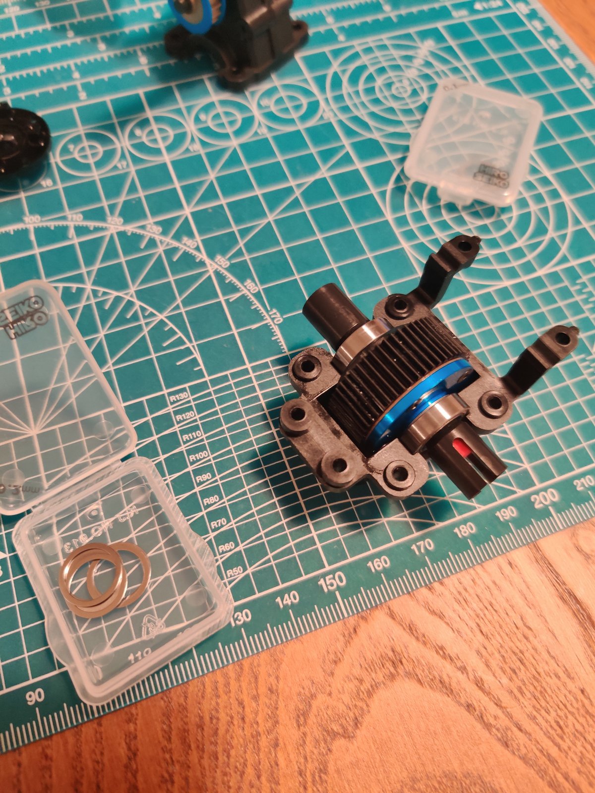

Then I went to work on the aluminum diff covers, and while I was in there I swapped the kit diff fluid with 7.5k in the rear and 30k in the front:
I was very surprised that the diffs developed noticeable slop with the aluminum covers, and both of them had the little screws contacting the side of the diff housing, which was unacceptable of course. The rear diff took 3 0.2mm shims and the front took 2 0.2mm shims, and all was well again.

Brother - that looks SAHWEET!!!  Glad you got the Diff sorted. 👍  I'm surprised too. Aluminum Housings are supposed to ELIMINATE slop - not create it!
