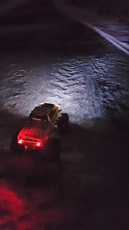

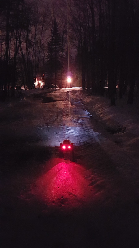

I'd want this for when I have go out late at night to inspect strange and creepy things roaming around the house
I'm not gonna lie, it's enabled me to walk along paths and trails I would have been too chicken to go on it the pitch black before which is handy as it starts getting dark at 4PM now lol.
Given a few other people a ****ht though lol. Oh well, what are you doing walking abound muddy paths in the pitch black with no torch etc in the first place? NO YOU'RE THE WEIRDO!!!

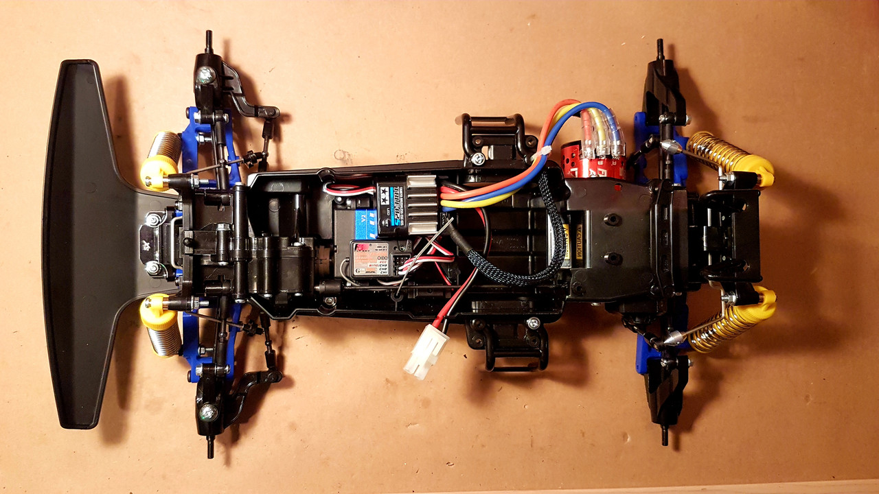

On another note, I just finished the Terra Scorcher chassis today. With all the -by now well known- issues regarding the re re version I can't really say that it was smooth sailing, but I still enjoyed the build very mucb. At least it seems that by now the car is good to go in terms of noise/mesh/gear binding, although I'll have to wait to run it to be sure, of course... but I'm positive the extra work done will pay off.
@mud4fun I've used the measurements you've endorsed a while ago for steering and servo arms ;)
The replacement tire should be in my mailbox anyday now, it would feel kinda nice to be able to mount the wheels!!
This is it so far. Not much different from stock aside for a 17.5 sensored brushless, alloy A5 part and E clips+shafts in place of screwpins for the suspension arms. It will differ a little more from box art aesthetically.
Next will be body cutting/painting, driver, decals, final but essential last OCD details, and it'll be done. Part of me wants to hold back, because building a kit is so much fun and fulfilling and I don't want it to end!

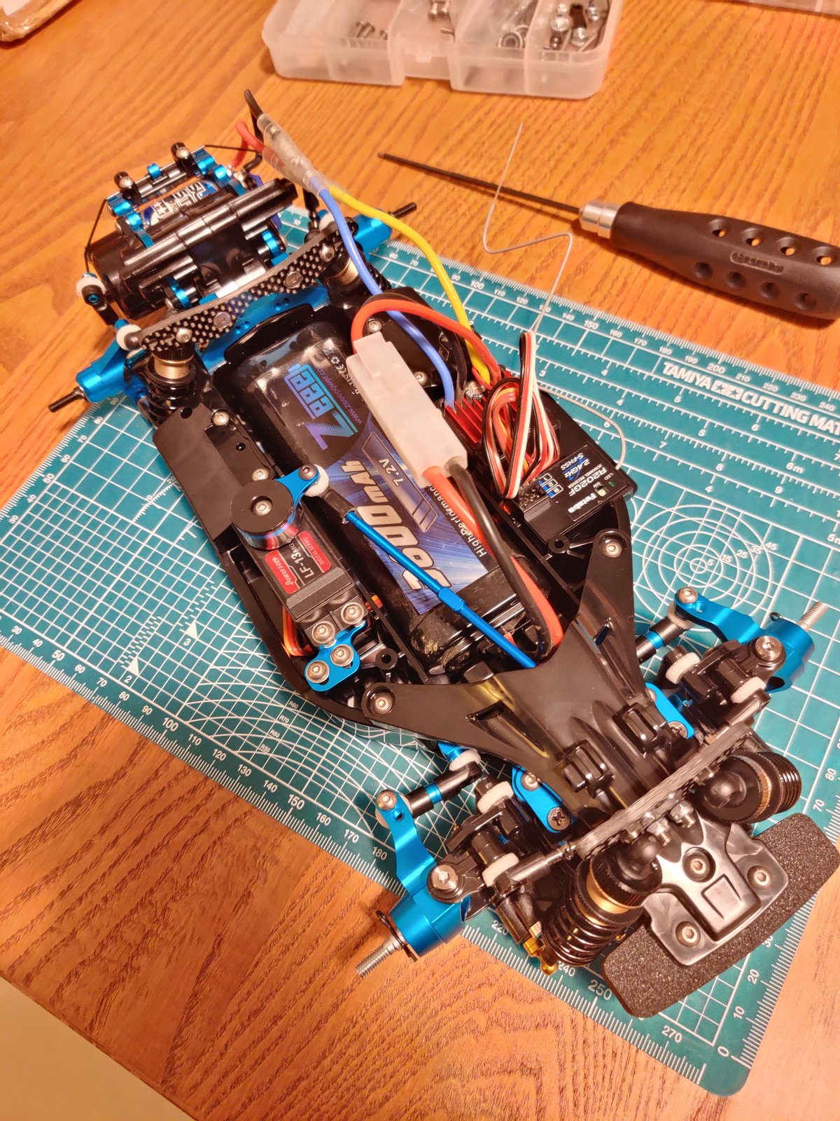

I finally got to a point on the M-bling 06 to power it up and check that everything runs. Pleased to report that it does.
The 38-tooth oil-filled diff is very smooth, better than the 39-tooth gear unit that comes stock. I don't know what black magic was done to have it lose a tooth and still maintain good mesh.
The servo is not staying. While strong, it is not nearly fast enough to counter-steer when the inevitable stepping out of the rear occurs with over-spirited driving.
I'm planning to put in a gyro, but I'm at a loss as to where I'd place it. It might eventually have to end up on top of the carbon battery holder (not pictured).
Not sure whether to cannibalize the boxster body from my M02 and put it on here along with the 32mm wide rear wheels/ 26mm front TC wheels. Thoughts?
The front carbon reinforced lower suspension arms have unused screw hole tabs on the bottom that are pretty low to the ground; no idea how I'm going to go about grinding them off without a dremel tool of some sort.

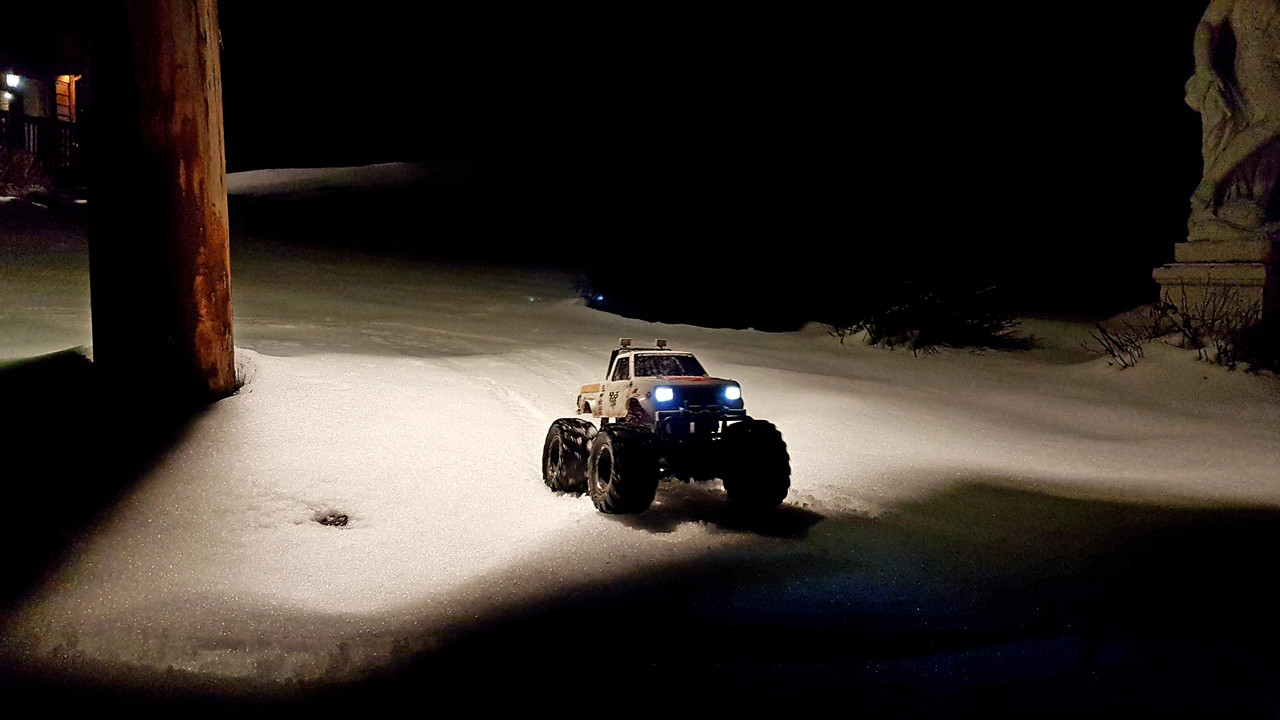

2 hours ago, Saito2 said:
. I'm honestly getting great enjoyment out of it and my Big Boss.
I'm so glad you are running your Big Boss now 😃

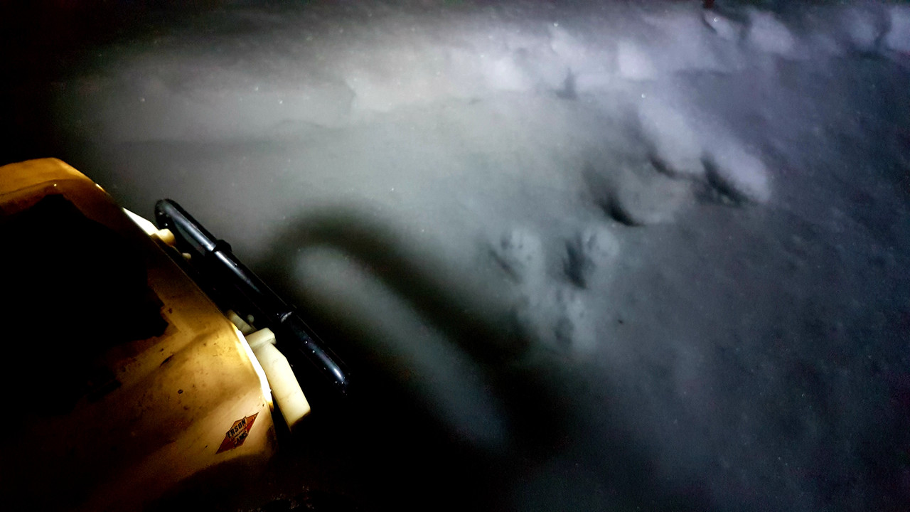

The same happens here. Took the first walk of the season in the snowy woods this evening, with the loyal Big Boss lighting the way.
There were a few signs of life, like these cute squirrel prints20201128-185215.jpg
and those very familiar tire prints: exactly the same, just 10 times bigger ^_^
