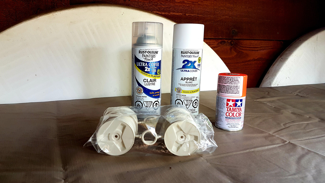

I did as follows:
-washed/rinsed/dried the wheels
-primed with white primer (I was going to do Tamiya grey primer and then white coat, but I had a white primer hanging around and knowing the brand is good I decided to go for it to save some coats and gain less thickness)
-sprayed with Tamiya fluorescent orange PS paint. I went with PS so I could use the can for both the wheels and some details on the body shell later. It it said to be aggressive on certain plastics which is absolutely true, however the risk is minimized when priming, especially on something thicker and sturdier like wheels. I've done it before and it won't be an issue if you spray gradually and sparingly on a previously primed surface
-top coated with transparent glossy sealant.
I've done two coats of each step, exept for the front part of the wheels which got an extra coat to make it just a bit darker.
I like how they came out. They will chip a little with the use of course, but I hope nothing major: I've painted the original wheels of my Manta Ray the exact same way just under two years ago, and I've used them a lot with barely any happening only from gravel. It's worth it if, like in my case you want the original wheel just in different color :)
Edit: I found a picture of the pruducts before I started
