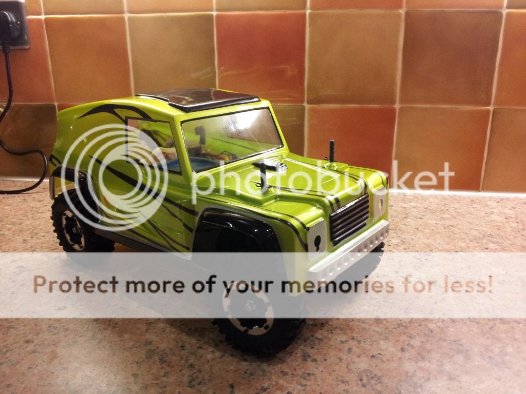

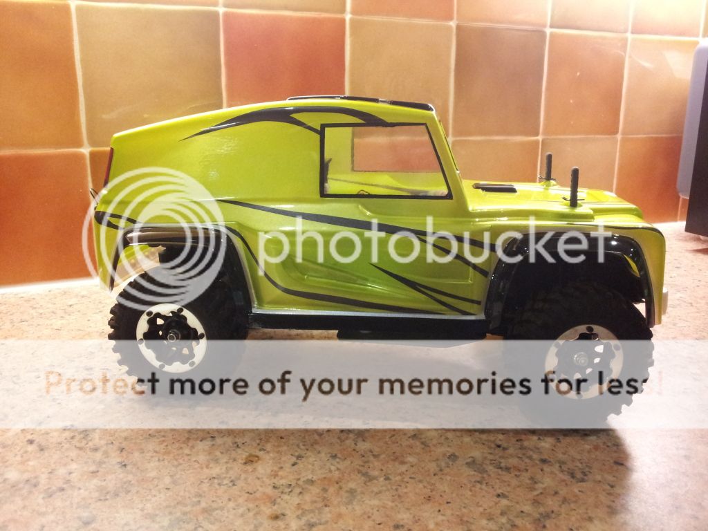

Well actually it was yesterday but I spent a lot of hours tinkering around putting my Christmas gift together. :D
Looks awesome! Just wish it were a different color! Haha.... I just did an FJ40 shell in dark blue with those same wheels/tires... Guess great minds think alike!
I was noticing your CV joint into your rear axle looks very "angled", Mine is much straighter than that with the stock links. Maybe it's the photo, or maybe the links are on wrong making the axle rotate down?
EDIT: I see what it is... the small plates that the bottom links screw to (on the chassis, not axle) are backwards. You can see the mounting point is somewhat off center. You have yours mounted with it more towards the back of the truck. They need to be reversed to be towards the front of the truck. This will rotate your axle to point more inline with the drive shaft, straightening your CV joint.

OH yeah so I did… I must have put them back in the wrong way when I was doing the 4 link as I know I have them right the first time (had to take it of 2 times. don’t ask why long story).
*Edit* all fixed now
I did wonder why it was point down like that good pick up though. And yeah still looking at a roof rack and some goodies to go in it.

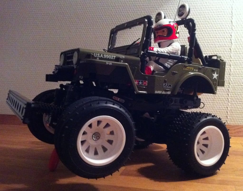

I know this may get me expelled from the site, but I had to try out a set of Stadium Blitzer wheels on the Willy:
I think it looks quite nice, and lowering the CoG didn't hurt the handling either....

Looks good and now you have the choice of all the tires that fit the blitzer wheels . proline sling shots are just awesum on sand .

I like that, does the tyre size reduction affect gearing much? Can you go to a bigger pinion? I think one of these is gonna be my next purchase.
The circumference of the original WW wheels are 33,8cm, and the Stadiums are 29,8, so around 10% smaller. This would be almost exactly eliminated by using a 20T pinion instead of the stock 18T pinion.

OK - interesting. Thank you!
Great info, cheers
