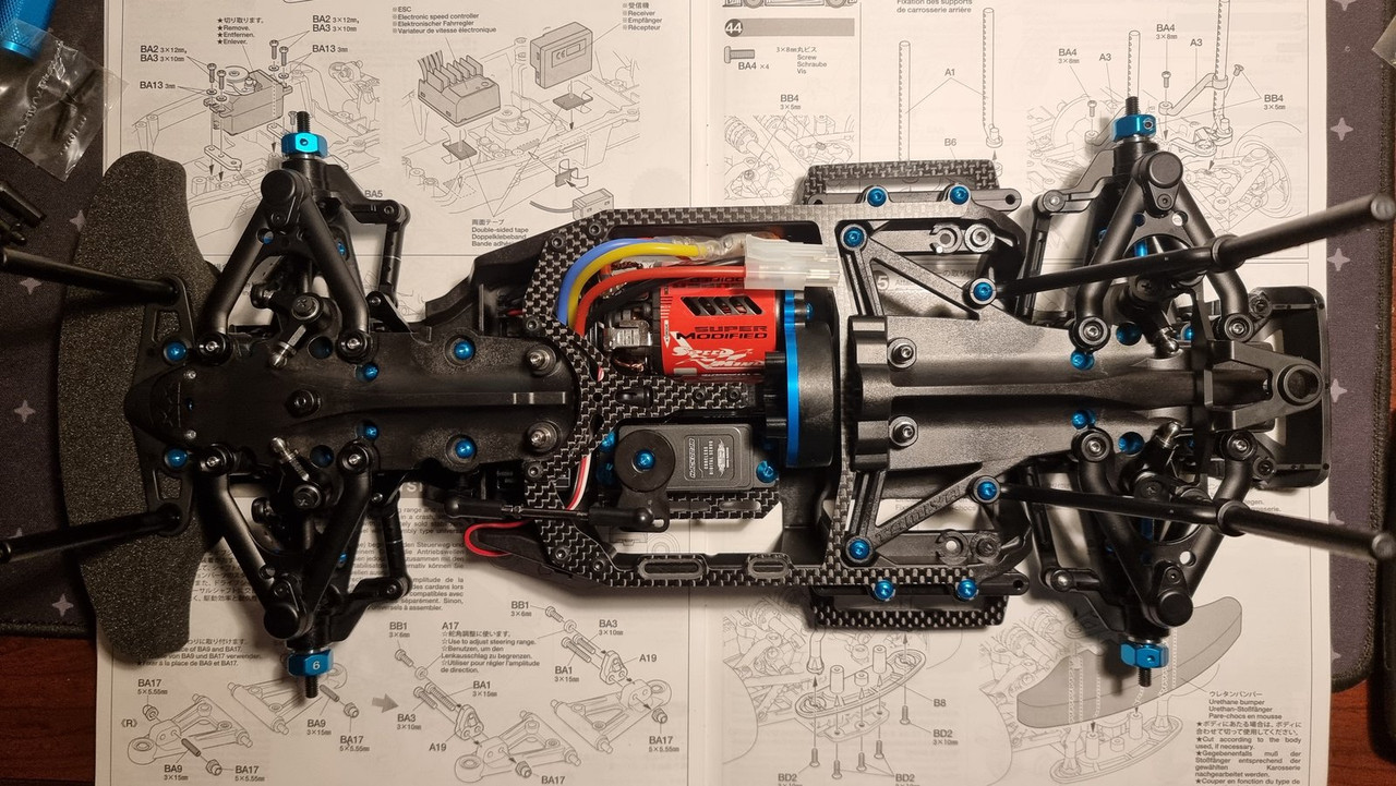

Working on the TC01. I had to stop at the dampers because I have encountered some hop-up clashing. The YR big-bore dampers only come with 5.8mm ends, and my fancy T-works titanium ball ends are the standard Tamiya 5mm size. I am not removing the Ti balls, so I'll just have to find some nice dampers that fit properly.
Also, I got Eagle Racing alu suspension arms and knuckles, which I found completely unusable. First, the lower arms don't hold the droop screws. Second, the upper arms replace the Ti balls I installed with captured balls of their own, so no. Finally, the knuckles rub against the CVD circlip thingies that hold the CVD shafts together, so also no. I just threw the whole Eagle Racing set away.
Other than that, pretty nice build so far lol. I've got it set up to accept a touring car body, because I'm not touching the formula E body with a 10-foot pole; too much work and I WILL mess it up.
