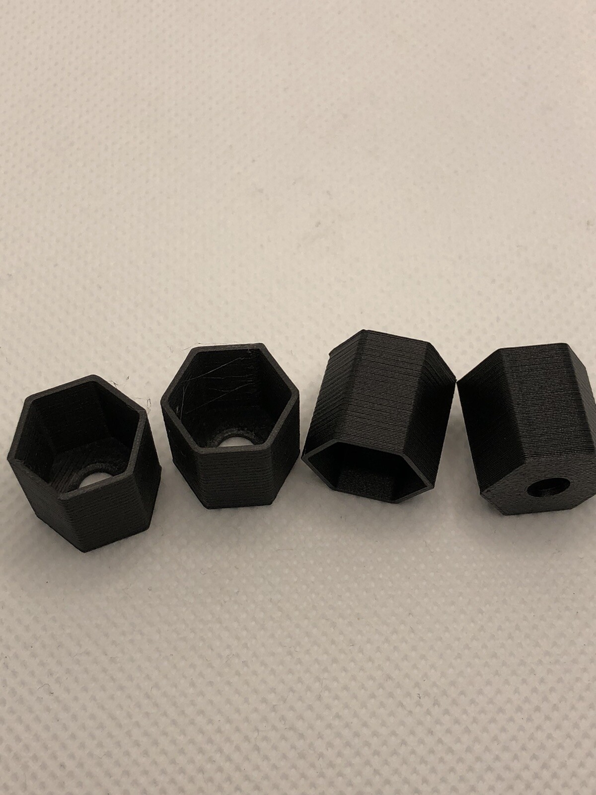

I used two 7 to 12 mm 3D printed hex converters on eBay
Straight onto the rear axle, going into a GF01 wheel. They widen the track with by about 5 cm, mainly due to the different offset of the two wheels.
Front was trickier. When using the QD wheels the front track width was no far too short. I used an 15 mm long 8mm OD  x 5mm ID aluminium spacer on the front axle, with 12 mm bearing inside the 12mm hex of the wheel and a nut on the outside to stop the wheel popping off. I find a 12x5 bearing works very well in a 12 mm hex wheel, with no other mods needed.
