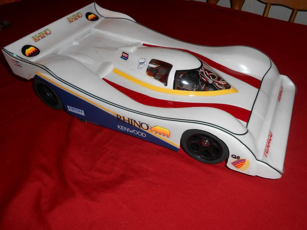

I forgot to mention the special features of the 10L. There are no mounting holes for the battery or servo and everything has to be servo taped in place, The front wheels are E clipped on. The rears are a square 4 bolt pattern and can't be changed. A Tamiya wrench can be laid flat and used to keep the wheels off the ground or a pencil will do. My favorite is the wheelbase, 260 x 235. If it were a little shorter or wider I could mount the body sideways to improve it's looks. The only bit of the suspension with any travel has to all come off to get a motor in it. That's as if the lock collar front steering wasn't enough to prove this to be the racer it was intended to be. :o

Its a great example Dave - yes the wheelbase is short but with the right racing body with the big front and rear overhanges the relative width to length issue will be resolved. Keeping it pointed the right way with that short wheelbase may be a different matter, BIG rear wing required :D

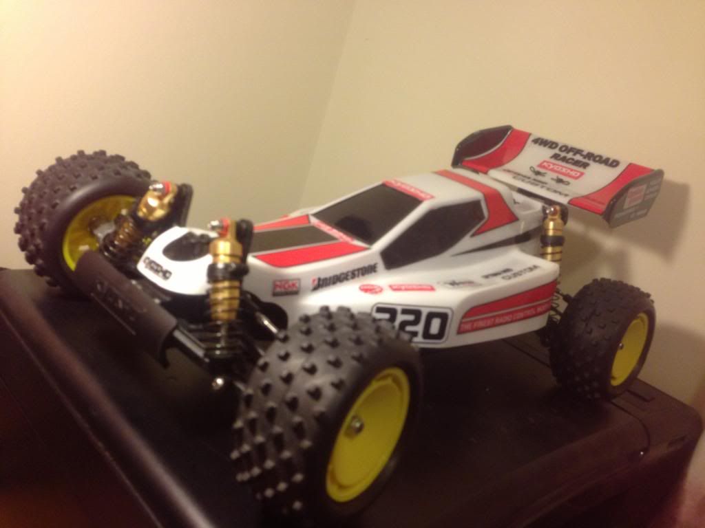

decalled the SWB Optima Mid project (runner)..

The body is another plus. I have the new Protoform body for it from Tower. It's the one and only 235mm body I could find so like it or not isn't an option if I want a body for it.

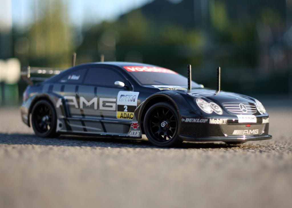

Bought some TS and PS paint in Modelzone, then shot a few pics of projects finished this week..
TL-01 based CLK-DTM 2002
and to wind Shaun up, another pic of the Opti Mid SWB :P :P

It does indeed! Is this a runner or shelfer?
The chassis doesn't look to have ever been run before so the lap around the living room it's already done is all it'll be run. I'll hang it on the wall for a bit and then sell or trade it off. It was kinda forced on me to see if I could finish it off. The wheels for it would have been a task if I didn't just happen to have a set. It still needs the body posts but I'm sure I have them somewhere

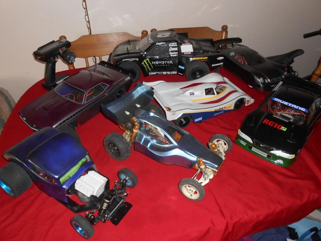

I took this picture to kind of freeze the moment in time. I've got some body mounts to do and they are all for AEs so I gathered them all together to get a list together of what I needed.
This is all of that brand that I have right now, there used to be quite a few more repeats but I decided to keep only the ones I wanted.

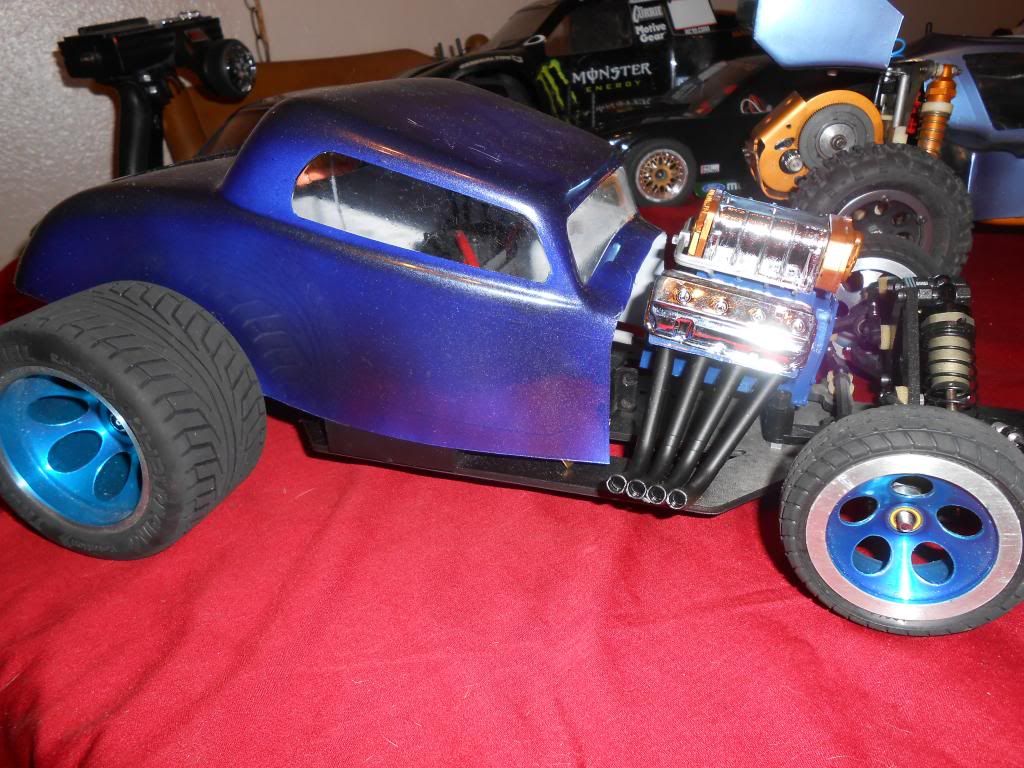

I made some progress on this really slow going project. There's a lot that all has to fit together but you can kinda see the direction I'm going.DSCN0311.jpg

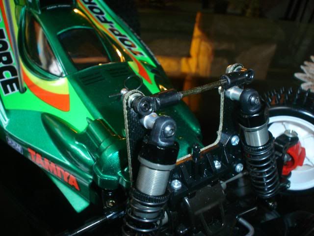

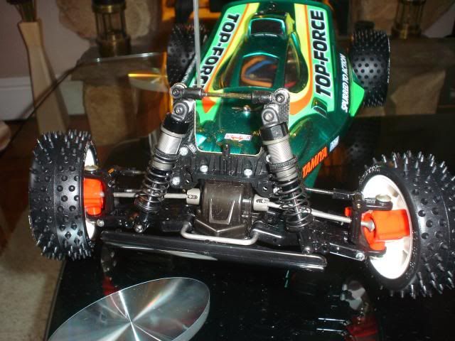

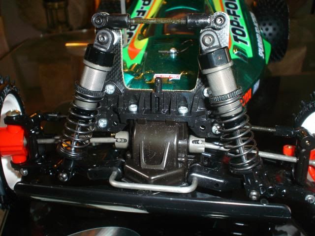

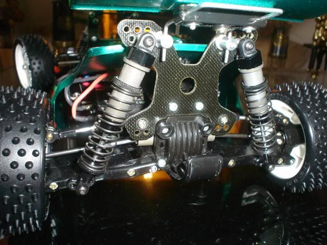

front end strut brace and uprated shocks on the top force , tried it and even with the cva,s as soft as they could go with oil as thin as water they were still far too hard and slow, much softer now and superfast return from compression , front realy digs in on corners now , the strut brace stops the twist in the towers, shocks and strut brace fitted on ball studs, changed the rears to match , wanted to keep in the black theme so these don,t look too far away from the box set
