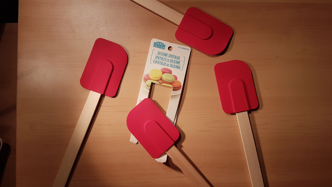

An official trip to the dollar store followed. While Ms. Ferruz was on the hunt for spooky Halloween stuff, I went straight to the kitchenware section, determined to find some raw material for the mud flaps. Tupperware lids and such was what I had in mind at first, but after some searching I returned home with something more suited to the cause:
I thought silicone would be a better choice than plastic, since my ultimate goal is to have mud flaps that actually work. Any extra flexibility is welcome.
Cutting and shaping the mud flaps out of those spatulas was fun, and didn't take long.

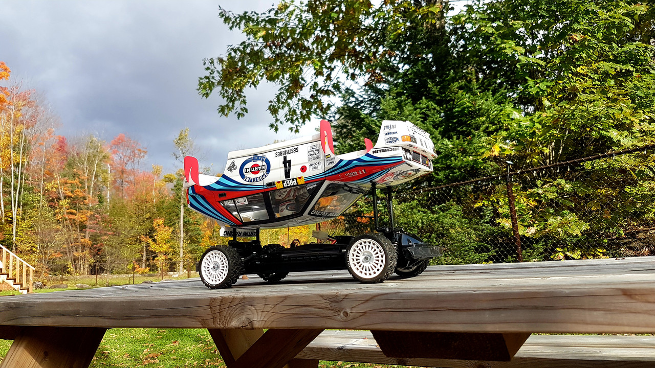

In order to fit all four flaps properly, I had to flip the shell. Fortunately the chassis doubled up as a perfect stand! It allowed for the antenna on the roof to stay clear while in reverse.

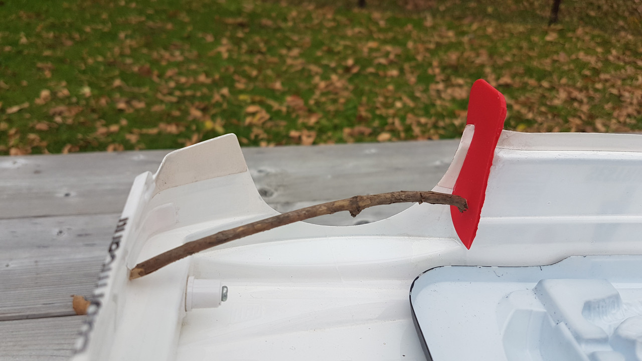

As for the adhesive, I went for super glue and Shoe-goo. A dab of super glue first to secure the mud flaps into place, followed by a good build up of Shoe goo behind them (done in three installments). Cutting edge technology was used to keep them in the right spot
Once dry, I squeezed an extra layer of super glue in whatever gaps were left and in between the silicone and the dried Shoe goo just for good measure, as I'm not sure the goo would stick well enough to that specific type of heat resistant silicone. This seems to have yelded good results: the flaps are installed, lower part flexes as it should and they feel firmly attached to the body, without putting too much strain on the lexan thanks to the extended surface in contact with the glue behind.

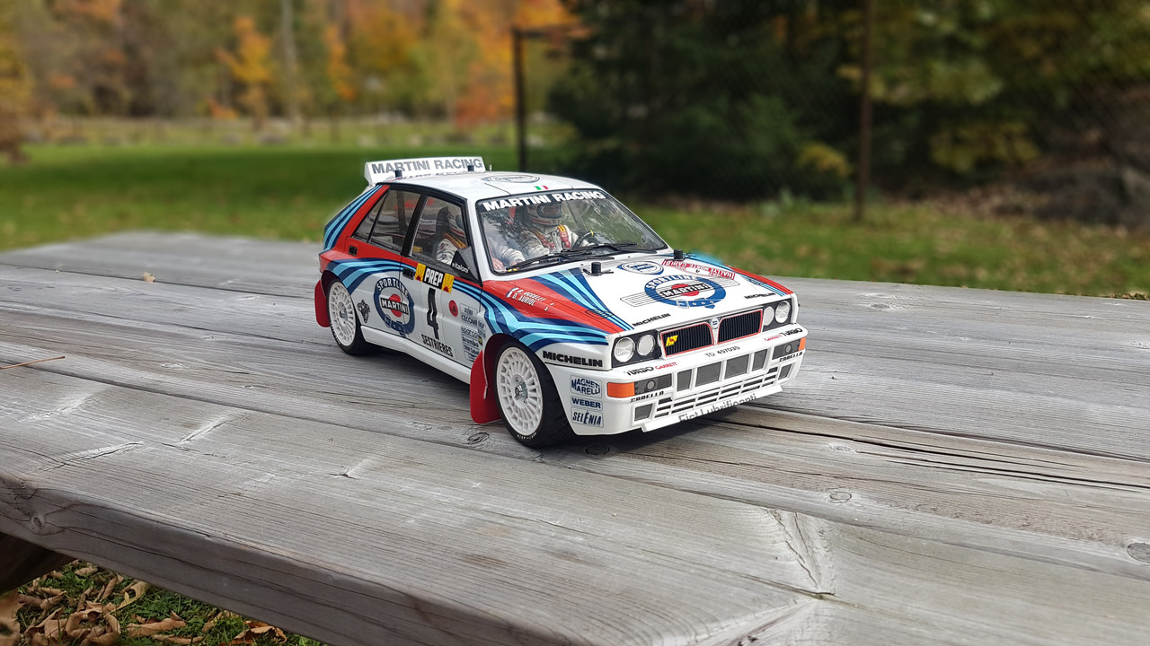

All done! Pleased wity the result. The front flaps sit a little low, but I like it. This configuration is for shelf duties, anyway: when running the car, I set the shell one hole up on the body posts, which will give that extra clearance. I am confident that they will work fine, I'll see, it should be fun to watch on a light layer of snow for sure...
While I was at it, I also added the HF badge to the front grille.
The official 1992 Delta that run the Monte Carlo rally didn't really have it, but neither was Occelli holding a Tamiya kit box in place of the race notes so I thought that'd be ok :D

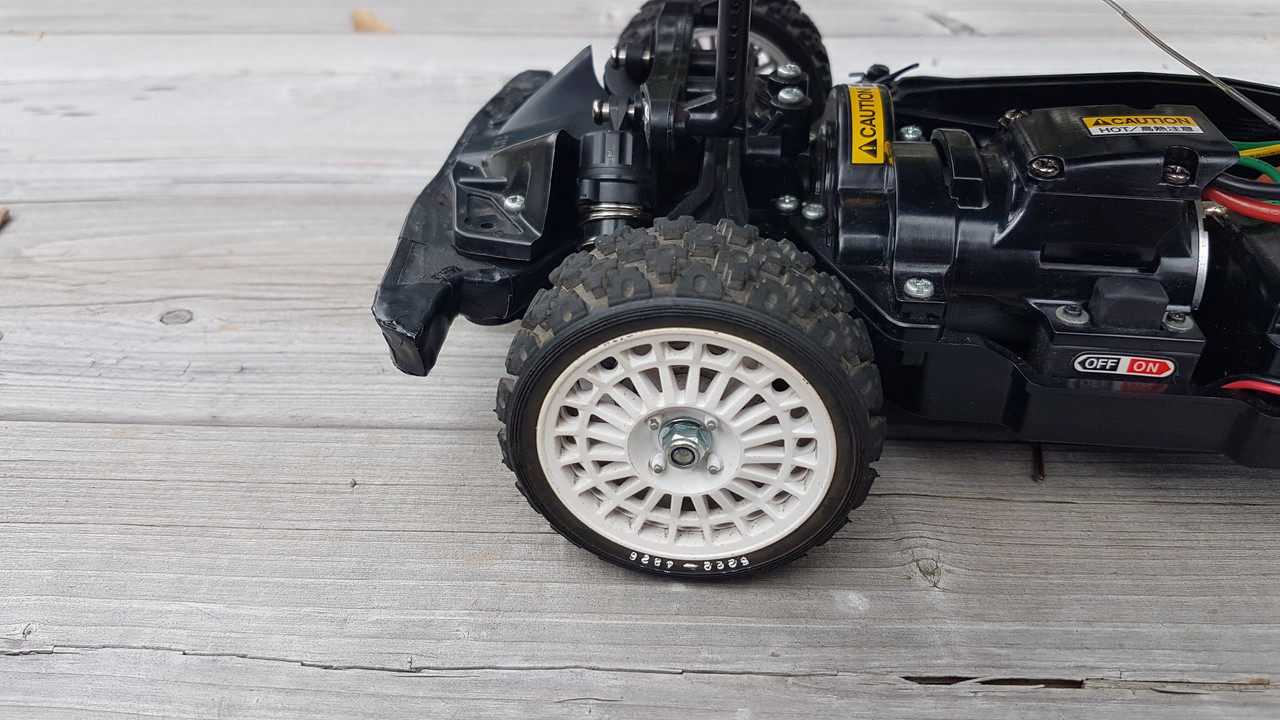

I also researched some 6 mm offset wheels with a design similar to the original rims, and ordered them along with a set of on road tires. That should finally give the Delta a wider track, which she needs like the air to breathe.
After that, the only thing left will be to address the elephant in the room -I mean, in the cockpit... the roll cage :ph34r:
Enjoying the view now.
