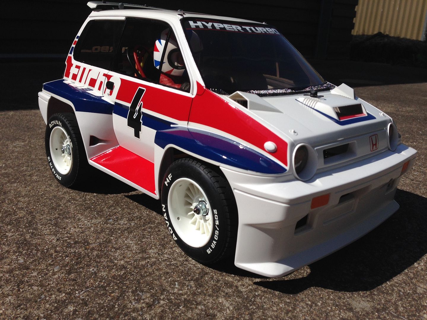

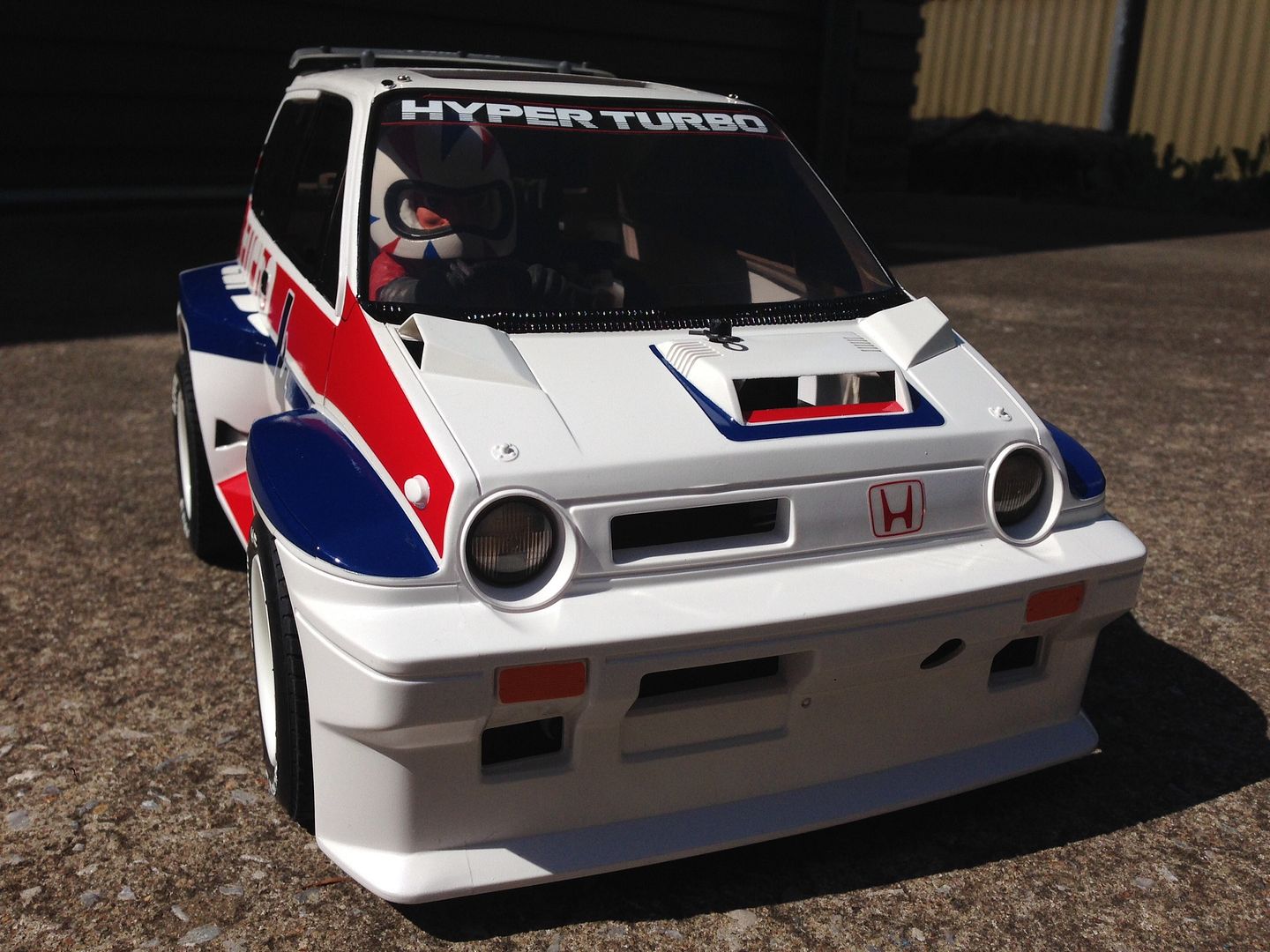

Finally finished my HCT, pearl white box art them, left the rear spoiler aluminium finish and spaced it up like I've seen others do, really happy with the result, a couple iPhone pics below
Amazing job mtbkym. Looks like it's finished to a really high standard. I've never thought about this kit before but it looks so cool and fun. I think I want one now. :D

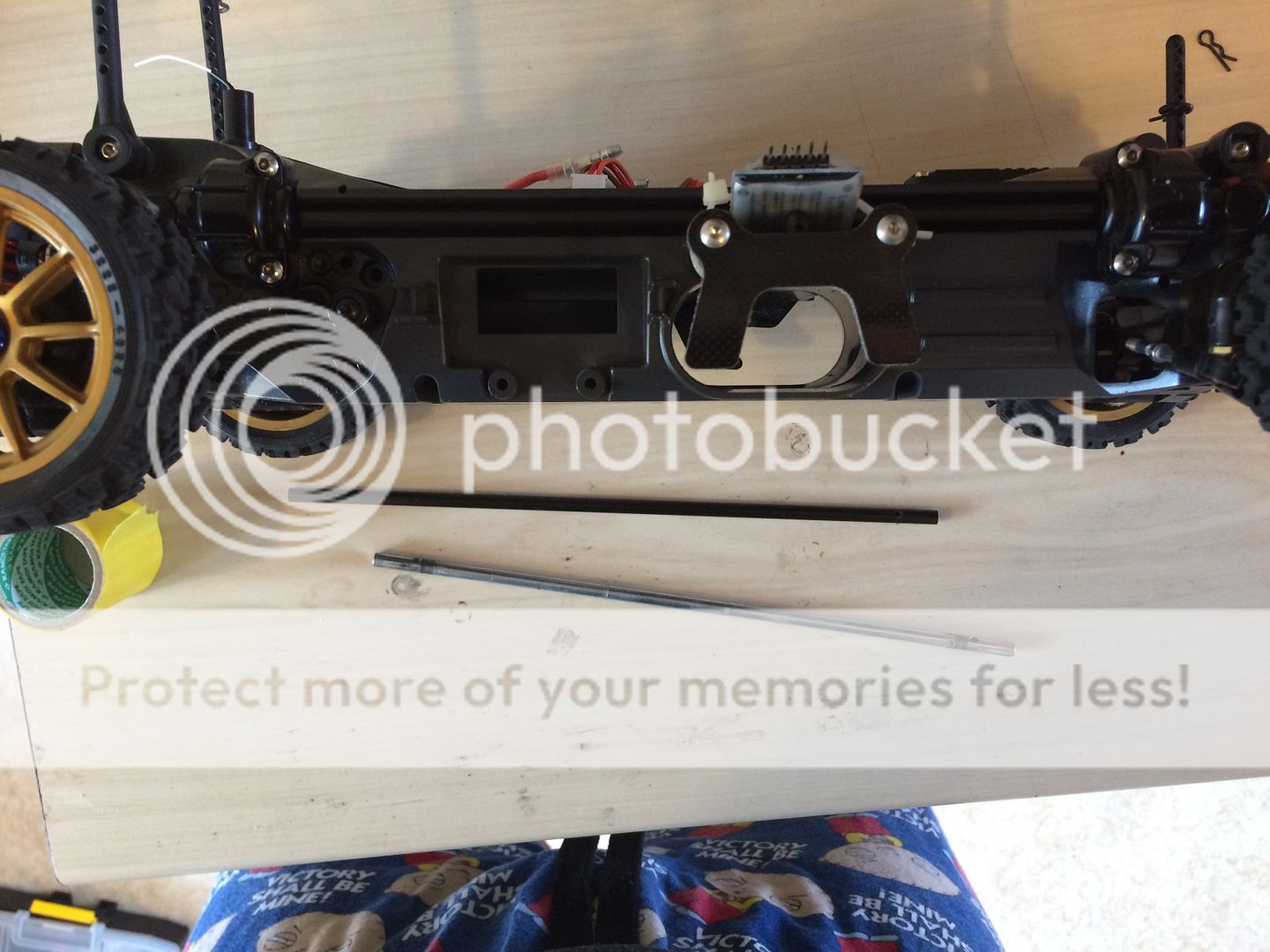

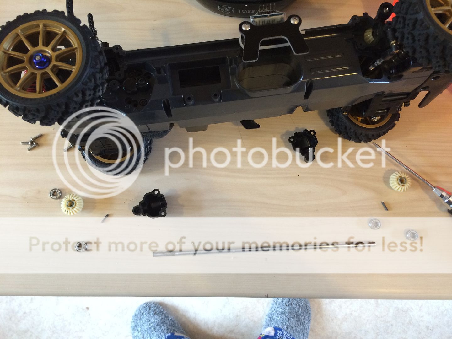

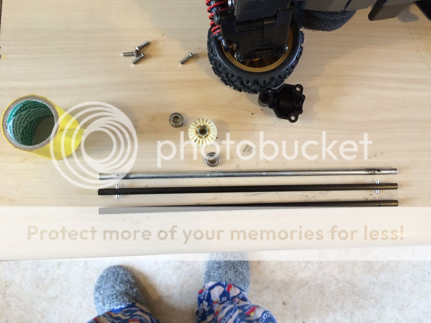

Funny, isn't it, how a model which you set out to use as a basher using cheap parts suddenly becomes a collectors piece with the rarity of items? What I mean is, I built my TL01 with some very nice parts including the illusive lightweight chassis set, unversal driveshafts and lightweight carbon gear shafts, all parts which are now very hard to find! The sole purpose, as the name suggests, was for this to be a rally beater. Now I'm considering converting it to road tyres and an easier life, given the desirable parts installed, because if I break / lose something it's going to be difficult to replace again. I'm also making a carbon prop shaft for it, using carbon rod, as the genuine Tamiya hop-up is now commanding a ridiculous price (if you can find one) for something which is so rudimentary! I estimate it will take me around 10 minutes to make one myself, which will be identical. I should start a business...
And so he said "Let there be a carbon propshaft" and so it was done.
The original steel heavyweight (never going to fail this part...)
Carbon rod, some action with the dremel and a drill later -
Woops, made 2. I don't have access to a pillar drill so unfortunately the holes for the drive pins aren't perpendicular to the shaft. I've test fitted both propshafts and they work as expected however, with the 4 1150 bearings holding everything together and true. It's hardly something you'd pay money for, so I'll send the spare one to a fellow TC'er who I know is also building a TL01 - then it's up to them whether they use it or not!
I'm using my one however - looks smart!
(don't tell the Mrs about what all that black mess is on her kitchen worktop...)
