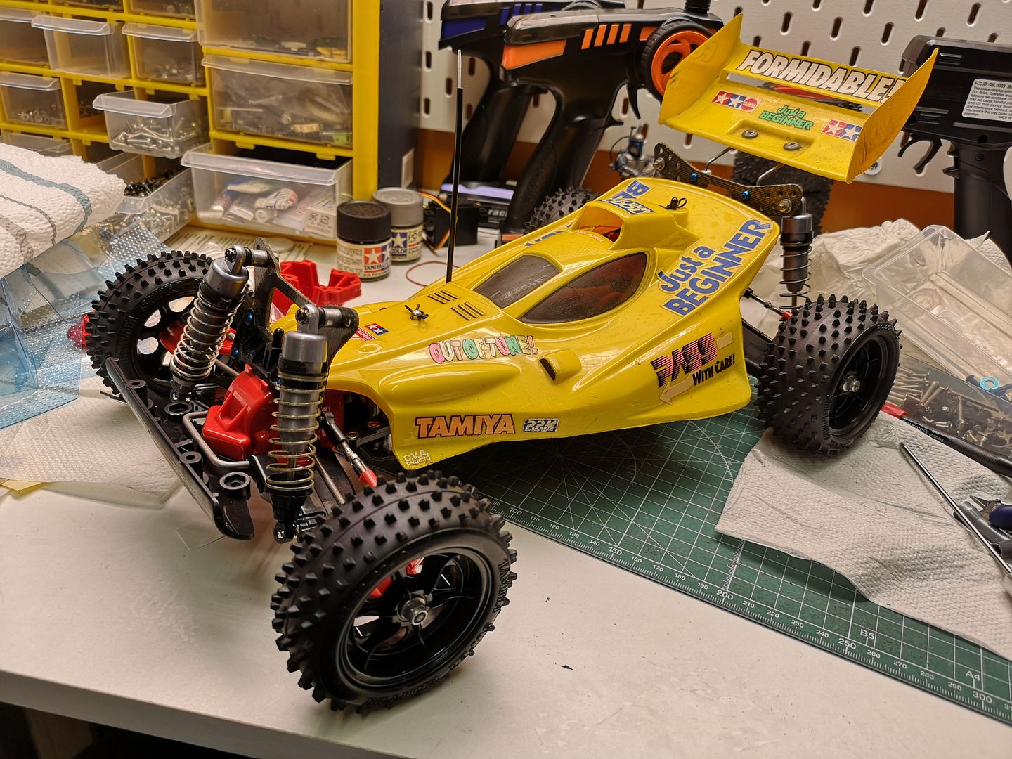

Almost finished with the stickers! So.. I ran out of paint and looking at it now the rear wing is a little translucent, not sure whether to mask up and go again, perhaps with the aluminium layer colour in between, or just leave it bare metal. The aluminium I think looks good as a backing.
Also... I accidentally threw some of the stickers in the bin and had to go fishing when I realised.
Tip for anyone making one of these, I watched the build videos by Matteo and he suggested using a heat gun to get the ‘Avante’ sticker to wrap around the angular bodywork. If you cut out the detail around the A and get the decal in the right place there’s no need for this, they form easily, but thanks Matteo, if you’re out there, watching how to locate the stickers with masking tape first was a good tip and the video’s were useful to give me confidence with things I wasn’t sure of.

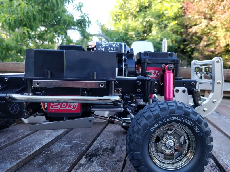

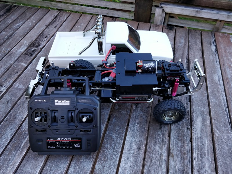

Not just today but over the last week I've 'finished' the electrics in my High-Lift, mocked up the body and taken it for a couple of test runs.
Some immediate observations:

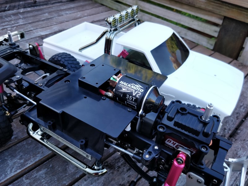

* 35T is way, way too fast, I expected the vehicle to be geared much lower than it is, it's silly fast for a truck and I can't imagine what it would be like with even a 27T silver can! So 55T motor now ordered, hopefully that's more suitable. I'm not looking forward to swapping this in because of lazy design - you can't remove the motor (easily) without disassembling most of the truck and that's just dumb. Could have been fixed if they'd used a simple two piece gearbox cover instead of the current single piece. I mitigated some of the inconvenience by drilling two holes into the top of the cover so you can access the motor screws.
* You do not need a 20kg servo for the gearbox ROFL... duh :rolleyes: And in fact I'd recommend a weak and slow standard Sanwa or Futaba servo because the gearshift mechanism is poorly designed and stresses the servo. I'm going to have to add a servo saver to mine just to protect the gearbox (not the servo). The Tamiya recommended radio doesn't have EPA which compounds the problem (so I'd recommend against the 4YWD - get something with EPA). This would have been a non-issue if Tamiya had designed an adjustable servo mount. And on top of this some poor design choices here make adjusting this servo far more difficult than it should be. Facepalm.
* From a distance the colour of my servos looks the same as the shock bodies so that's a nice bonus.
* I'm unlikely to ever run this through a puddle so installed everything electric out of sight and the result is quite a clean finish.
* I think the leaf springs are too taut using the standard settings so I think I'll remove the top supporting leaf (many people have removed both the upper and lower leaf and then found it's not strong enough).
* I can see this being a bunch of backyard fun - my TRF buggies are just far too fast for casual bashing fun.
