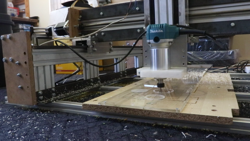

enjoy mate. been down this rabbit hole. scratch built mine... in retrospect should have just bought a kit like you did. then again things weren't as available then as they are now. but yeah its in a perpetual state of improvement. need to upgrade to proper linear rails and maybe a water cooled spindle... etc etc
vlcsnap-2015-11-20-11h28m40s17_zpsjvrfiq
