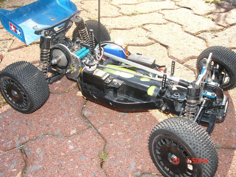

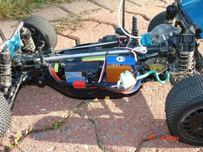

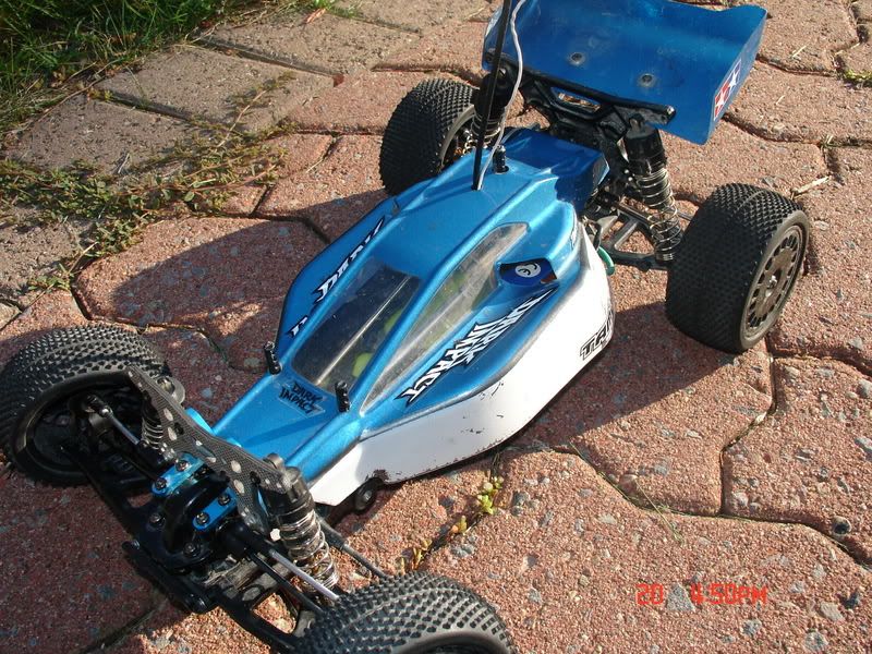

Hey! With all your pics and videos, I figured i'd post mine. Ive had this DI for a while, its on its second set of tires and on its third esc (Moped escs make jesus cry.) The paint is chipping a bit, but I still like the ALT paint job my friend did. Upgrades are a 19turn motor, futaba servo with ball bearing, ball bearings in steering, slipper clutch, heatsink bars, CVDs, graphite front shock tower, graphite front suspension brace, front one way. I think thats all..
Well I'm just here to post some pics of my car, after twist told me to do it or he'd eat me. but unlike the others its no DI but a Rising storm!!!! So here it is with its 1 hundred and 1 hop ups, including an Mtroniks viper dash no-limit esc, speed gem 11t double, All 4 alloy suspension arms, Yeah racing alloy shocks, and towers, steering kit and im passing some.

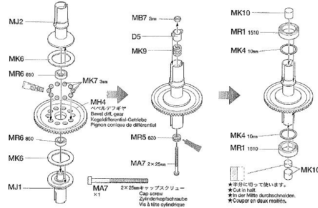

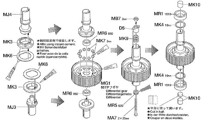

The problem with the stock rear diff, is that the outdrives are plastic. The stock front diff, however, has nice strong metal outdrives. Since both front & rear diffs use interchangeable parts, all you have to do is order the metal one piece out-drives from a front diff (MJ1 & MJ2), and install them in the rear. You still have to use the stock rear diff main-gear to make it work in the car...
Front diff:
Rear diff:
