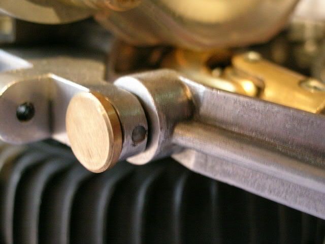

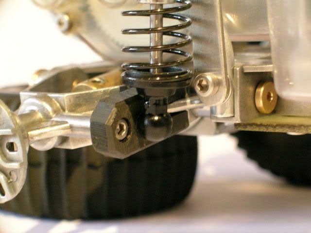

I bolted mine to prevent them bending in a big crash.
I used an M4 bolt & some 6mm OD aluminium tube as a bush with a couple of washers as shims & a nyloc nut to stop it all escaping.
Have a close look at the pics of my Ranger.
I can post some better closeups tonight if you want a better look.
I used an old screwdriver (nice and hard chrome vanadium and perfect diameter 6mm)
Cut down to 18mm lengths
A simple fix but works a treat and you can make loads out of just one old tool ;-)

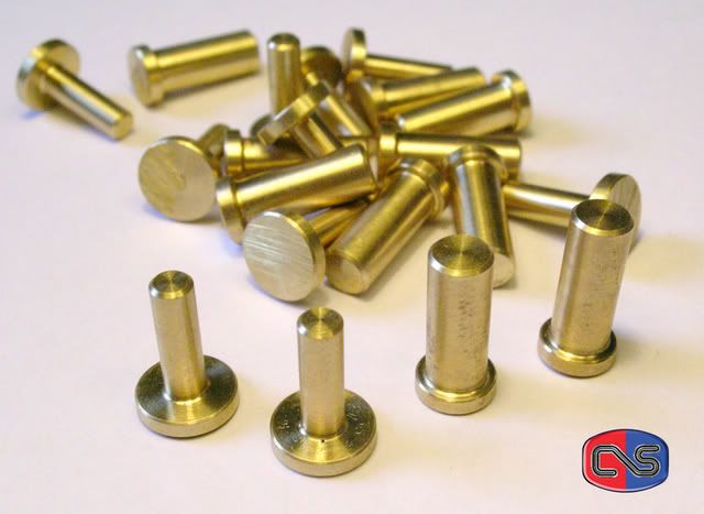

Hi Pete , i use B+Q brass rod , i cut it to length , finish the ends, and its perfect :D
Gotta be careful mixing brass & alloy, they have a tendency to bind together & seize up ;) .
No problems so far - but thanks for the pointer :D ,but if you want to use alu rod Pete ,they sell that too :D
