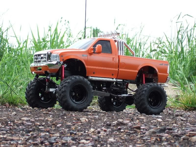

My high lift has thunder tiger 2.2 rims with hpi geolander tires:
The high lift requires a body or axle lift (or both) for 2.2 wheels to clear the shell properly and to look "right" on bigger wheels. My truck is lifted 25 mm higher than stock - 10 mm axle lift and 15 mm body lift - you can see my showroom for info on that.
The Hilux high lift shell is already about 15 mm higher than standard so 2.2's will fit perfect underneath straight away.
There is no need to change the pinion for the larger wheels either so its easy to convert a stock high lift into a proper one :P
