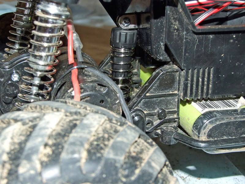

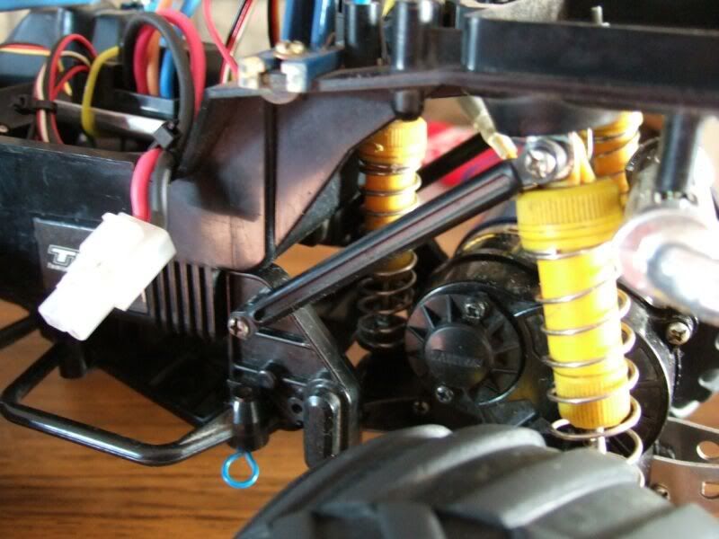

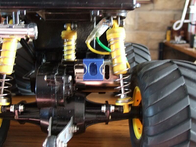

Thanks for the help with the 3rd rear shock mod! Absolutely brilliant, has made the model so much better. Plus can pull very, very long wheelies with a bit of car on the throttle now!
Here's a couple of piccies:
