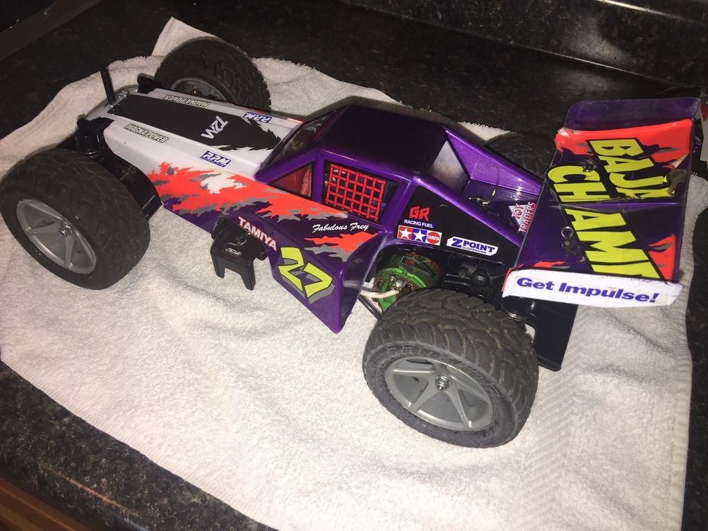

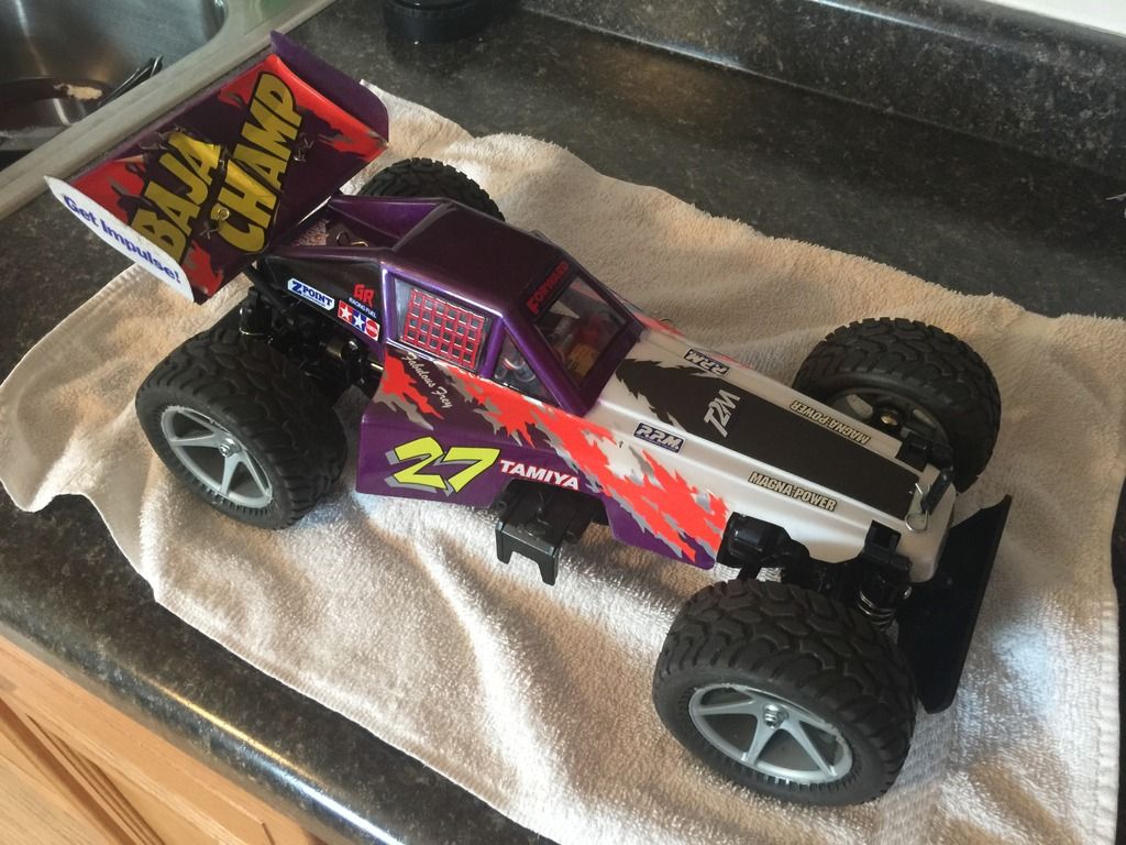

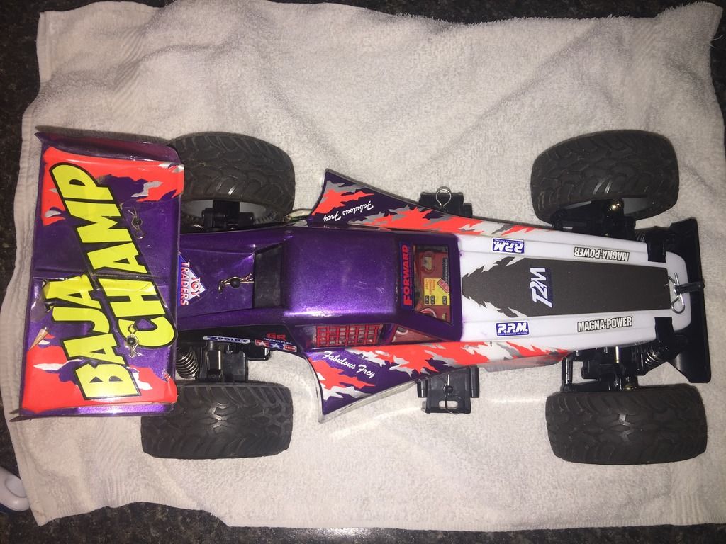

Lets start with this thing. Seller had 2 of these chassis and swapped all of the touring car suspension parts from the other car to this baja champ.  I saw this posted once a while back then it was gone.  When it was reported I noticed the bidding was slow so I took a shot and won.  Interesting this is almost an exact duplicated of something I built back in the day. Difference was than mine started as a touring car and I added the larger wheels, tires and baja champ body.  The approach was different but the end result was almost identical.  Looking forward to running this one.

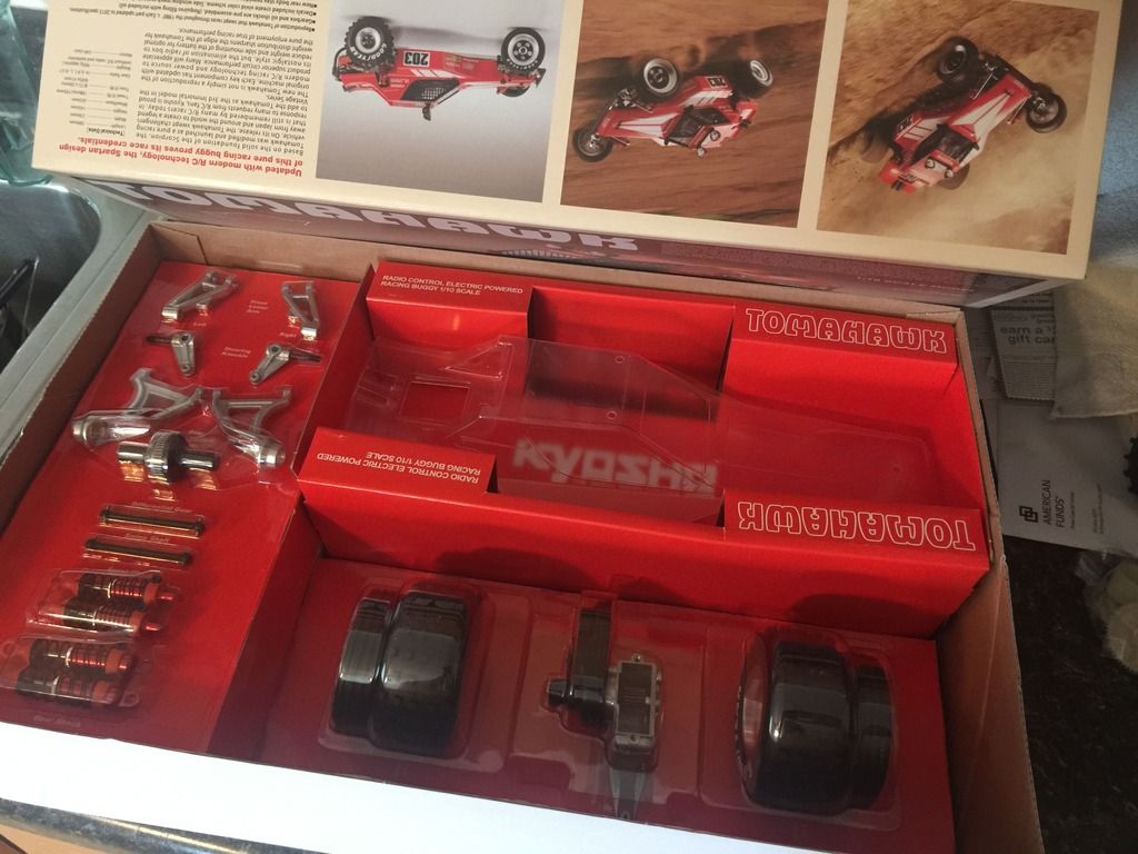

next up was this   I know it's not Tamiya but it's still worthy of mention. Since this one was discontinued I figured I should get at least one more for the future.

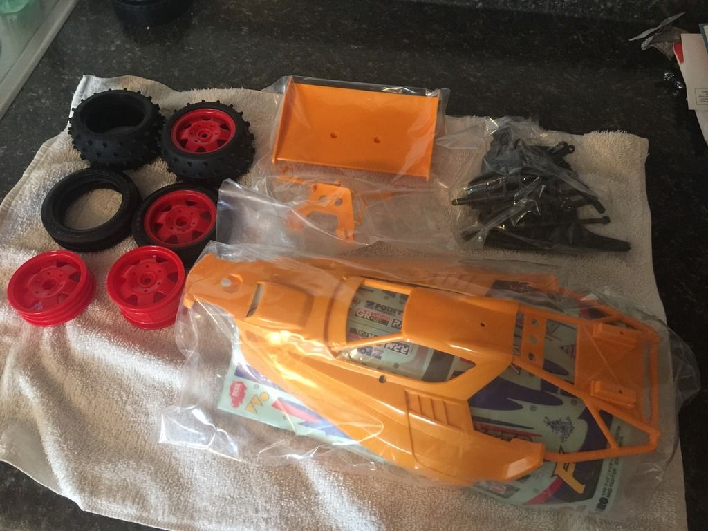

And some parts. Not sure how it happened but I somehow missed out on the mad fighter. In my quest to own all of the hard bodies I somehow missed this one until it was too late.  Lucky for me there was a seller on eBay that was parting out one and I was able to buy everything needed to convert a madbull into a mad fighter. Now I just need another madbull :)

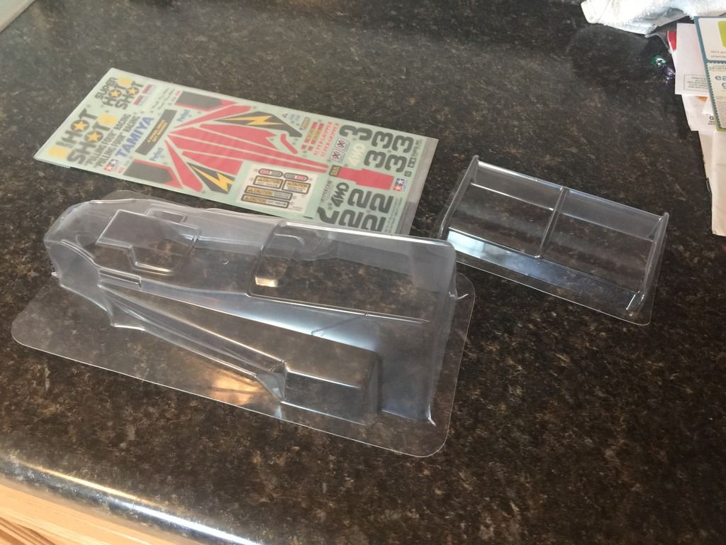

And finally.  Couldn't pass up on a super hotshot re-re body.
