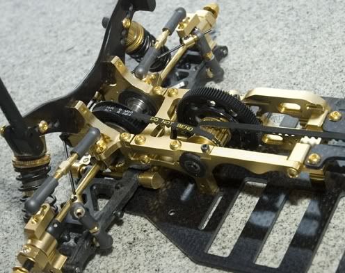

Jason's Green Bits
dammit, searching for that just cost me $20... :D ...found some unobtainium and impulse kicked in
well its not a LIVE AUCTION link, its a buy-it-now... so i guess i'm not breaking any TC rules... ;)
Jason's Green Bits
dammit, searching for that just cost me $20... :) ...found some unobtainium and impulse kicked in
i think i shall be sending my tb conversion kit to the surface finishers to get them green.
i should be charging you money for making me want green bits :D
if you're going through the trouble of replating everything... i'd do them GOLD :)
there's something about Gold & CF black... memories of JPS John Player Specials maybe :)

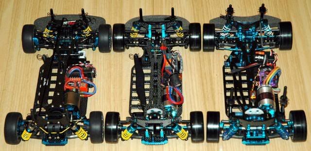

Impressive fleet of evos!
thankyou... them's just the blue trio that were getting worked on week before.

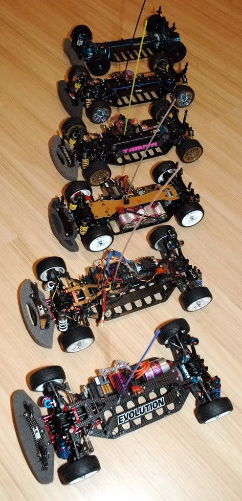

there's a few more red & green ones :) here's an older family portrait
the built ones, they are all regular runners :lol:

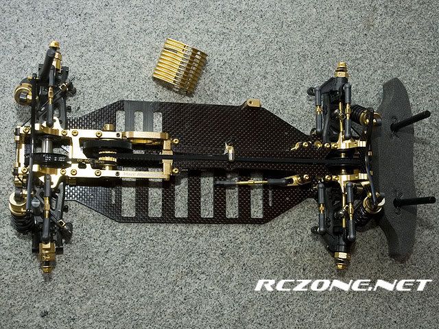

popped a pack into the IV this evening to do some donuts in the loungeroom;
came back sprinkled with silvery flakes. Steering link contacted the new GREEN shaft
(which is already lightweight/skinnier) and gouged a ring 1mm deep.
Here's a scary pic B) ... dug out all the unattached hingepin bars from the toolbox:-
