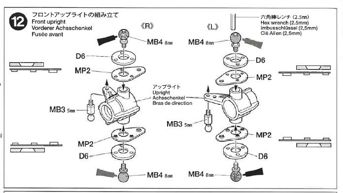

I've noticed the re-re is supplied with two different types of front uprights, and I couldn't understand why. The modified type seem to make the track wider and give more pronounced toe-in with stock rod lengths; also due to the wider track the front driveshafts are quite loose.
After building, I swapped my front uprights for the original parts from the tree and found the driveshafts and steering settings were much better that way.

The new uprights are from the TA01 and they correct the bump steer problem.Use about one degree toe out with these uprights and it should handle corners better.
They also have better Ackermann Effect, improving Mid-Corner Grip, and slightly reducing understeer.
The new uprights are from the TA01 and they correct the bump steer problem...
How do they fix the bump-steer? The Parma bump-steer eliminator kit I'm using (for the original uprights) moves the tie-rod ball connector WAY down to point that the tie rods run directly behind, and parallel to, the lower control arms?
According this step of the re-re manual, the uprights are still reversible like the original (centered lever arm), and still use the same ball-studs as well. I can't see how only moving the connecting hole in-or out with a new upright would help with bump-steer that much...
Anyone shed any light on this..?
The original ones included on the sprue were only used on the Hotshot and Supershot kits. The ones supplied separately were used in all other models in the Hotshot range as they give a much better steering geometry to reduce the huge amounts of understeer. They don't affect the bump steer at all. The separate front uprights are also a better material.
The rerelease Hotshot has longer front driveshafts than the original to go with the wider track of the new front uprights.
