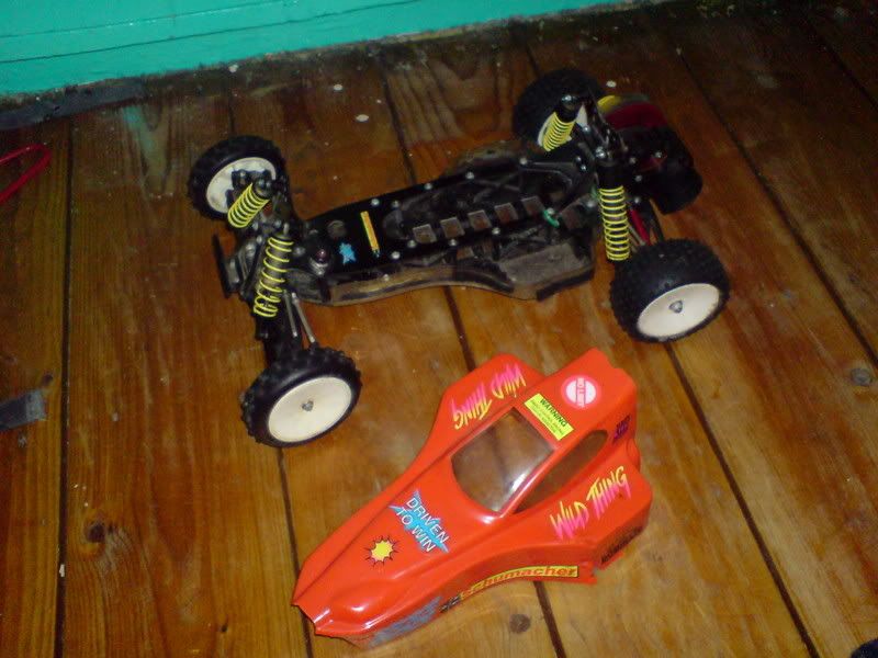

Take one ebay purchase
several screwdrivers a tamiya box wrench and some long nose pliers...
oh and 20 minutes later
seems to be missing several circlips, has a few choice self tapping screws (why do people do that??) clear undertray is completely toast but at least the lower chassis plate has been kept pretty clean, rear motor (bumper) cover is scratched pretty badly so I'll be sourcing one of those. have already got a bearing set so they'll be getting replaced, couldn't find a small enough allen key to remove the driveshafts, so could only split the gearbox enough to have a peek inside and find a minty clean set of gears, rear wishbones have got play on the hub pivot and are also pretty scratched so new ones need to be sourced..
