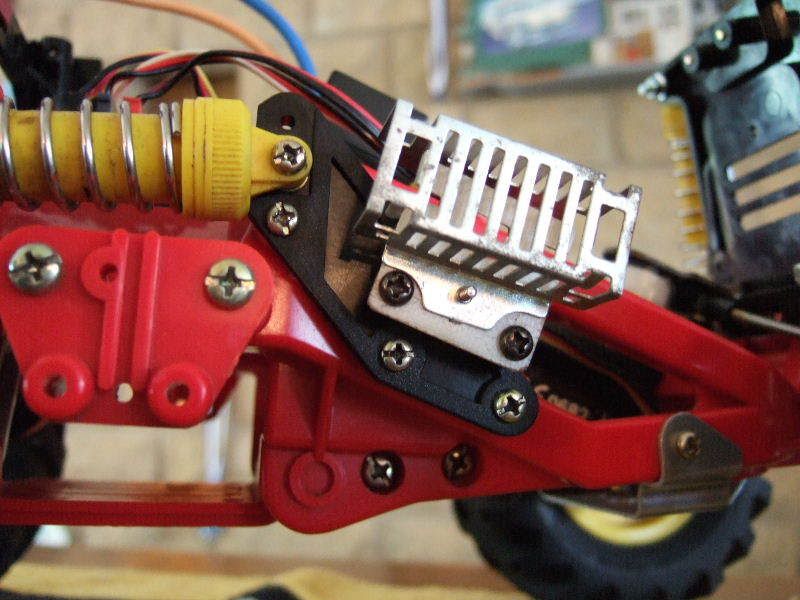

Grab a King/Super Blackfoot B-tree remove the old servo cover and the aluminum MSC mount, and replace them with the H1 and H10 parts for the new B-tree, you'll need a couple of extra 3x8mm screws to hold down the back of the new servo cover to the MSC mount. Doing this acts as a brace for the front shock tower, which tend to break without the extra support. (I'm guess your running a ESC so cut the MSC post of the new B1 part and mount your reciver under the servo cover in place of the MSC)

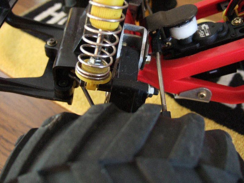

With a ESC you only need one servo, so you can move the steering servo over and mount it on an angle so in centered like the image below, this helps handling alot, do this as part of a steering rod upgrade, just buy some ball ends and thread rod from you local hobby store to replace the stock steering arms. (Get something heavier duty that the stock items, and possible get a new servo saver too).

That the should give you something to get started on, the screw mod and the servo cover swith are most in my book, without them you'll go though dozens of diffs in no time and you risk the front shock tower breaking and it very hard to find new now and often expensive to replace.

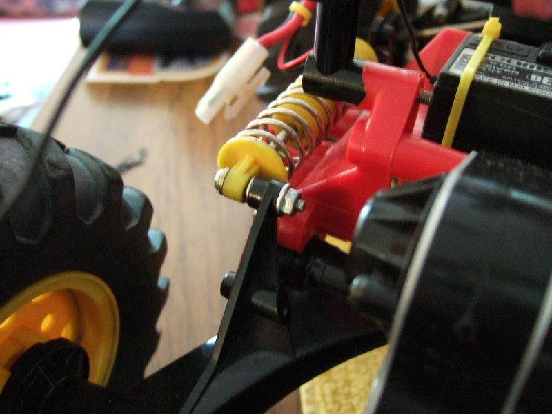

I also attach the shocks to the rear arms using a nut and bolt, rather than a self tapping screw. This makes for a much stronger joint, as a nut and bolt spreads the load better than a screw does.
Give the front suspension the same treatment by drilling the mounting holes out and adding a long bolt (i use the bolts from the inside of grasshopper shock absorbers)
