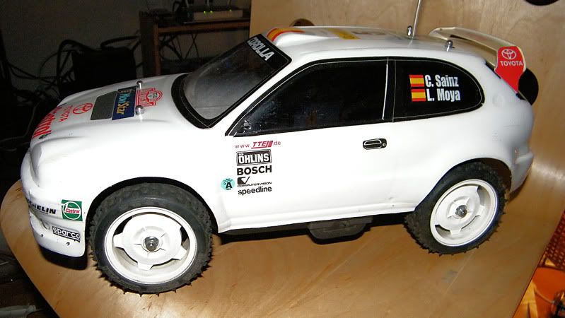

You shouldn't really have much problems with the belts especially if using the Aramid fiber ones with alloy pulleys. When I ran my TA03FS rallycar I didn't encounter any problems with rocks or dirt or even grass in the belts/pulleys. Small tree branches might be a problem though. Also there's no reason why you couldn't use a 12T pinion on a TA03. Believe it or not you don't really need much to turn a TA03 into an offroad vehicle. Anyway here's my TA03 with some buggy wheels/tires. Handled great in FWD and AWD modes.
