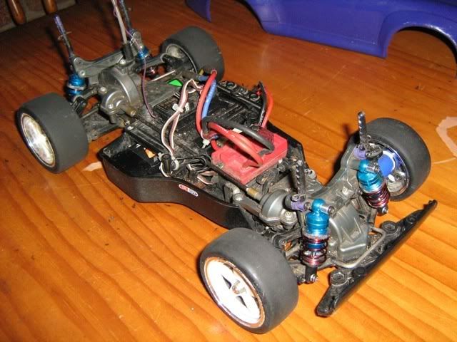

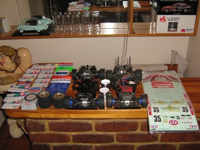

here's a few things i started off with:
my taisan GT2, built in about 1997... not box art obviously, have a new shell on its way (paid too much for it)
here's the taisan chassis with some yeah racing 50mm shocks fitted. brings the ride height down to about 5mm, camber will be corrected with adjustable upper arms. this suspension combo will be transferred to the frp chassis.....

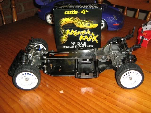

here is the frp chassis, with the mamba :P

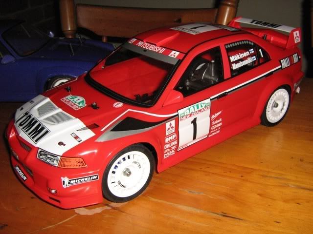

which will run this evo6 shell:
getting a spektrum 2 channel to run the frp/mamba/evo6..
