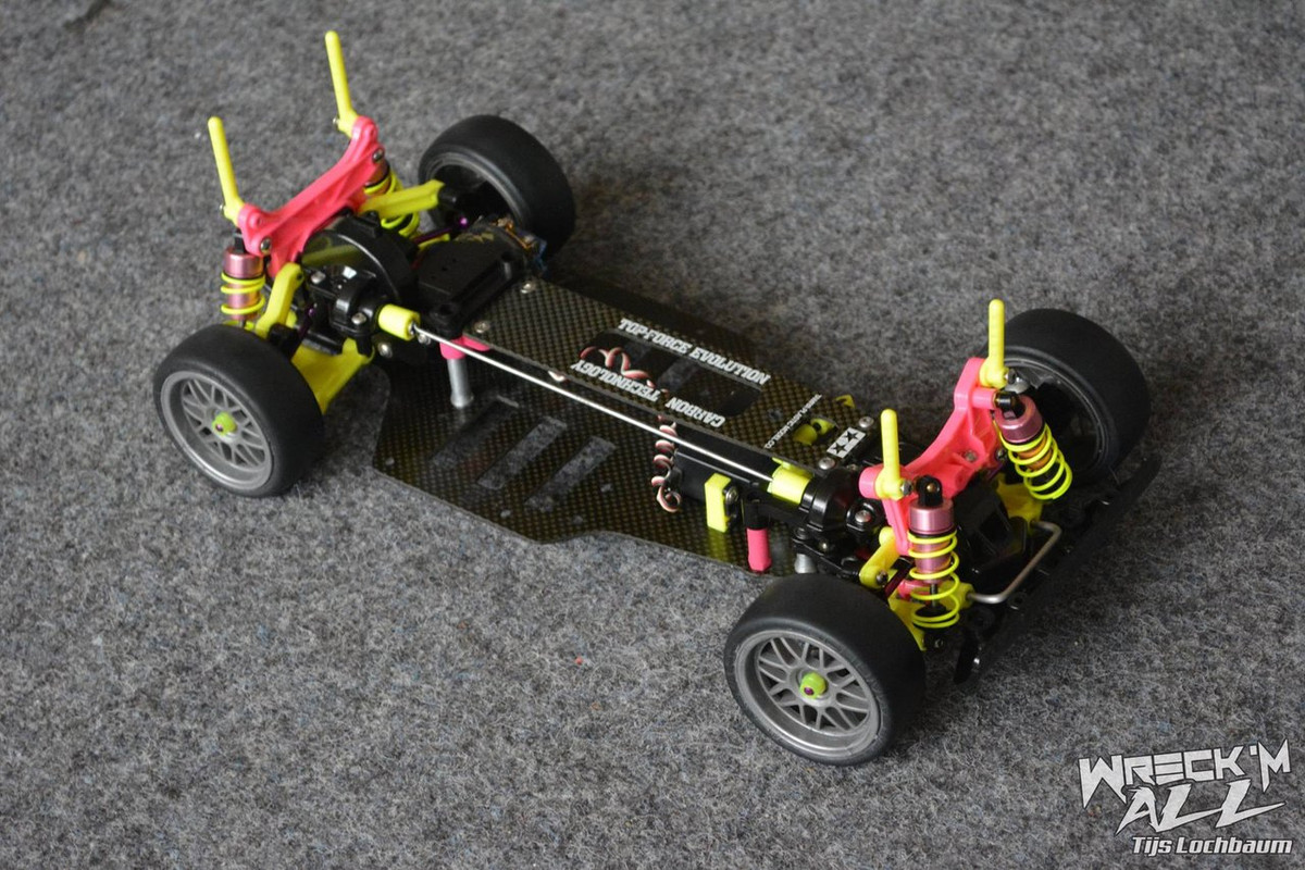

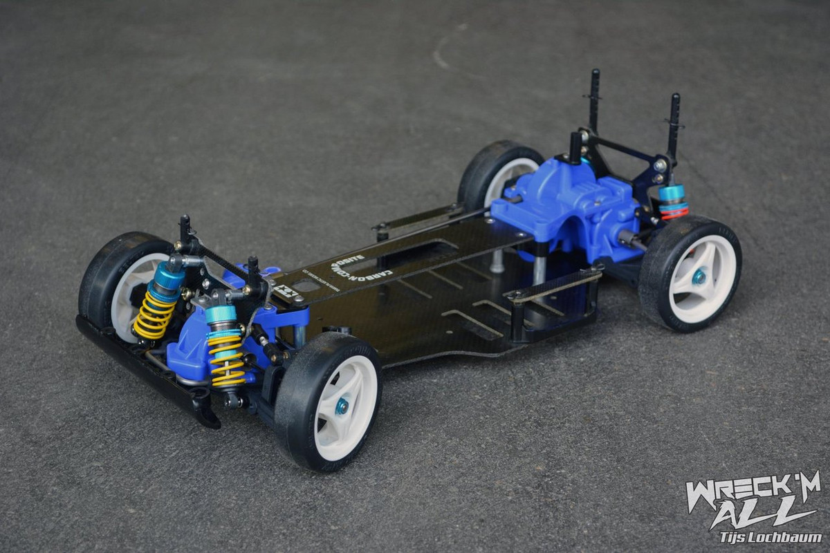

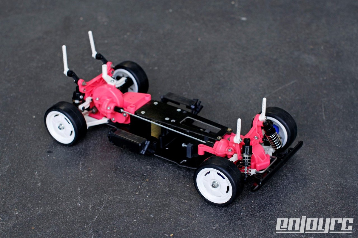

I absolutely love the TA01 and TA02. They are my favorite chassis ever because of the versatility. Here's some (older) pictures of my cool TA01 and TA02's. By now most of them have received some extra upgrades. The blue one is actually one of my runners now with a 17.5t brushless :)

Also, nice collection... what wheels are on the pink and blue TA02's?
On the pink car they are old Kawada wheels, and on the blue car they're GM Racing wheels.

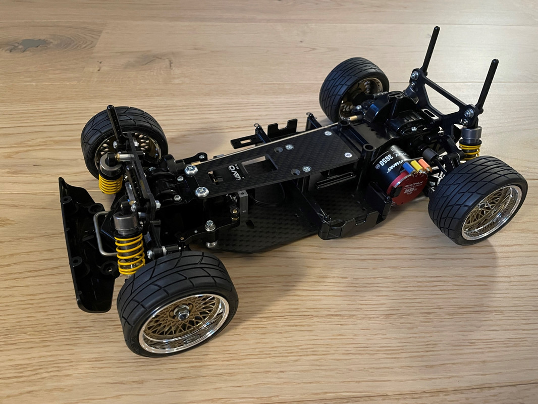

I got a used golden damper set from @Quincy a while ago and took the time today to clean and rebuild them:
Before I had the grey ones with threaded body on this chassis, but will need them for another project. The gold always fits :wub:
...and lets hide them :D :rolleyes:
While shopping other parts online, I stumbled over the TA02 carbon plate topdeck. It will suit my hop-up chassis very well as replacement for the actual topdeck and so I bought one.
In direct comparison you can see the Yeah Racing topdeck has a longer front cut out (the rear hole was added by me) and the surface finish is better. Somehow the clear coat of Tamiyas topdeck is not as smooth. The outline is exactly the same. I think to remember that the original old carbon topdeck had a different outline…
Installed:
It has not the same charm the vintage one has, but still looks nicer than the Yeah Racing product, with its print.

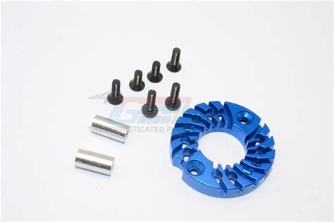

Don‘t use the GPM one in a DF01 (Manta Ray, Top Force,…) at a dirt track.
Through the cooling fins gravel and dust comes easily to the pinion and into the gearbox...not recommended.
Can't say anything to the Tamiya motor mount, but I can't recommend the GPM one. It's not of good quality. The 3Racing one has, in my eyes, the big advantage to be a one piece motor mount. While Tamiya and GPM need 6 screws just to attach the motor to the chassis you only need 4 with the 3racing one.
