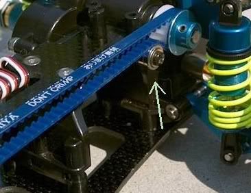

i know there is a small roller that is used, so that the belt clears the motor can (see pic)...so i'm wondering if the roller will still allow the use of two 16 tooth pulleys.
Yeah it will work, but be careful because mine seemed to wear out pretty fast doing that. I am assuming you are running the hop-up belt correct?

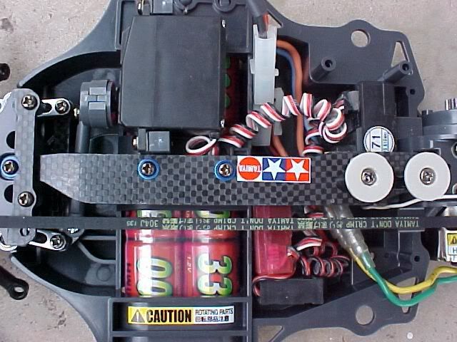

almost done with the TA03R....a few progress pics (might have to turn up tthe brightness on the monitor)....

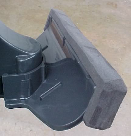

the first addition was a foam bumper to the plastic kit bumper. i got it from these foam boards, that have interlocking edges, sold at hardware stores, that you put down to protect the floor when you're working with construction materials. quite nice here to protect the hardwood floors.
CarKing....you were right about the the belt being really tight when using two 16T pulleys. so i picked up a set of 15T pullets and they result in near perfect belt tension. of course...i might switch to a set of 16T when this belt stretches out a bit.
in addition to this, on one drive, i started to notice very tiny, white cracks or factures, radiating from the base of the upper ball connectors on the sus. mounts, on the TA03FS. no doubt that having only 5mm of threaded shaft in the mount was a bit too little. so i tapped the plastic (more on that later) to make threading a machine screw REALLY easy...added a washer under the screw head, to protect the plastic, and than added a ball nut at the other end.

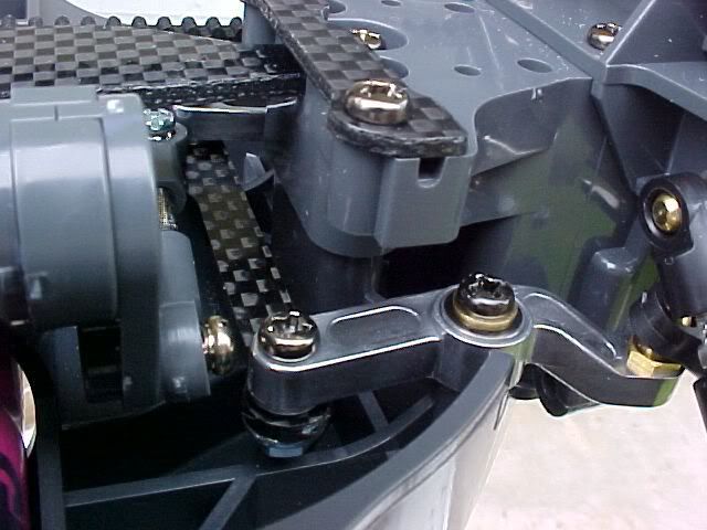

after installing the the alu. steering set, i notice that there was still a bit of play (a rocking type) in the arms. so i flipped the brass bushing, that goes through the bearing races, upside down, so that the flanged portion secured the bearings and seering arms from above. works great. no more slop and the arms now rest a bit lower, which should make it easier to extend the arms as low as possible for max ride height. i also got the carbon steering bar and put a tiny, tiny, bit of blue loctite on the nuts that secure the arms to the bar, since they had worked loose on several occasions.

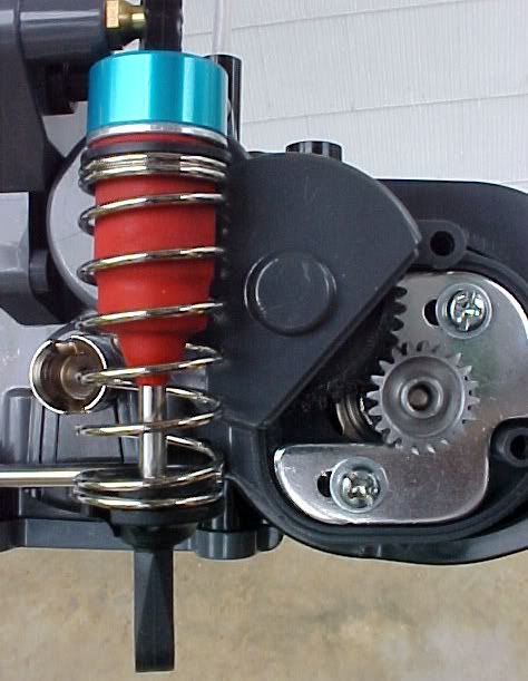

i've also been very pleased with the quiter running Robinson Metric pinions so i kept that and will be adding an alu. pinion cover soon.
also, i seem to have found the perfect spring to use for rally. they are the silver springs from the F-150 and S-10 kits (C Parts #9415197 $13.50 from Tamiya USA). it does come with extra shafts and o-rings and a few other things but they are very useful, so it's worth the price.
anyway, the springs are great because they are 38 mm long. which means, if you extend the travel on a kit for more clearance, you won't have to use a ton of spacers to make up for difference.
i had purchased a set of the rally springs before and they were too short by 10mm. which meant i had to use a lot of spacers. so these silver springs are perfect.
also, they are soft. so if you're going to rally on-road, you don't really need many spacers (depends on the chassis). if you want more height for off-road rally...add in spacers and watch the right height raise up. but the best thing is, even with the ride height raised, the springs are still the same rate, so the suspension is still working to soak up the small and big bumps and you have more travel to work with.
i know some will say that with such soft springs, the chassis will lean when cornering on-road. but i think it gives the car a more scaled look. especially when the wheel extends into surface irgularities at the inside dip on a corner. it looks really cool!
