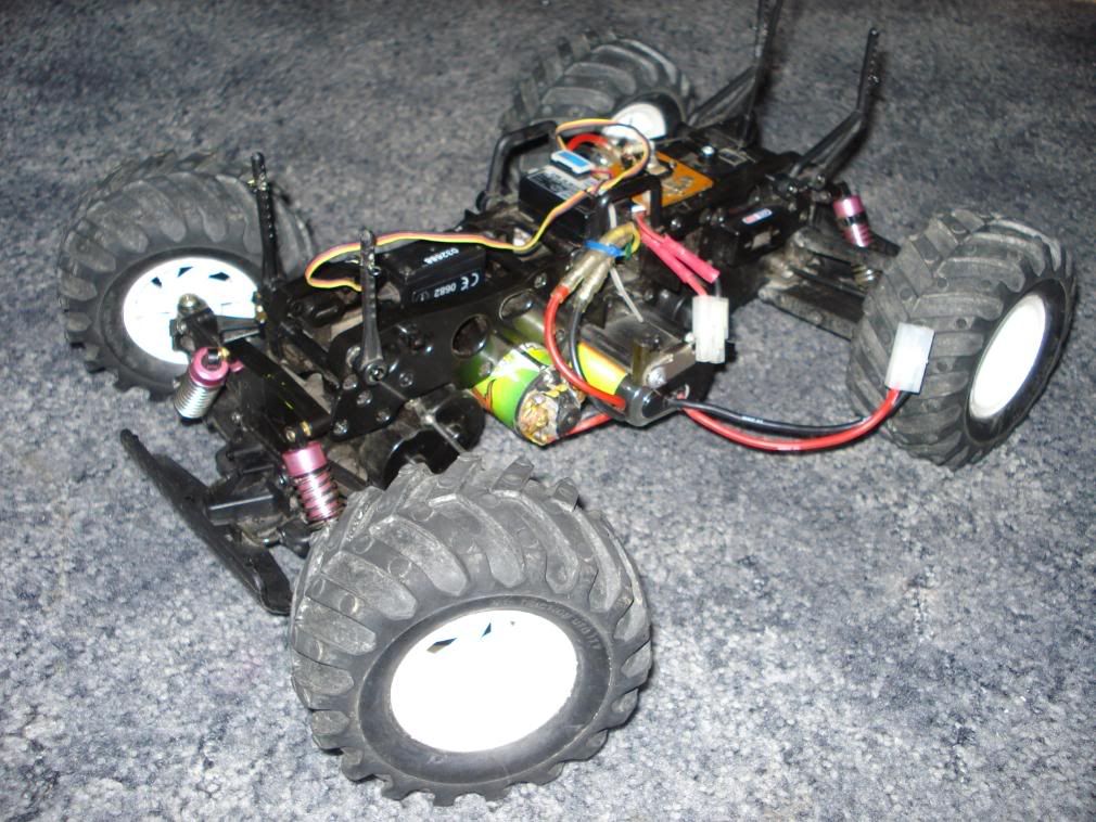

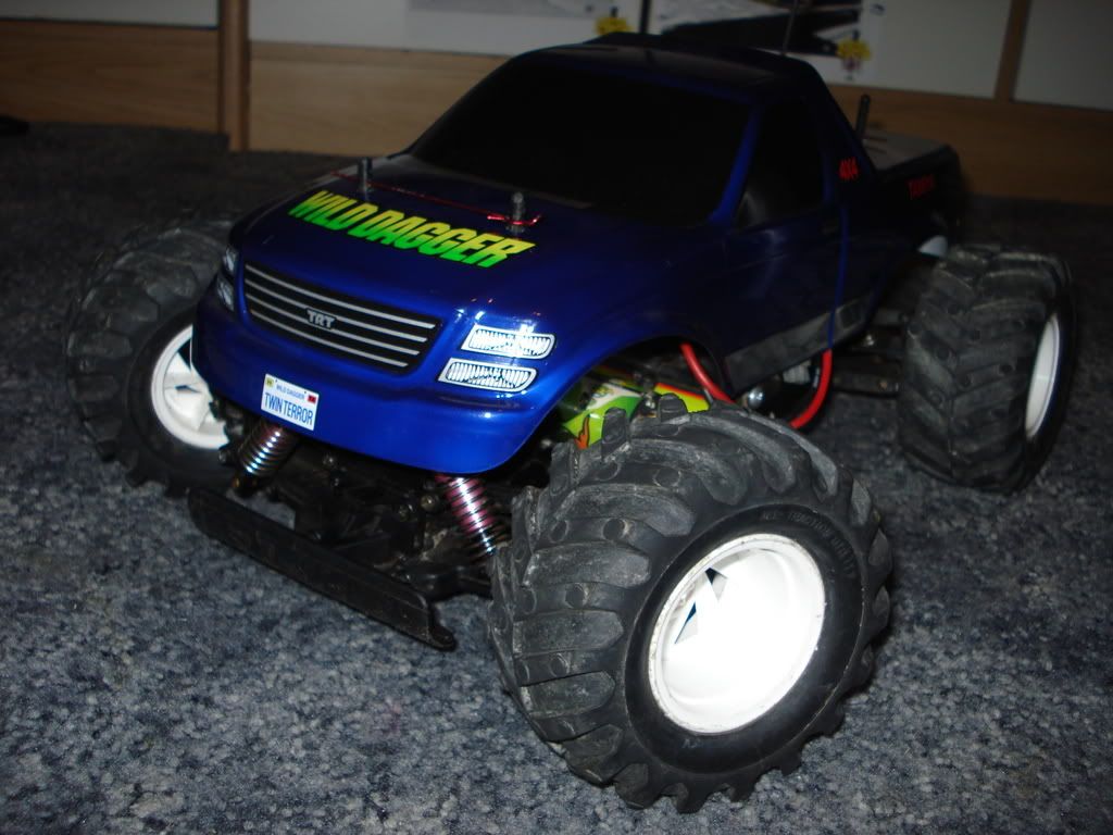

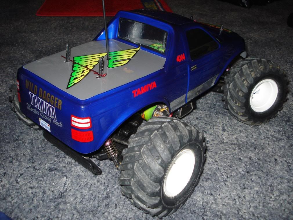

Here are some pics of the car...

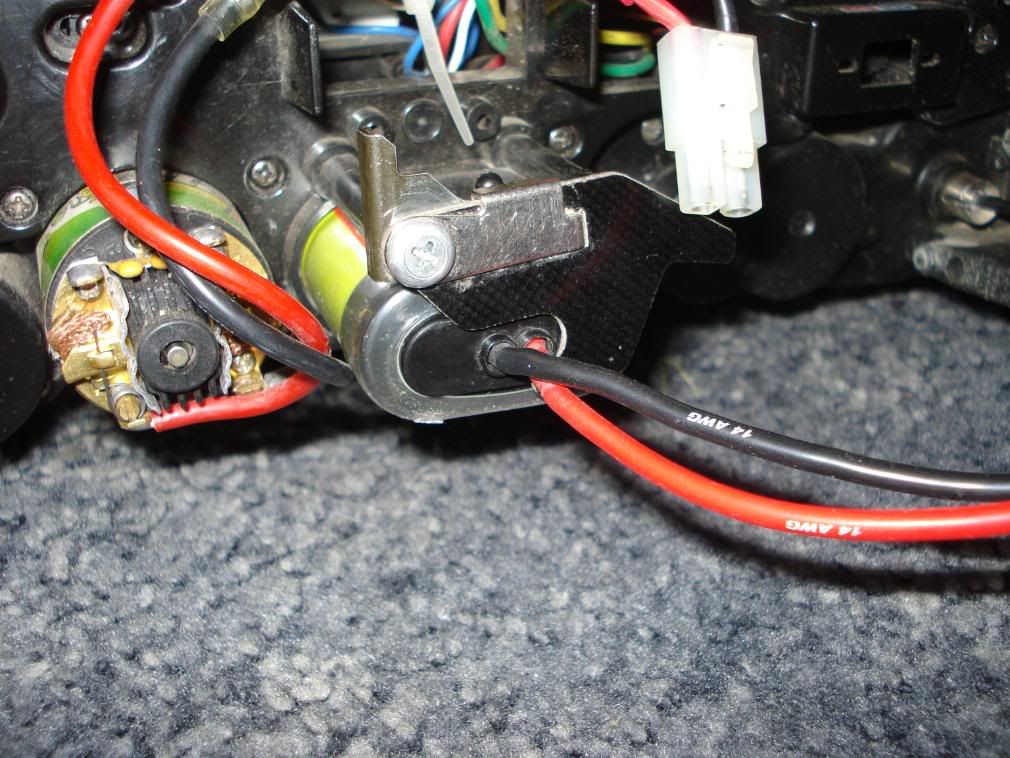

One of the motors:
Electrics and Motors:

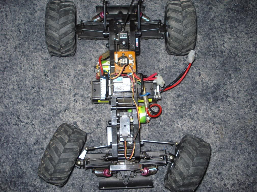

Top view of car:

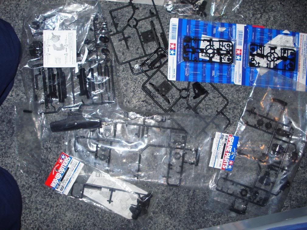

All of the Spares:

Will the front motor need reverse timing, or do those venoms come set at 0 degrees?
You will certainly need an ESC - it's going to be very tricky to drive with the mechanical speed controller, as you'll have to drive it at full speed all the time, or risk the resistor catching fire :o
Looks like a good truck though! :)
The venoms are at 0 degrees from the factory. No tinkering required other than to reverse the positive & negative wires in the front and off you go :) .
