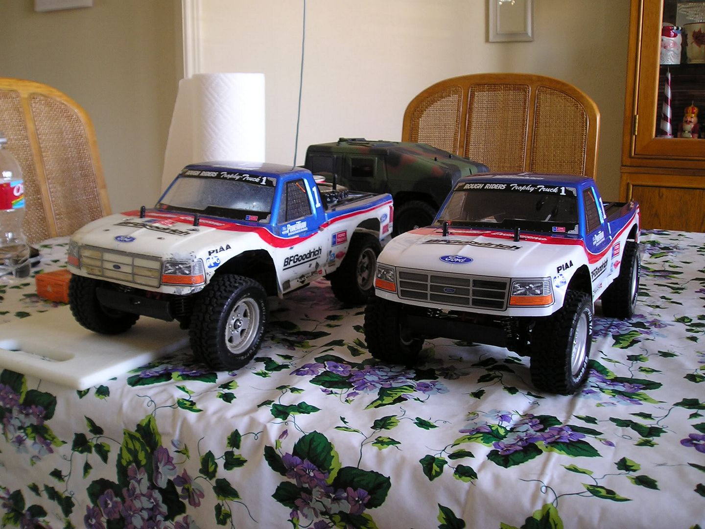

I have both trucks and have had years of driving both and will tell you what you need to know about how they perform. I have 2 f-150 1 s-10 and a hummer and have had many hours testing them head to head.
F-150
More ground clearance
Less weight
Better off-road (will go through taller grass and deeper mud)
Jumps much better
Better for speed
Climb steeper grade
Overall a truck built for moving at a higher rate of speed that can go through rougher terrain climb a steeper cement grade and much steeper off-road, also handle jumps better due to much less weight up top, though it likes tip in sharp turns at a high rate of speed and plastic jointed dog bones can only handle so much power.
Hummer
Slight handling advantage
Lower center of gravity
Longer wheel base
Wider track
Less prone to roll over
All metal dog bones
Overall the hummer was lower longer and wider which meant better handling in some cases and has much stronger dog bones to handle more power. Heavy body means roll overs under quick turns and lower ground clearance as well as longer wheel base and wider track with more weight takes away from its off-road capabilities.
