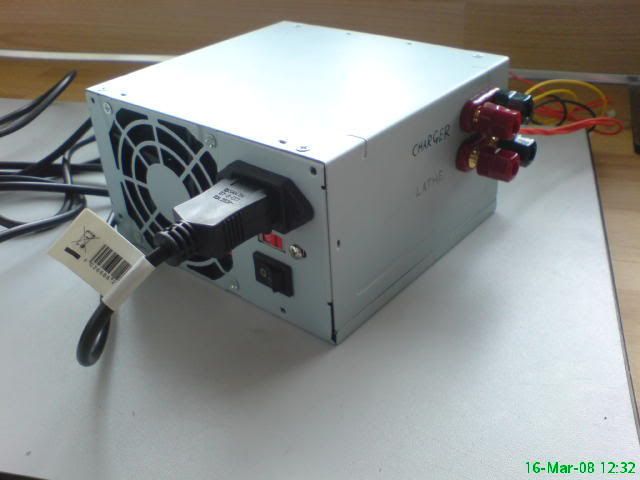

I've just made one as my old power supply wasn't up to the job of charging my new Lipo, seems to work fine and only cost 15.
Thought the pro peak supplies were more expensive, if i knew they were only 30 i'd probably have gone for one of those. Although I've now got a nice 5v supply to power my comm lathe from the ATX PSU which you dont get with the pro peak supply.
Here's a pic of mine anyhow.
