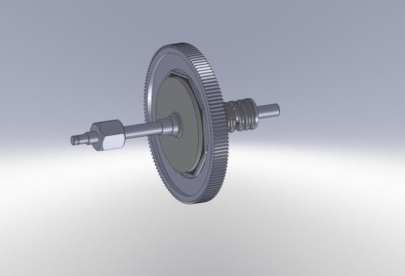

...what cannot be seen it that the inner gearbox metal hub (the hex shape part) does not have the little teeth in it per the original tamiya. Instead it has a slot to seat a small cross pin, and there is a hole in the gear shaft to slide the pin through....
Okay I see. The hex shaped piece is a separate part from the main shaft. This is similar to how the old Losi JRX-Pro gearbox was. The main gear was fixed to the shaft with a cross pin and a couple e-rings...
Here's the Nimrod picutre again for everyone's reference:
Yes, that's the one. I'd like to keep the standard teeth/serated join but it is just too expensive to make to be viable, hence the switch. If titanium was not being used and we stuck with the standard shaft then it's a straight forward machining of the existing shaft. But the std shaft is so big and heavy. When compared with a modern buggy it's a shock!
