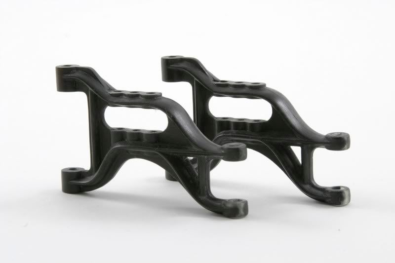

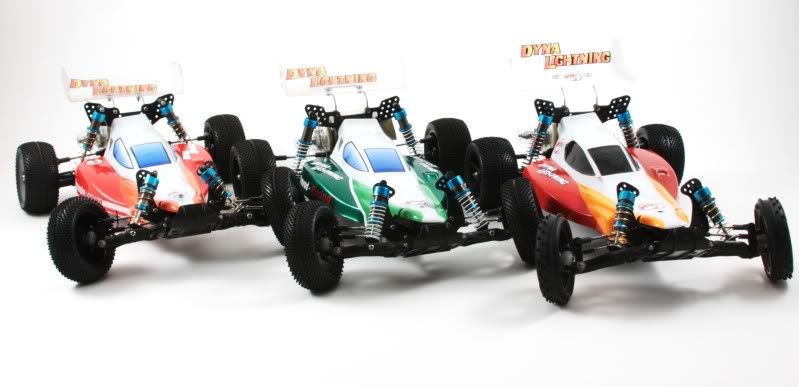

Singapore_959 18 Posted May 27, 2009 some new parts photos http://www.nimrod-racing.net/gallery.php Descriptions and prices will come up shortly I believe. I am coming to the UK shortly so I will bring a Dyna Lightning with me, I hope to meet up with some of us TC'ers at a track? That's a good idea. Are there any tires that will fit the kits narrow front wheels? I've been searching for pin-spike tires like the ones on the Super Hornet with no luck. This tires are becoming hard to find. hmm, not sure, as I used the std tires when I used the narrow on carpet (quickly ditched for the wide) and the std tires I found OK off road. But perhaps schumacher or proline have something suitble. I will have a search. Share this post Link to post Share on other sites
redzone 212 Posted May 27, 2009 awesome, really need those front uprights and a bodyshell too. hey seeing as how nimrod do unusual bodyshells (and very scale in appearance too), do you think they would be interested in producing a 1989 "widebody" Mitsubishi Starion shell? had a guy on here interested in doing it but that seems to have fallen through. there are about 100 shells sold straight away going by the thread i posted on starquestclub.com.. who is best to talk to at nimrod about this? i can get access to 3D modelling scans.. Share this post Link to post Share on other sites

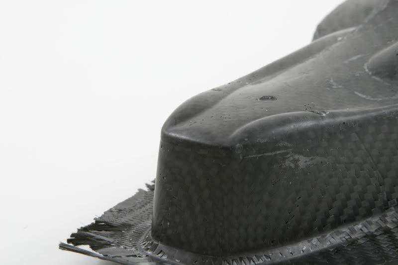

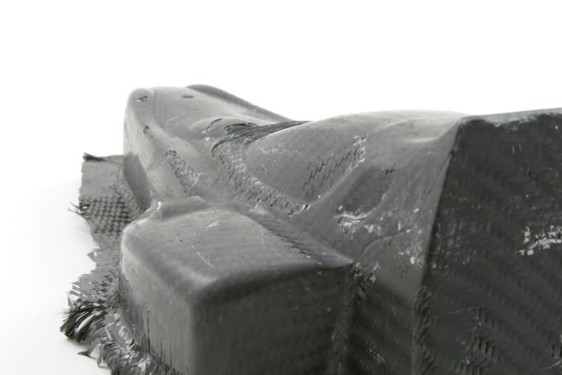

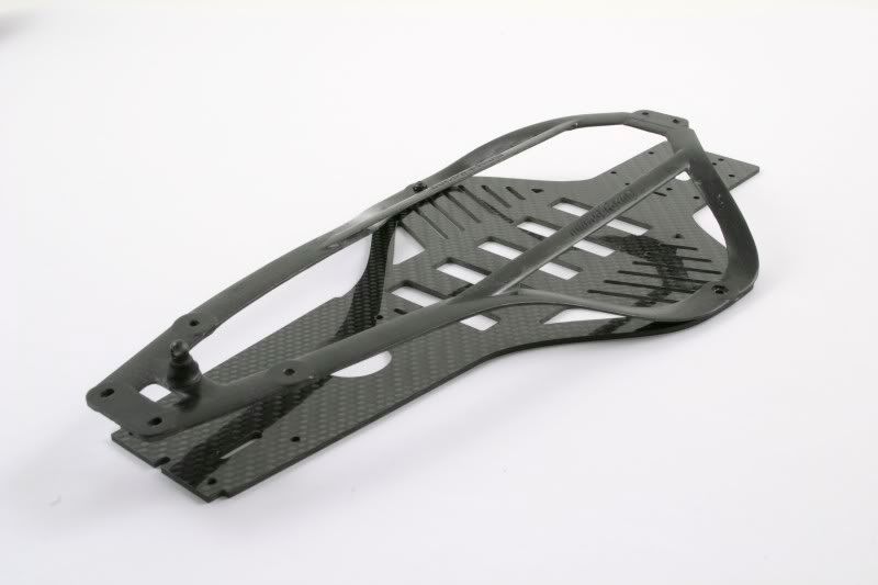

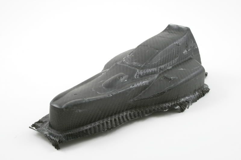

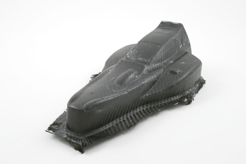

actualday 7 Posted June 5, 2009 Wow, what a project!! Well done Singapore 959, how much do you sell the aerodeck 'spaceship' chassis for?? Thats absolutely the best thing I have seen in ages. Top banana out of interst which company did you use for the prototyping and the CAD CAM stuff? Share this post Link to post Share on other sites

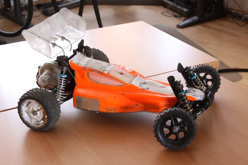

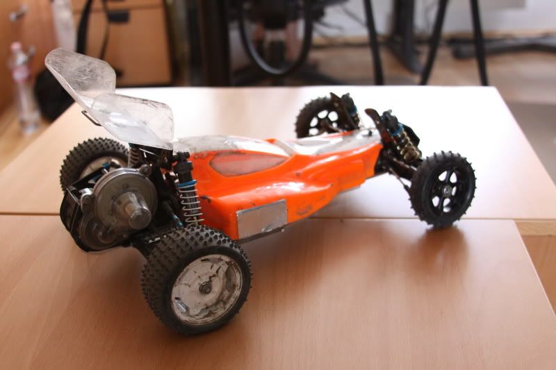

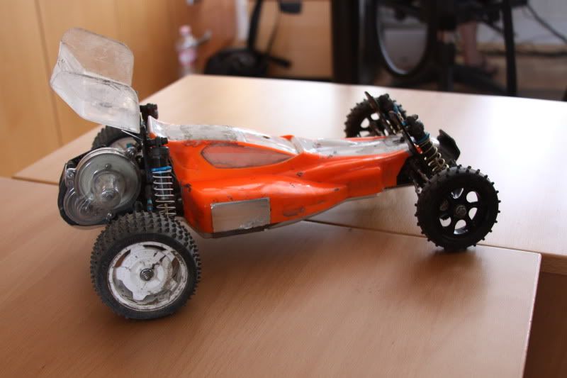

Origineelreclamebord 45 Posted June 9, 2009 Guys, I have very sad news... This is what happens when you read this topic too much: I am really so pleased I finally finished the build of this :D I got this Dyna Storm Re-Release recently from TC member Muratti - I couldn't wait to built it but I had to resist that because I didn't have enough space for it at that moment. Two weeks ago I snapped and I was commanded by the box to build a Dyna Storm of it's contents... The build had been on hold for those two weeks until the sealed ball bearings from Abec35.com (WalaWalaStore) arrived today, and now it's (apart from work on the shell and putting electrics in) finished! So what Nimrod parts will this car get? At least a repro wing for running, an underguard to protect the nice floor of the car, and the blade wheels probably will follow later, too. Anyone got ideas for the shell? Box art or custom (and if custom, what paint scheme)? Thanks Singapore for making me buy this, it has to be my most advanced car yet (and my first 2WD buggy Apart from my DF03 2WD project, that is - but that's going to be a custom car). Share this post Link to post Share on other sites
Singapore_959 18 Posted June 10, 2009 Origineelreclamebord, that is Niiiiiiiiice! Well done!!! NICE photos. I hope you enjoyed the build. It looks good doesn't it! :) I like how the rear std tires look new, lovely But, gosh how can you resist not to drive it?! I failed totally at that, I had to drive mine two hours after I finished building it!! (That's why I miss seeing the nice pointy rear tires!) Painting - now you have to spend many hours trawling TC for ideas!! The underguard and D parts are so far the most popular item from Nimrod. But you don't need the d parts! Wooohoooo!!!!! 1 more DS is going hit tracks soon!!! Share this post Link to post Share on other sites

Origineelreclamebord 45 Posted June 10, 2009 Origineelreclamebord, that is Niiiiiiiiice! Well done!!!NICE photos. I hope you enjoyed the build. It looks good doesn't it! I like how the rear std tires look new, lovely But, gosh how can you resist not to drive it?! I failed totally at that, I had to drive mine two hours after I finished building it!! (That's why I miss seeing the nice pointy rear tires!) Painting - now you have to spend many hours trawling TC for ideas!! The underguard and D parts are so far the most popular item from Nimrod. But you don't need the d parts! Wooohoooo!!!!! 1 more DS is going hit tracks soon!!! Thanks The main reason I didn't test it immediately is that I've got no electrics to put in it yet For that, I will wait another couple of weeks to raise funds for that - It will get a better servo, a decent radio, a decent ESC, a motor that has bearings and is somewhat slower than a 14T and a steel pinion Share this post Link to post Share on other sites

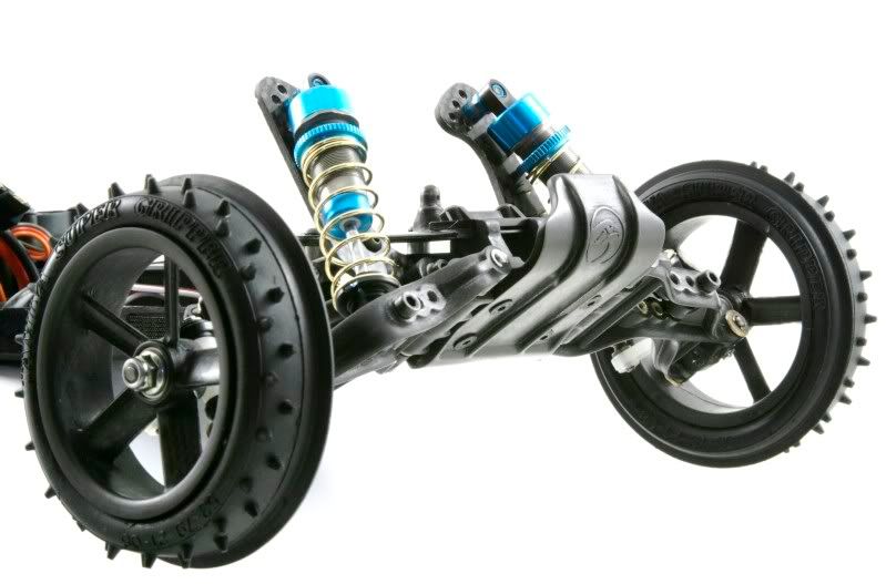

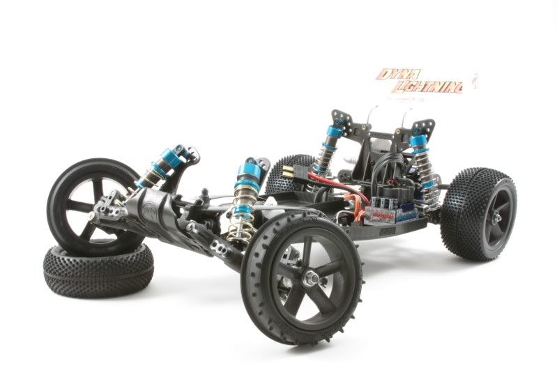

Live Steam Mad 16 Posted July 5, 2009 I've been trying out some of these new parts whilst racing my Dynastorm. The first thing I want to say is that they are really good quality. The New front DL D parts are good. They help stiffen the front of the car more, one of the big issues with teh dynastorm is that it isnt stiff enough to tune accurately. This part really helps sort this issue out. The rear D parts are a godsend, as you dont have to re-tighten the screws after every race. The Bumper is also good as it just gives you a bit more access to front of the car. Still one of the big areas that the car needs to improve is the front bite. If you run proper tyres on the car the car is an oversteering monster. I've started to fit a front roll bar, which should hopefully address this issue (this car needs roll bars). I should be racing it again this weekend, and mid week so far so good. Sounds like the parts are excellent. I don't like the sound of that oversteer though. Do you mean it oversteers badly when using Schumacher Yellow compound Mini Spikes or Mini Pins ? As they are very popular tyres that I would be using. If so, something really needs to be done to address this. I once owned a Cougar 2 which was a huge dissappointment because of the huge understeer, not oversteer, but I was racing on Tarmac and back then I didn't know you needed foams! Admittedly the quality of the car was excellent, but it was no use to me unless it handled competetively. Pity I didn't know any better back then when I was 15! My Top Force was quite prone to oversteer on the Southport track with the stock kit setup, I noticed. Would like to hear how your car handles with that front roll bar and if it cures the oversteer. I need excellent handling on a typical European Off Road track (Astroturf / mixed surface). Cheers, Alistair G. Share this post Link to post Share on other sites
Origineelreclamebord 45 Posted July 6, 2009 Now I am more than sure I am going to get me those Blade wheels (and the narrow ones for the front)! Looks really, really amazing! Share this post Link to post Share on other sites

Singapore_959 18 Posted July 6, 2009 Sounds like the parts are excellent. I don't like the sound of that oversteer though. Do you mean it oversteers badly when using Schumacher Yellow compound Mini Spikes or Mini Pins ? As they are very popular tyres that I would be using. If so, something really needs to be done to address this. I once owned a Cougar 2 which was a huge dissappointment because of the huge understeer, not oversteer, but I was racing on Tarmac and back then I didn't know you needed foams! Admittedly the quality of the car was excellent, but it was no use to me unless it handled competetively. Pity I didn't know any better back then when I was 15! My Top Force was quite prone to oversteer on the Southport track with the stock kit setup, I noticed. Would like to hear how your car handles with that front roll bar and if it cures the oversteer. I need excellent handling on a typical European Off Road track (Astroturf / mixed surface). Cheers, Alistair G. Alistair, Oversteer and understeer can be dialed into any car depending on how you set it up. The stock DS set up is prone to oversteer due to the tires and ride height mostly. I use schumacher yellows on carpet sometimes and it improves grip massively. Some people have found a front roll bar usefull, others not (myself included). 'Excellent handling' can be set up within the limits of the basic design - the DS is too heavy and the front tires are poor as stock. Wider fronts and the parts in this thread are both improvements on the basic DS design. The rest of your own cars under/oversteer characteristics are up to your shocks & ride height set up, and your fingers I enjoy oversteer in my car, for example, and it is usually set up so. That can make it tremendous fun on tarmac and mixed surfaces, but on a dirt track for example that set up makes it terrible. So I change it accordlingly. Still looser at the rear tho! ;-P HTH Share this post Link to post Share on other sites
Origineelreclamebord 45 Posted July 7, 2009 Alistair,Oversteer and understeer can be dialed into any car depending on how you set it up. The stock DS set up is prone to oversteer due to the tires and ride height mostly. I use schumacher yellows on carpet sometimes and it improves grip massively. Some people have found a front roll bar usefull, others not (myself included). 'Excellent handling' can be set up within the limits of the basic design - the DS is too heavy and the front tires are poor as stock. Wider fronts and the parts in this thread are both improvements on the basic DS design. The rest of your own cars under/oversteer characteristics are up to your shocks & ride height set up, and your fingers I enjoy oversteer in my car, for example, and it is usually set up so. That can make it tremendous fun on tarmac and mixed surfaces, but on a dirt track for example that set up makes it terrible. So I change it accordlingly. Still looser at the rear tho! ;-P HTH So how about the suspension setup? It seems to me that not only the tires and ight height would make it prone to oversteer. Ok, I haven't driven it yet so I don't know how big the problem is, but those front shocks are massively soft in suspension setup. I know, most of the weight is on the rear, but really it should help if you make it stiffer on the front? (the shocks themselves and maybe even in combination with a front stabilizer). Share this post Link to post Share on other sites
joe999 10 Posted July 7, 2009 either i have the chance to buy this chassis and the upper deck asap or i have to locate an addiction service instead Can you tell me please when the parts will be available? Share this post Link to post Share on other sites
Singapore_959 18 Posted July 7, 2009 Hi joe999! this chassis is currently undergoing testing. Once testing is completed and any required changes have been made it will be announced here first! and I know that you will receive an email from nirmod-Racing about it too I'll do my best to make sure the testing is done as fast as possible (more driving!) The guys at nimrod send their regards! either i have the chance to buy this chassis and the upper deck asap or i have to locate an addiction service instead Can you tell me please when the parts will be available? Origineelreclamebord, set up depends entirely on you. Yes stiffer up front can help, I prefer to adjust using different holes in the dampers than springs. A roll bar on the front may be something that suits you, but as mentioned I did not find it worth having. Joe999 has had one on his car as I recall tho, perhaps he can give you some comments. Some photos from a test car in very mixed set up!. You can see the race wing, wide rear, lexan gbox cover and a few other things. 501x shocks, DF02 and 501x springs. Share this post Link to post Share on other sites
